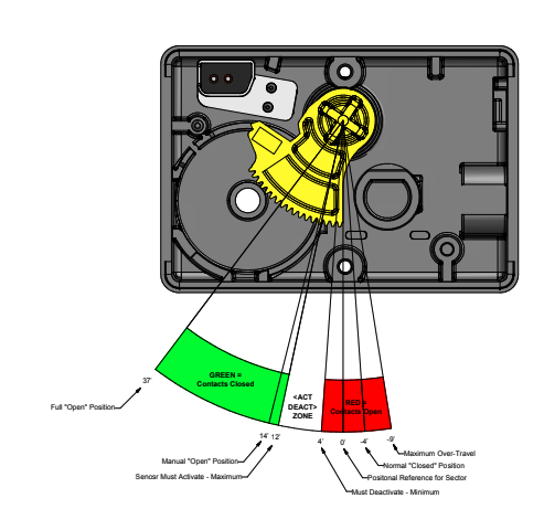

    Are those Honeywell zone valves, the 8043?
    Usually ZV hammer is caused by a fast closing valve against a high velocity flow, flow above 4 FPS, perhaps. It's more about the speed, not the volume of the fluid.
    However if the ∆P circ is on the correct setting it should easily address the velocity? What circ do you have and what is the gpm or W. when the valve makes the noise?
    One common hack for the HW is to remove one of the two springs from the brass sector gear. This slows the close speed by 2 seconds, and that fixes many of the hammer issues.
    It does change the close off pressure of the valve by a couple PSI also. So make sure that zone isn't bleeding through when it is off and other zones are flowing.

    They are 8043s. A mech friend told me to try the caleffi ZVs as they are motorized and slightly slower… but the problem still persists. I have removed a spring on the 8043s and it also helps, but hammer is still noticeable.
    Grundfos ALPHA 15-58 for the system set to Constant Pressure. With 1 or 2 zones open its 3-4 GPM and 16-18ish wats. Min is set to 2.2 gpm to satisfy the boiler.

    hot_rod Posts: 28,558
    I recently helped a retired plumber near me with a ZV hammer issue. He tried several of spring return valves and they all hammered. Single speed 15-42 on a 4 zone fin tube home.25 year old Eries were replaced, he has been changing end switches over the years, they are no longer available.
    Identical problem of 1 zone only operating, it caused the hammer, when it closed.
    I went back with this valve and it solved the problem. Slow opening, slow closing. It takes maybe 45 seconds to close completely, but the end switch opens quickly to stop the circ.
    I don’t have an answer as to why a delta P doesn’t solve it.
    A pressure bypass valve may, but I don’t think a delta P circ and PAB would work together. in fixed speed function it would.
    I feel confident the thermal ZV do the trick, for problem hammer issues.
    The Caleffi are very low current draw, so 6 or more on a 40vA transformer or relay box

    I don't know of any spring return ZV that breaks the end switch instantly. Either a cam has to move off the micro switch, or the magnet away from the reed switch in the Caleffi. But no more that a few seconds for that to happen, during maybe a 7 second to complete close off.
    I know PABs work, but I'll see if they work with ∆P circs. As a zone valve closes, the PAB bypass opens, so the circ may think another zone is opening and speed up, not slow down??
