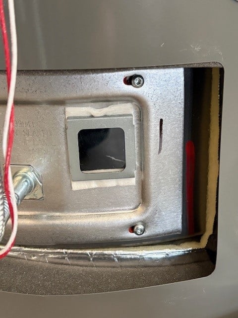

    What’s also odd is that there’s a red line from a marker right next to the pilot burner window (see attached photo). I wonder if something was flagged upon inspection and it was never fixed.
    pic.jpg 75.9K
    the line is usually made when they check something.

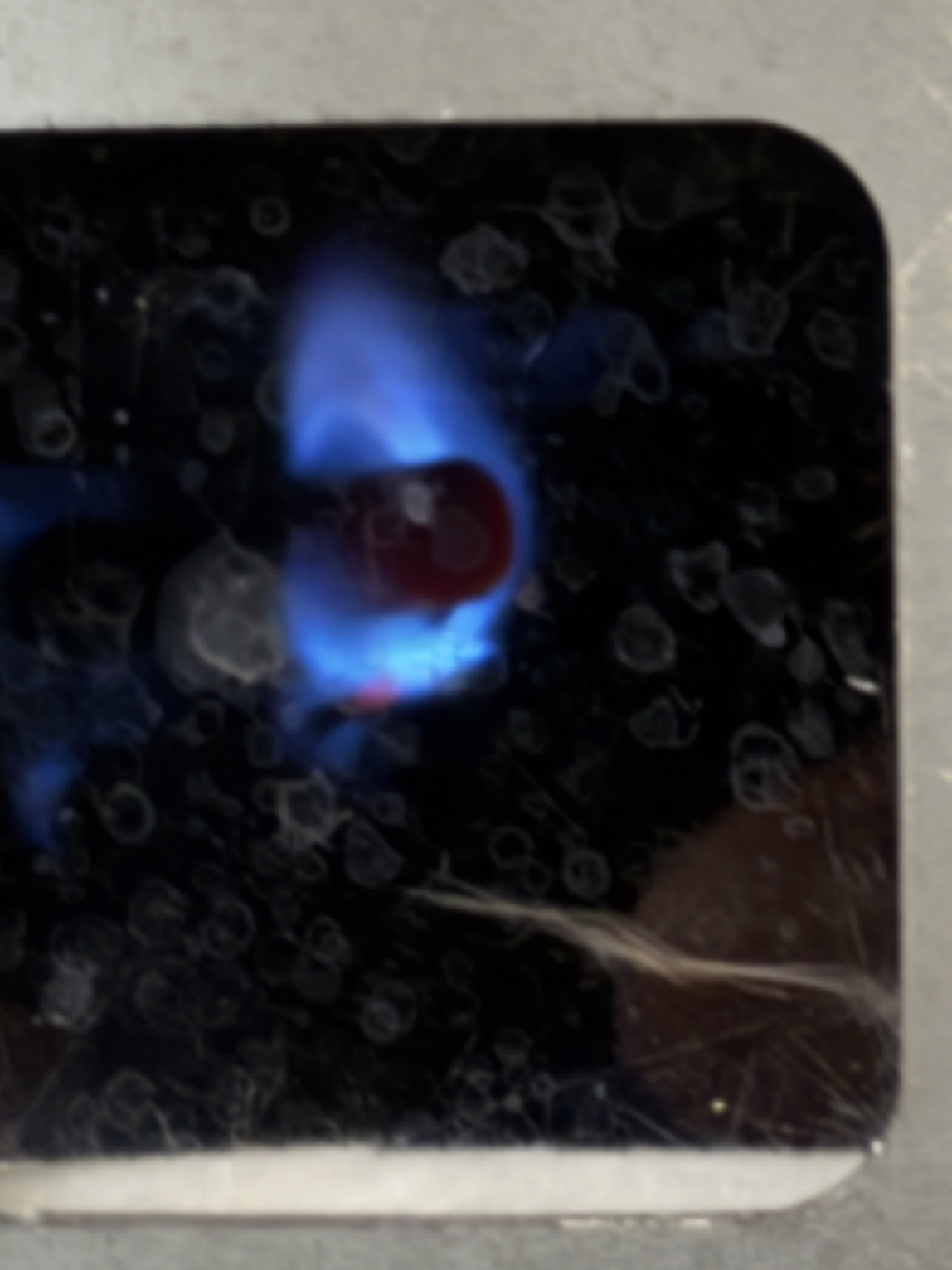

    Can you post a pic of the pilot light?
  • SuperTech
    SuperTech Posts: 2,711
    Pilot flame looks normal to me in that picture.

    I see 2 Blue spots on the very left edge of the pic.

    Good eye. I didn't notice that. That's definitely not normal and could be the source of the problem.

    That’s just the reflection of the pilot light. See photo.
    HVACNUT Posts: 7,784
    That's a reflection? Ok if it is, but IMO, with a sealed chamber, you shouldn't hear the pilot light. Not unless you were down on the ground looking for it.

    Yes, that is a reflection off of the metal clamp that holds the gas tube.
