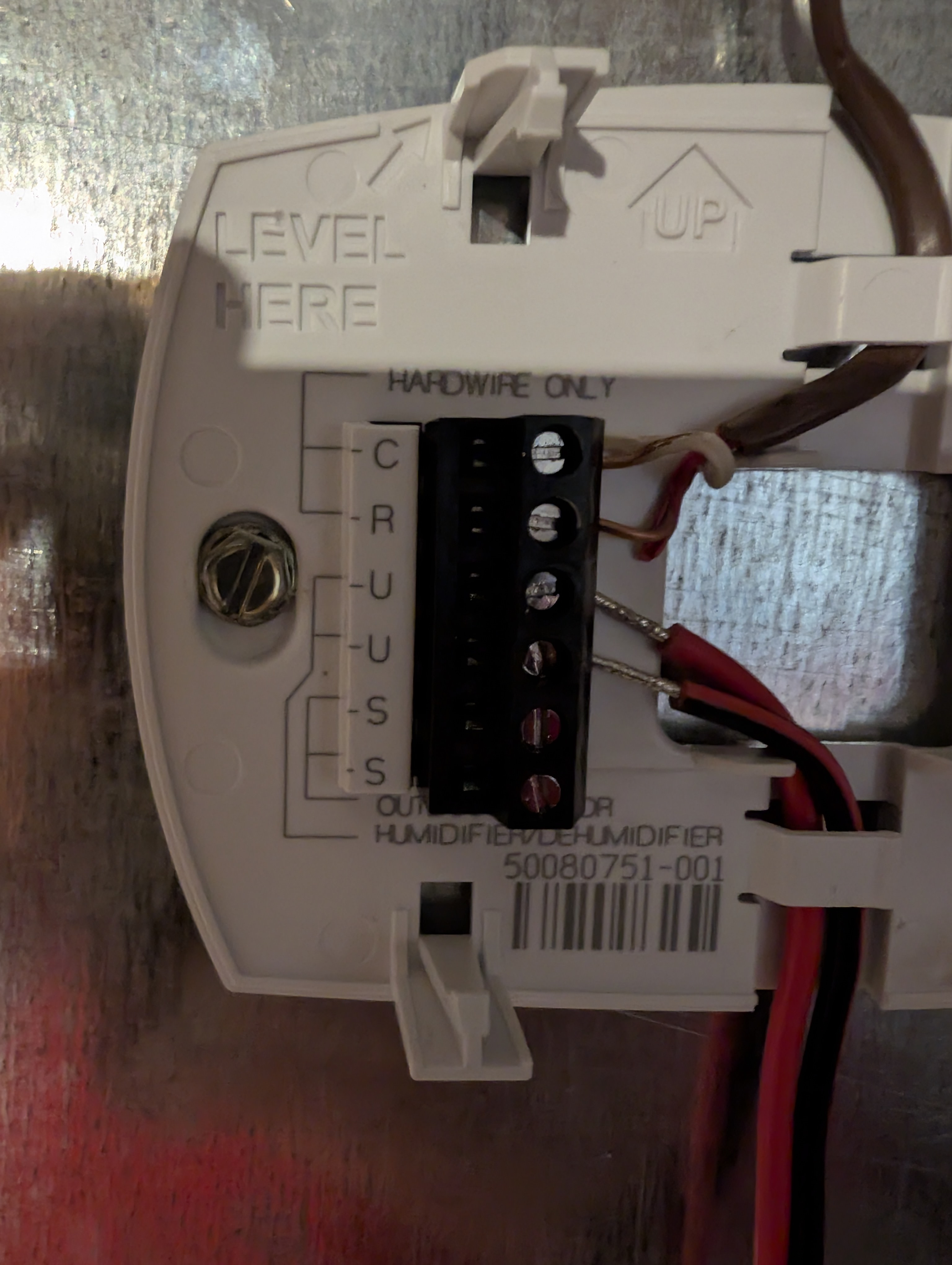

I just hooked this up to furnace. it comes with the Humidipro 6202 humidistat.
I am getting no power to the water solenoid. the terminal block on the humidistat has 4 wires connected. R and C from a new separate transformer(not the one on the furnace) There are 2 terminal connections labelled "U" each has a wire connected to the water solenoid. The humidstat gets 28v., but no power ever comes out the 2 wires going to the U solenoid. I called tech support several times, went and got a new humidifier. same issue.
I think the wiring is incorrect but Honeywell said it is fine. I saw on the another forum to run a jumper wire from R or C terminal to one of the U terminals. Any ideas???

    u-u is just a dry contact closure. you have to connect 24vac with one side to the solenoid and the other side through the u-u contacts. that 24vac needs to be switched with the blower or it will call the humidifier constantly.

    There are 2 wires from the humidifier. one goes to one of the U terminals on the humidistat and the other wire goes to the other U terminal.
    R and C have power constantly from a transformer that came with the humidifier
    sorry . i dont understand wiring diagrams and electrical speak well.

    U-U is just a switch. It just turns the humidifier on or odd, it doesn't provide power
    R and C are 24vac power. It should be powered all the time. There will be an R and C on the transformer in the furnace which will always be powered. You can take this power from there by connecting a cable between the r and c on the furnace and the control.

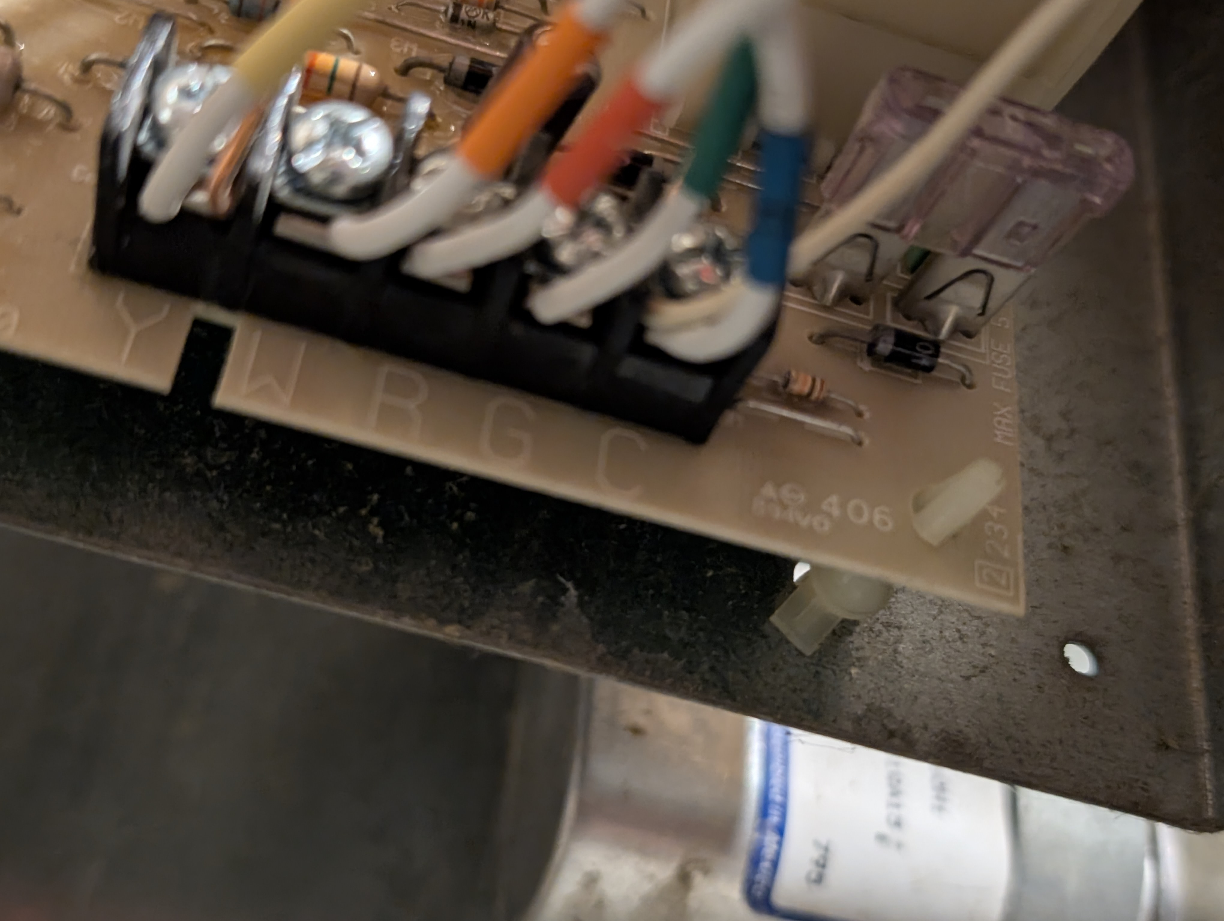

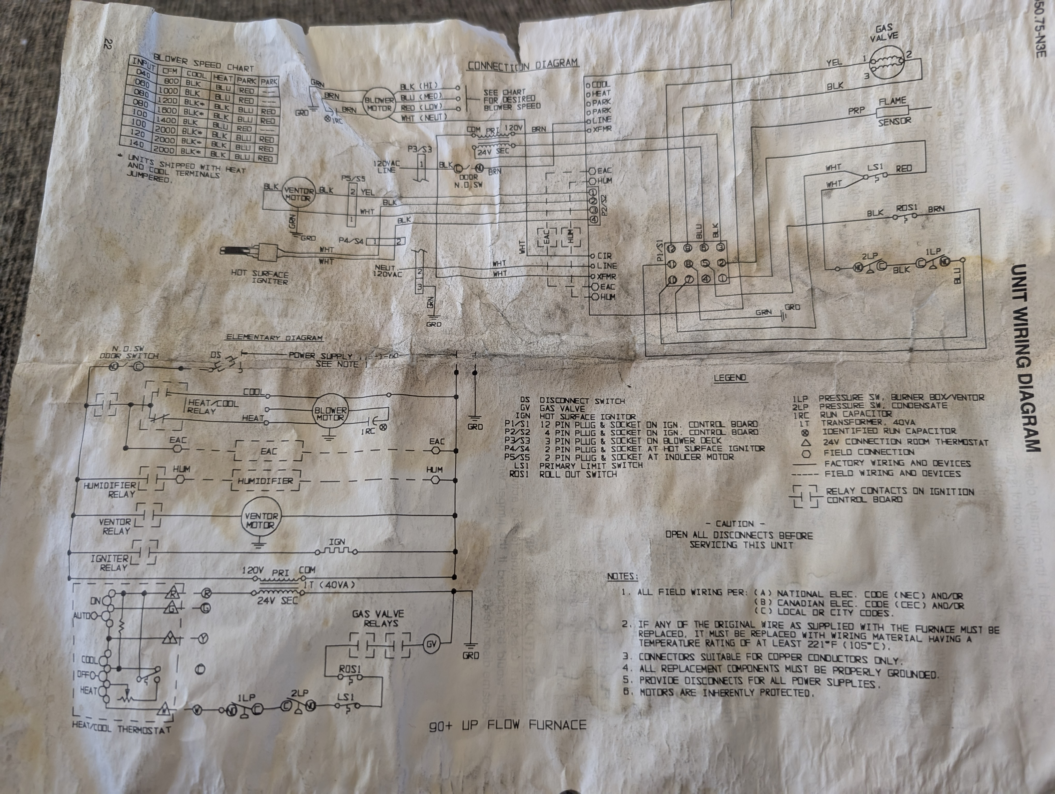

    You need a switched 24vac or 120vac to power the humidifier itself which you will have to get from the furnace. Can you take a picture of the board in the furnace and the schematic of the furnace, usually inside the blower door? There are several ways to do this depending on how your furnace is built.

    rreale Member Posts: 13
    ok, i Have 24 volts to the humidistat delivered from the new transformer that I hooked up yesterday.
    The furnace board has spade connections for humid(hot) and humid(neutral)
    the last pic is the humidistat

    So the humidifier transformer's primary (120 volt) side is connected to the Humidifier (120v) terminals on the furnace board? And the 2 Red/Black wires are going to the solenoid? No good. U-U is just a switch.
    Do this. Leave the humidifier transformer connected as is on the 120 volt side.
    Run 24 volt power from R and C on the furnace board to R and C on the humidistat. This will give the humidistat constant power for the display and switching.
    From the 24 volt side of the humidifier transformer, connect Common to one Red/Black wire on the solenoid. Then from 24v/R on the humidifier transformer, connect to a U terminal on the humidistat. The other U terminal connects to the other Red/Black.
    So now there will always be a display at the humidistat. And the humidifier itself will only operate in heat mode when the fan is energized.

    mattmia2 Member Posts: 17,433
    Here's the easiest way to wire it, combine the wires at the furnace with any existing wires. It just runs off the furnace transformer. It is a very small load. It will run the humidifier before the blower starts on a heat call and stop it when the heat call ends. it will let the pad get wet before the the blower starts and let it dry out between when the heat call ends and the blower stops.
    If you want to use the transformer, this is how you'd do it:
    There are other ways to do it but these are probably the simplest.
