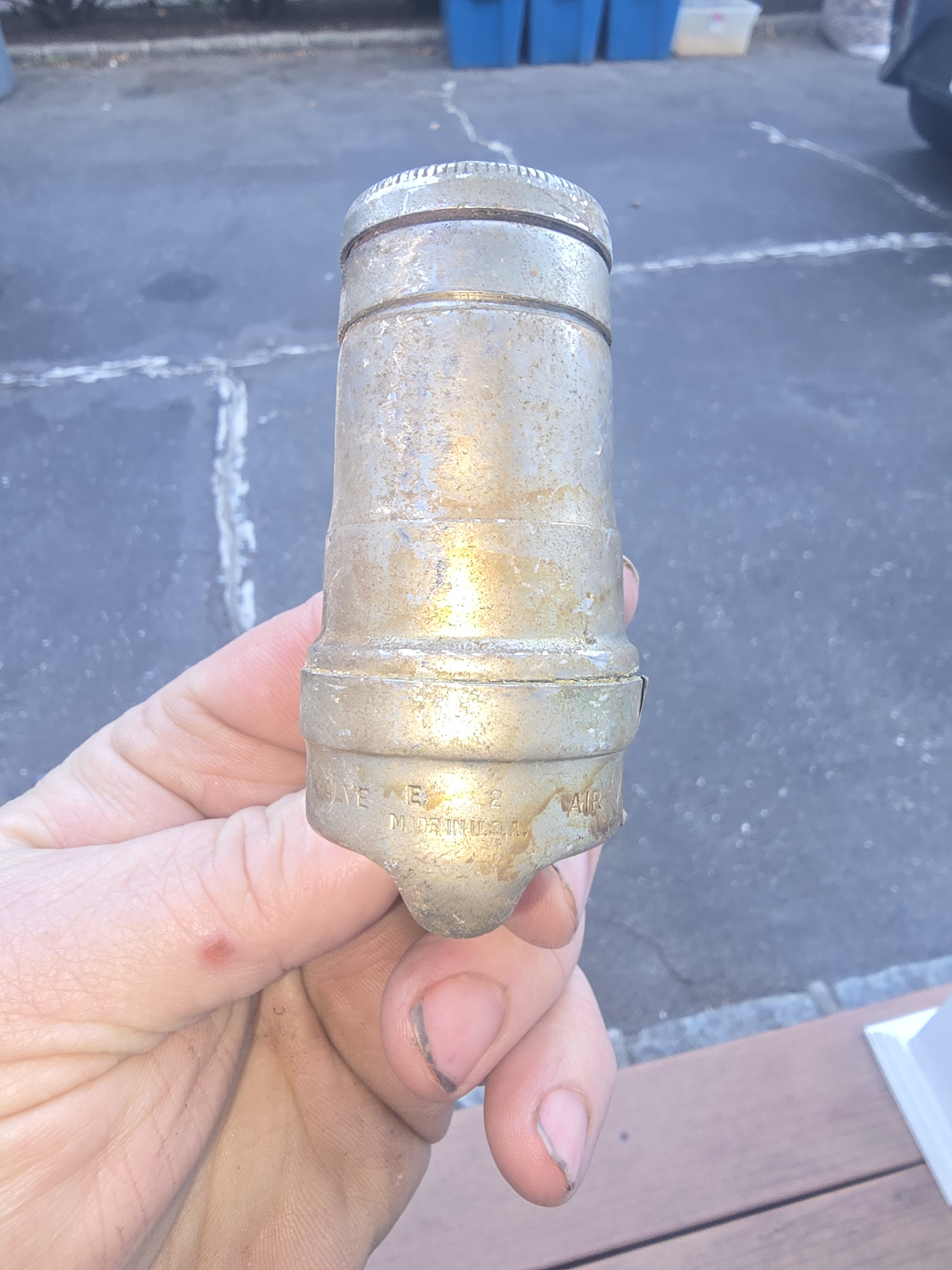

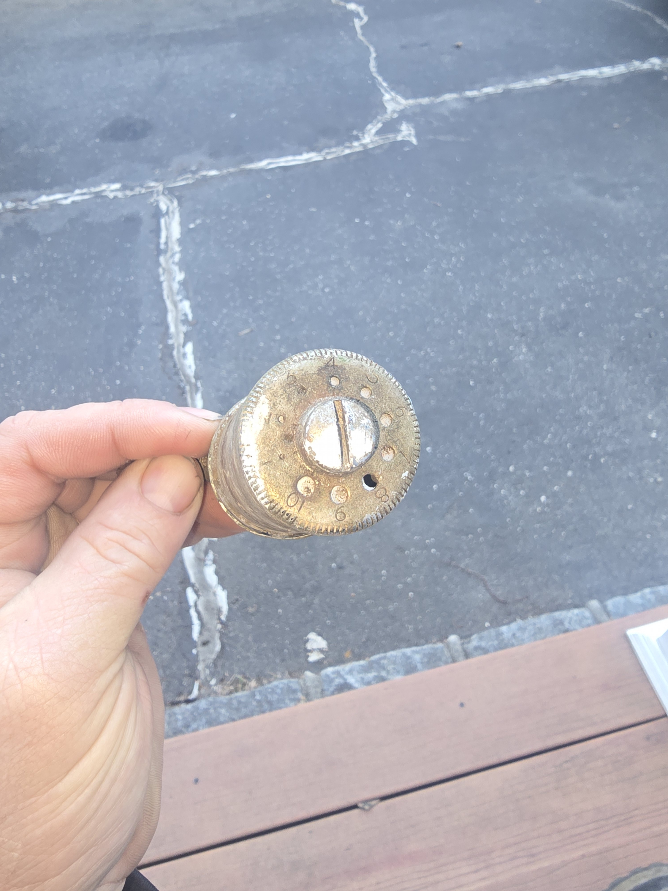

    @Aclera your vent is in nice shape. The one I have doesn't have any paint on it, but the plating is messed up in a couple of places.
    Also, the top of mine is slightly different from yours. Not sure why. Instead of a slot, it just has a hole and an arrow. I wonder which came first.

    does the slot lock it in position?

    @Chris_L Thanks for sharing pictures of your vent, that arrow engraving is cool! It looks as if there are several small arrows pointing to each number as well.
    Can the screw (is it a screw?) be moved by hand to adjust the venting?
    Another difference of mine versus yours and Mad Dog's is that both seem to have deeper engraving of the "MACK" text — on mine, the engraving is very shallow and barely perceptible in places, which is clearest in the third picture. Maybe I have a later revision or something like that, as it seems more functional- and less aesthetically oriented. I'll have to try to clean off the paint splotches one day 😁
    @mattmia2 On mine, the slotted screw holds the rotating dial in position, yeah.
  • Chris_L
    Chris_L Posts: 354
    @Aclera The small cap on the top with the arrow on it doesn't move at all, and I can't unscrew it. And the arrow doesn't seem to point to anything in particular. I am guessing it was used in assembly.
    To adjust the vent you turn the larger cap with the holes in it to line up the desired hole with a fixed hole beneath it. The larger cap clicks into place as the holes line up.
    There are lines from under the center cap to each hole, but some line up better with the center of the holes than others. Not sure they have any use.
