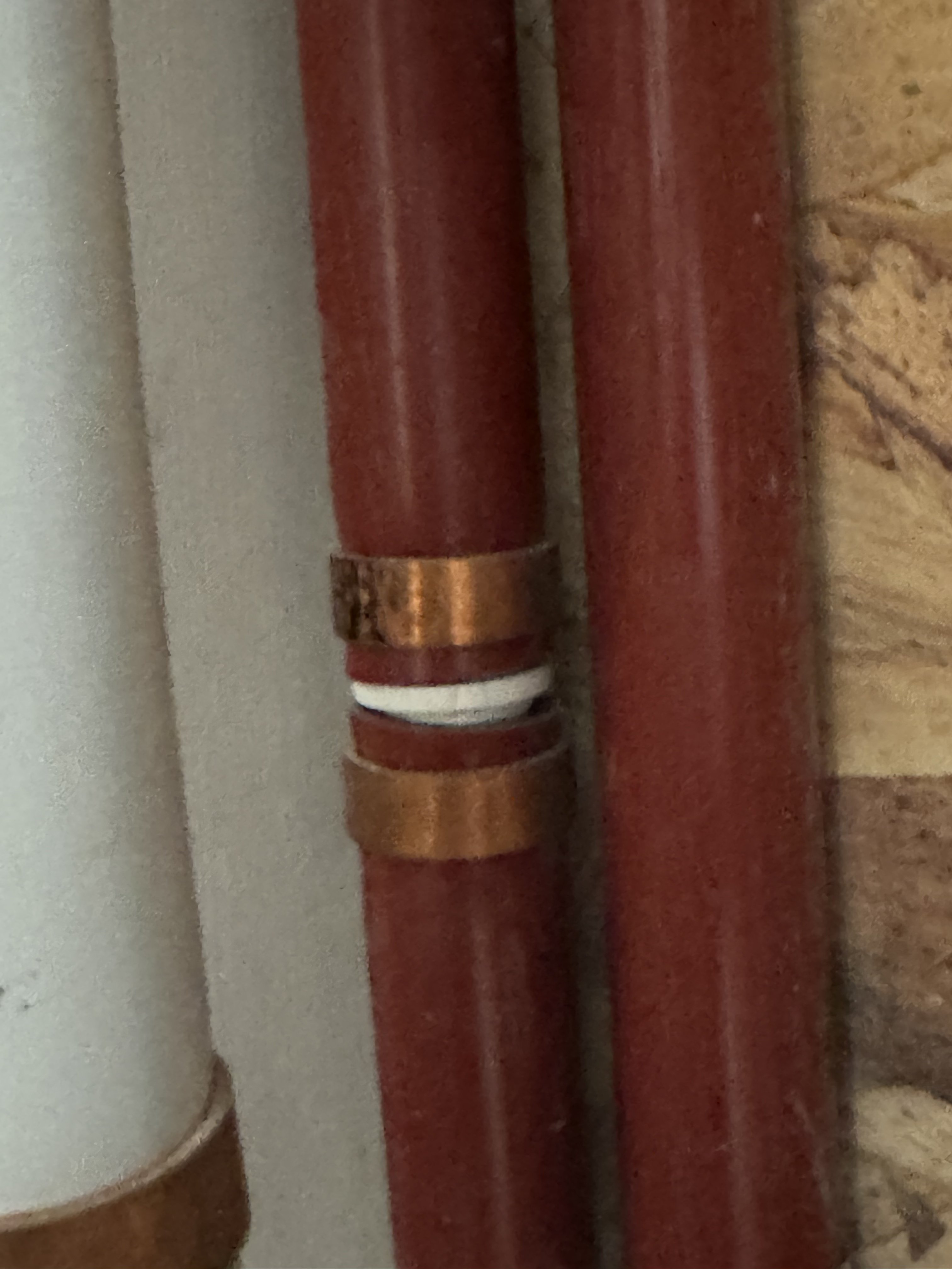

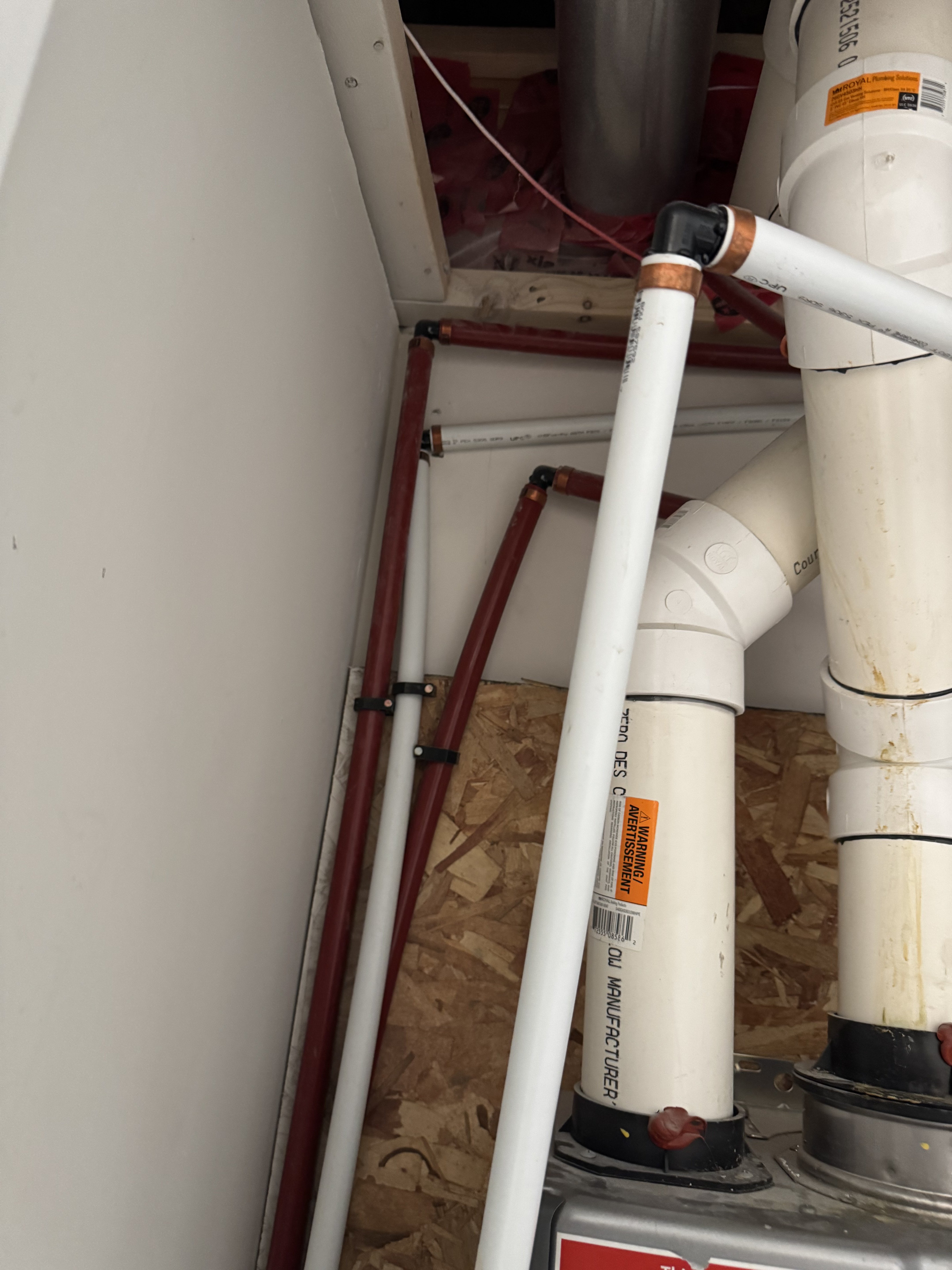

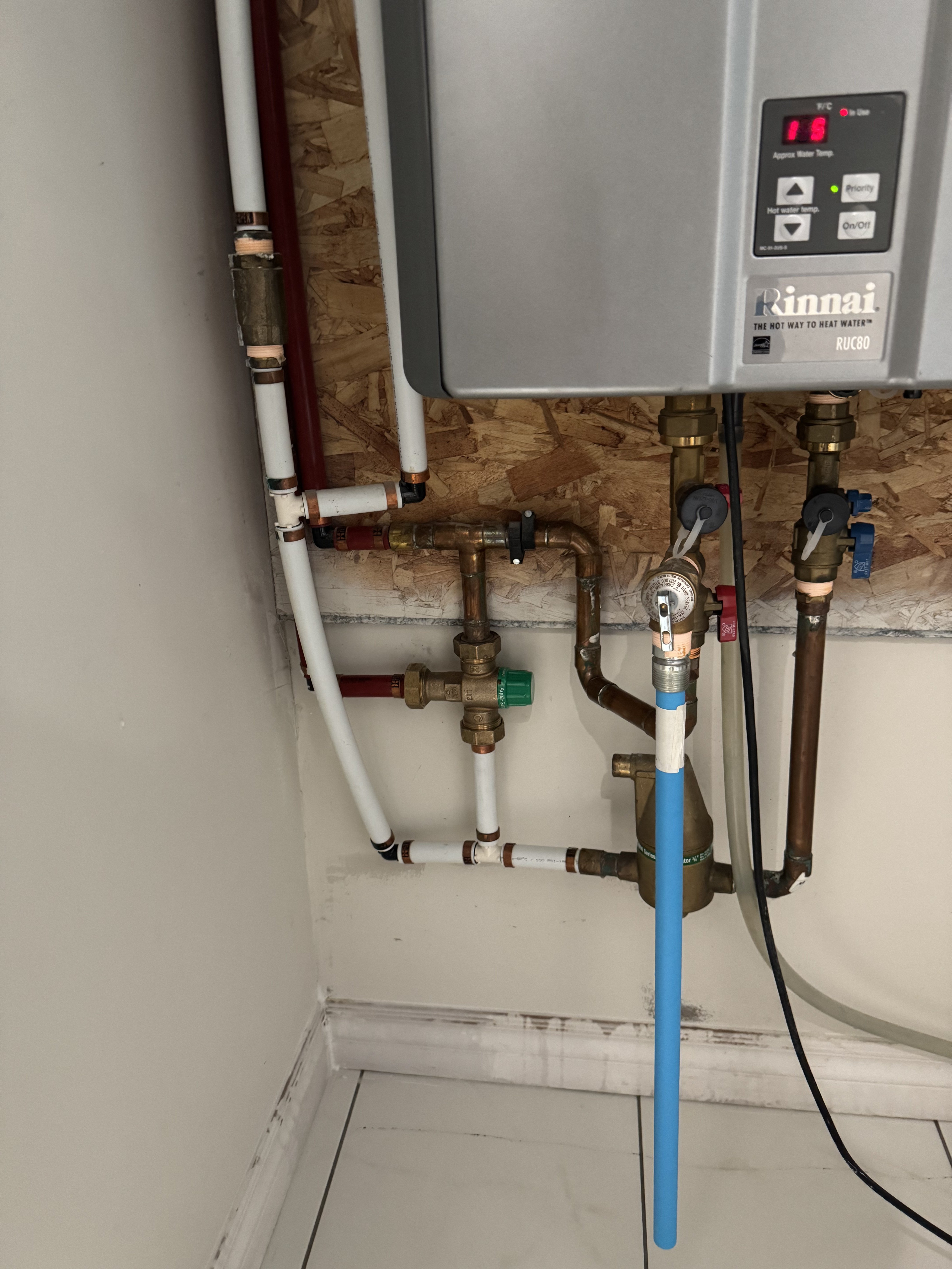

    While swapping out the valve, I did notice what looks to be a bit of a piping hack job, at least to my untrained eye. I also noticed a gap between two pex pipes, wanted to check in with the folks here as to whether I should contact a plumber to redo this whole setup. Pictures attached of the gap and the overall plumbing.
    hot_rod Member Posts: 27,446
    soaking a valve with hard water scale in vinegar can often clean them out, use it for a spare
    It looks like a heating air separator on potable water?
    I don’t think that is low lead or NSF approved?

    What Hot Rod said… I'd get rid of the air eliminator and you don't need the mixing valve unless your code requires them in your area.
