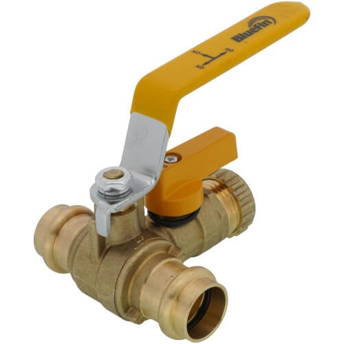

    Last week was my first solo boiler install. I used the pumping away method Dan outlined. I also installed 3 purge zones on the return above my zone valves. It took all of 5 minutes to purge the system at the end of the day.
    Also, Webstone/Bluefin make combination vales that are basically prefabbed purge zones you can just propress in place. Super nice.

    @Nhaggard07 Kudos to you. Thats a great feeling. I have seen the webstone valves on line but not in person
