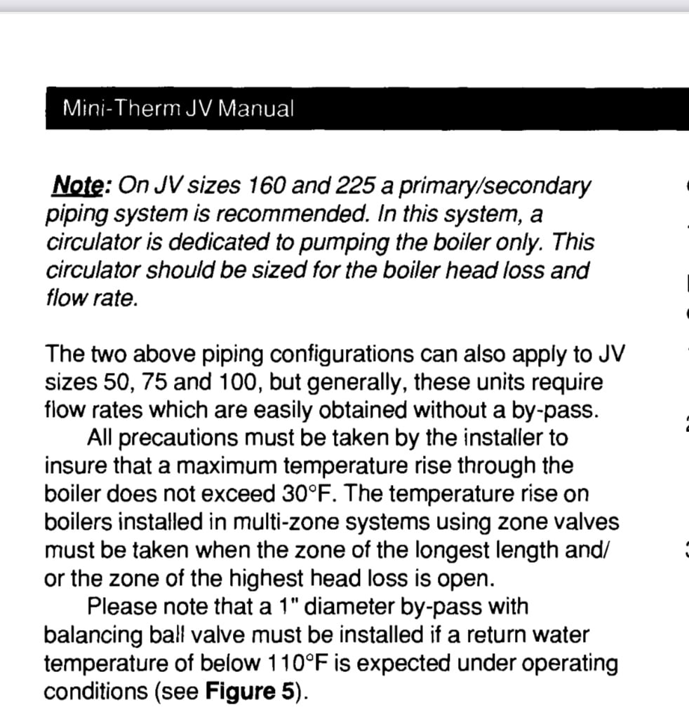

    There's not one on mine. They do show one in the manual though. Here's the diagrams they provide and what I used:
    My fill valve ("feed water inlet") currently goes into the return side though, and I am planning to move it above the expansion tank like they did.

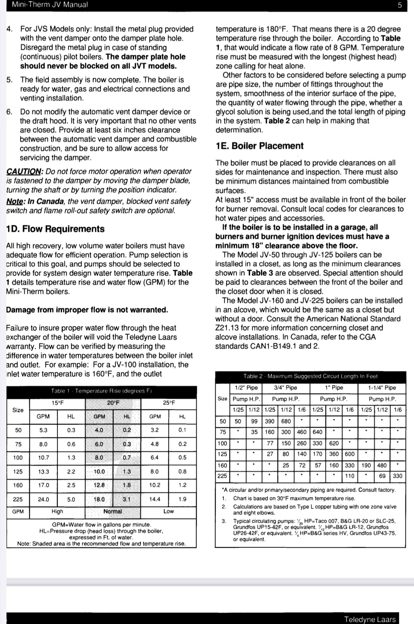

    Do you have the installation manual? It would give you pipe and maybe pump sizing info. Probably piping options. Find it online also at the Laars site.
    Attached

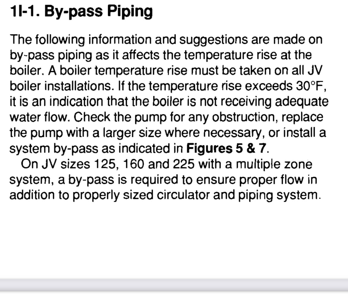

    That boiler, as per the installation manual should have a full size bypass or primary secondary piping.
    The table #1 shows the minimum flow, I doubt that pump, flowing through a 3/4 zone will get you anywhere close to the 14 gpm min. Much less the 18 gpm suggested “normal” rate. Maybe just crank it to its highest speed, although the noise is another issue. There is a reason you keep eating circulators.
    In addition I think the boiler oversized by a bit. A heatload calc on three home would determine that. Adding up all the heat emitters is another way to check the boiler output match up.
    I think you are headed towards a repipe, maybe even a smaller boiler, although cranking down the red know should lower the boiler firing. Look inside as you adjust, does the flame size decrease? The label on the boiler shows a low end firing of 78,750 btu/hr

  • That boiler, as per the installation manual should have a full size bypass or primary secondary piping.
    You are right, and my bypass is only 3/4" not 1", so I will upsize that. Thank you

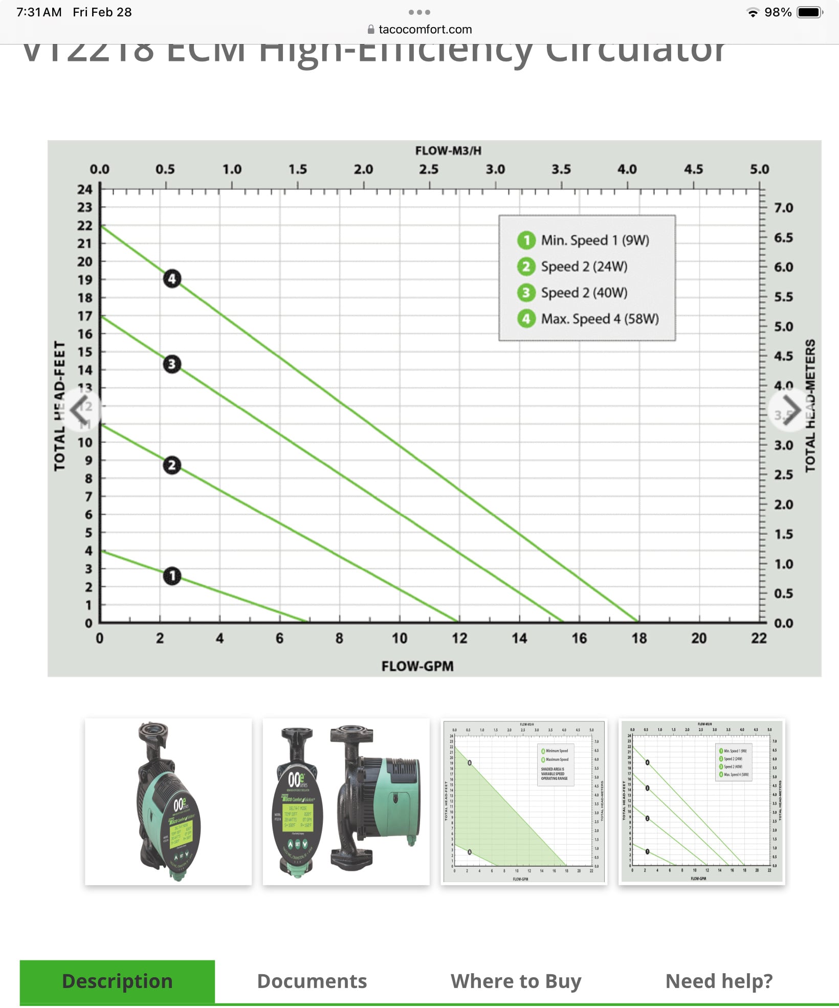

    Use 170f as you average water temperature, so the radiators can only transfer 67,000 btu/ hr
    Run out on that pump is 18 gpm, the far right of the curve on speed 4. Ideally you want to run in the middle 1/3 of the pump curve.
    But you have to take into account the head, the left side vertical axis. Since your piping path is through a 3/4” zone or bypass, I doubt that you are getting maybe. 6 or 8 gpm through the boiler that wants 14- 19 gpm.
    If you piped a primary loop through the boiler, a 1-1/4” loop, I think that circ is still too small.
    It could serve as a zone circ off a primary loop, perhaps.
    I don’t see any way that circ, as the only circ will get the flow you need

    I wanted to update y'all, it's been a minute.
    So, I reached out to Taco with videos of the problem, and they didn't say much explicitly about the noise, but they agreed that I should warranty the pump through where I bought it (Zoro). Zoro accepted the return request. Before sending it out, I ordered a new pump from PexUniverse, which has a newer date code on it by a few months. Looks like it was built in 2025. Otherwise, it looks exactly the same.
    This new pump is SO much better. It actually is "whisper quiet" as the box says. So I wasn't going crazy, the only possible explanation has to be bad bearings. I am really happy with it.
