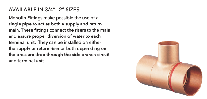

Monoflow Tee vs Diverter Tee
Hi all, I'm hoping for an explanation on what the difference between these two tees. I'm a little unclear, as some of the diagrams I see look pretty similar. Thanks in advance for your help!

    I believe Monoflow is a trade name for a type of diverter tee. They both do the same thing.

  • OK, two follow up questions. I read on the screenshot that the Monoflo can be installed at either the supply or return riser. Here is a pic of the boiler and one of the Monoflo tee. My questions are:
    1. This tee is labeled "Up-Feed" It looks like the screenshot posted didn't differentiate. Are they pretty much the same fitting if used on the supply or return side? (If so, any idea why this one is labeled "Up-Feed?)
    2. I am currently reading Dan's book on Primary /Secondary pumping and he mentioned the space between the supply and return pipes shouldn't be too close. Does placing the Monoflo tee at the supply side allow the supply and return to be closer?

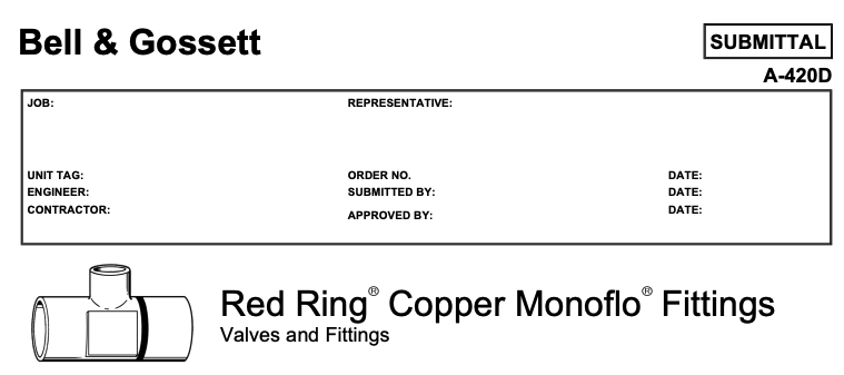

    Monoflo tees have a partition in them (b&g calls it a venturi but how much venturi effect it produces is questionable at best). One port of the run is open to the full diameter of the tee, the other run port is partially partitioned off and divided between the run and the branch so it divides the flow between the main and the branch to the emitter. If the tee is at the supply of the emitter then the partition is at the outlet of the tee on the main. If the tee is at the return from the emitter then the partitioned side of the tee is at the inlet from the main.
    The partitioned run of the tee always goes to the section of pipe between the supply and return to the emitter because that section is where the flow is divided between the main and the emitter.
    If the divided side is placed toward the section of main between emitters instead of the section across an emitter it will restrict the flow in the entire main.
    I think the full monoflo deign book is on b&g's website somewhere too.

    The tees should be oriented like this. You could have it on the supply or the return or both but the orientation always has to be like this:

  • i have not seen an actual Monoflo® system without a Circulator pump. I'm pretty sure that won't work efficiently without a pump. This particular Monoflo® predates the Red Circle® tees that @hot_rod pictured above. Here is what is going on inside that particular fitting.
