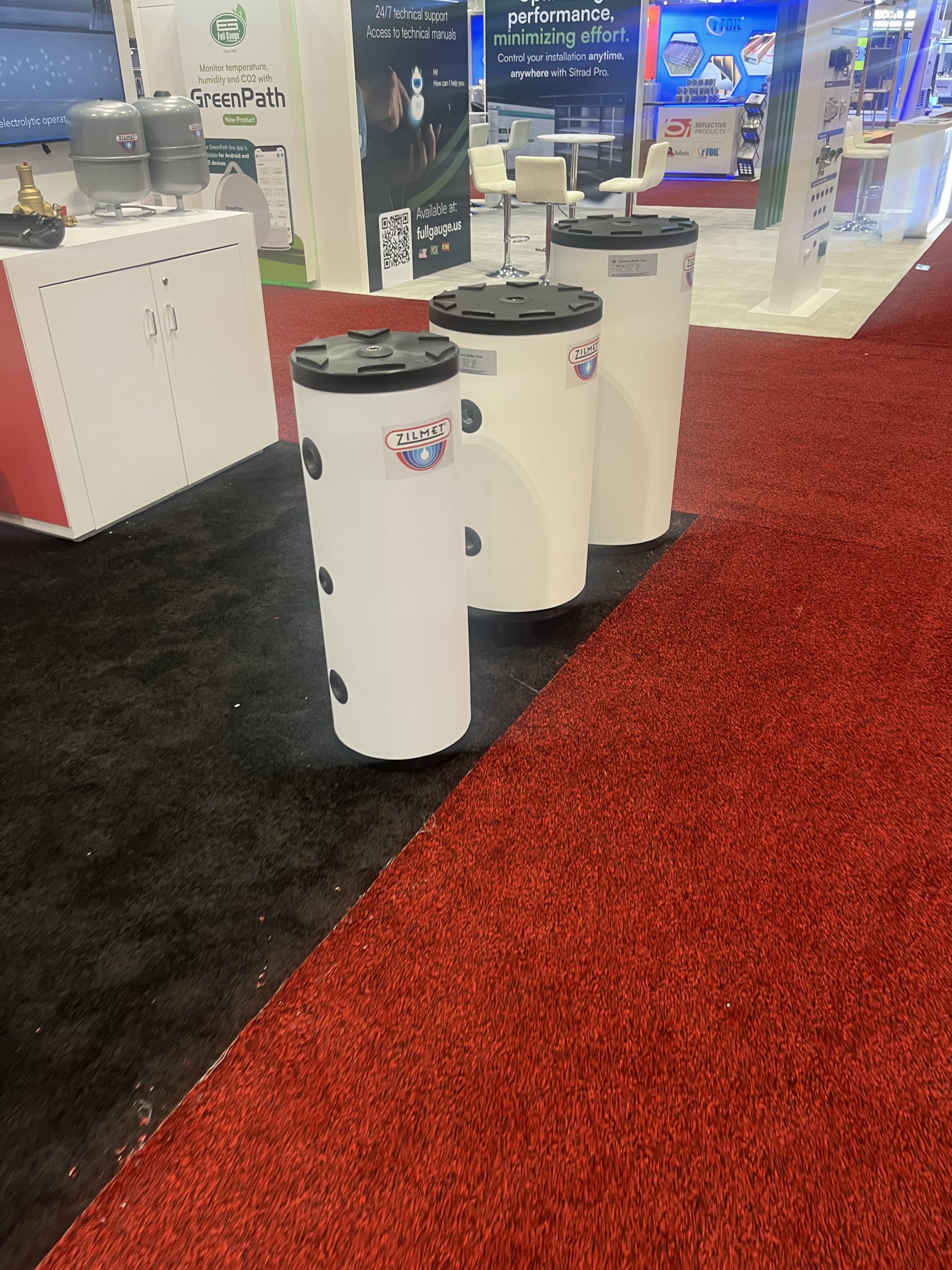

    The buffer tanks are getting much smaller with the latest compressor technology. Zilmet was showing wall hung buffer tanks starting at 7gallons on up at AHR
