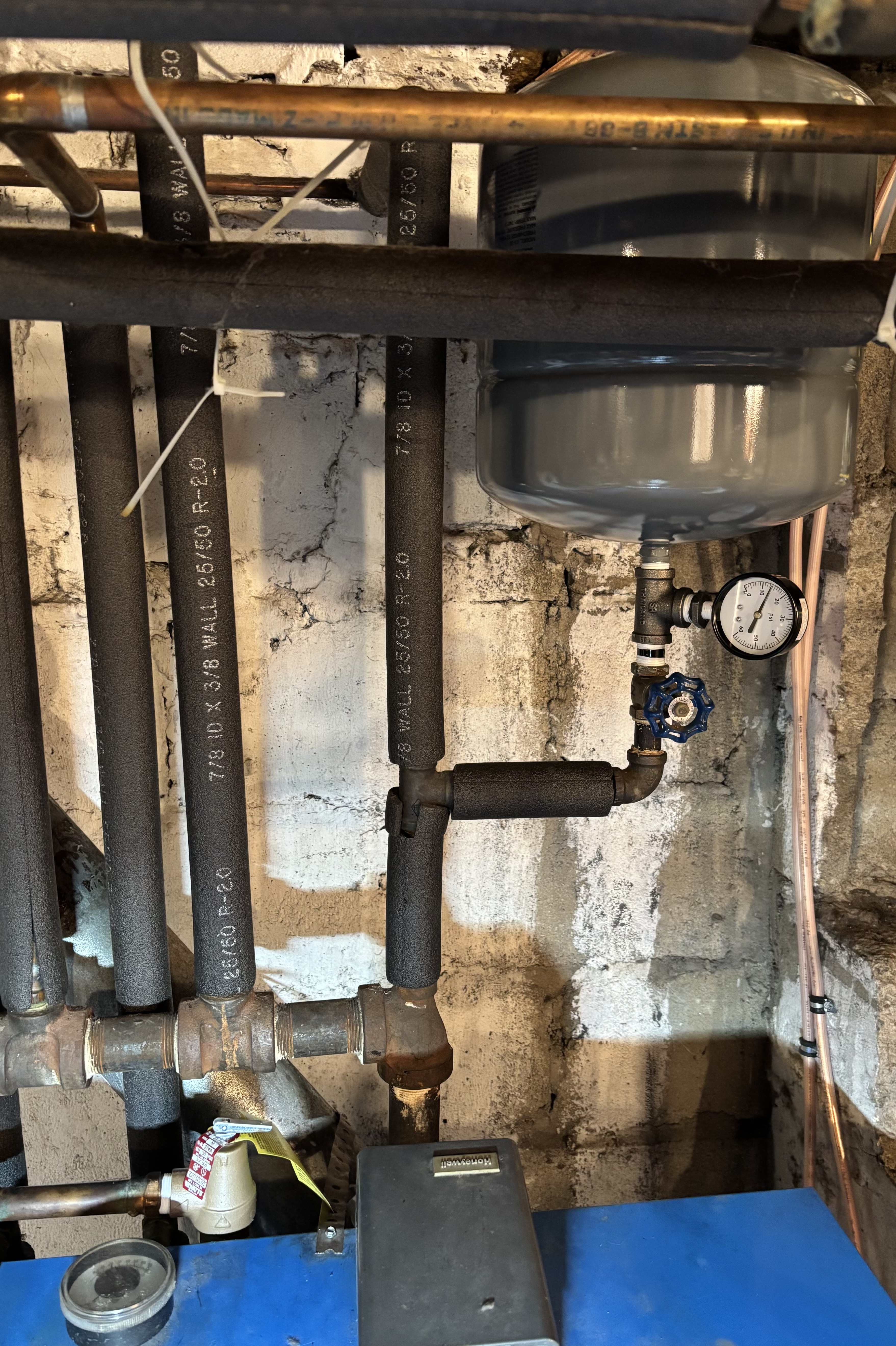

  • Expansion tank is 4.4 gallons. It’s a single floor home, and the distance between the top radiator and expansion tank is only around 4 ft or so.
    I am able to valve the reducing valve completely. I tried that prior to replacing parts and it didn’t seem to help.
    I didn’t try reducing the incoming pressure just because there is no gauge immediately after it so I feel kind of blind.
    After leaving everything off all night, the pressure was sitting at 15psi on the boiler, so it seems the new reducing valve/expansion tank are working as expected, right?
    Not sure if it is relevant, but the expansion tank does not have an air vent above it. Doesn’t seem relevant since I bled the air out and new air isn’t coming in. Not sure about how it is mounted also. I did tee a pressure gauge between the shut-off valve at the tank and the tank itself to help gove some visibiliry. Not sure if that is good enough at that location to trust for reducing the feed to 12psi.
    Attached a pic. The pressure reducing valve is just a bit to the left on the rear high pipe by the wall that leads to the tank.

    It could be that the expansion tank is simply too small for your water volume and delta T. As john said, if you routinely had air in the radiators before, that extra air volume was also acting as additional expansion volume.
    Now that you've eliminated all air, there's only your relatively small expansion tank to accept the increased volume. And if you have a large water volume as is typically in gravity conversion systems with big old cast iron radiators, that affects the needed tank size. Also, it depends on your water delta T. The bigger your delta T, the more expansion volume you need.
    Here's an online sizing calculator that you can play around with. Your biggest unknown will be water volume. For comparison, in our 100-yr-old house in the Boston area with 2400 sq ft and 10 cast iron radiators on 2 floors, I figure we have around 100-150 gallons of water volume.
    https://www.watts.com/resources/planning/expansion-tank-sizing-calculator-non-potable
    When your house was built, it probably had the old-style steel compression tank with no diaphragm. Those have to be roughly half-full of water and half-full of air to work right. So only half the tank volume is free to accept expanding water, and you can only use a small fraction of that free volume for expansion before you start hitting the 30 psi relief valve pressure. So the old steel compression tanks had to be fairly large.
    The newer diaphragm tanks are more difficult and more expensive to make, so they make them as small as possible. Also, since the diaphragm tank is designed to be empty of water when the system is cold, in theory it can be roughly half the size of the old steel tank. So it would be interesting to know the size of your original steel compression tank. I'm guessing your new diaphragm tanks have been smaller than half of the original steel tank size.
    So you may just need to go up one tank size.

    Sometimes the bladder is stuck to the bottom port on a new tank and won't allow expansion. You can remove the tank and push on it with a wooden dowel to see.
    Could also be one of your pressure gauges is off and either the boiler feed is set higher or the air fill is incorrect. I would cross check both with a 2nd gauge set.

    gauges don't agree. if there is no flow and it is a closed system there is no pressure change
    try taking the pressure off the air side of the tank and see if you can push the bladder

    person56
  • I think the reducing valve has a min of 10, so I guess that’d be my low limit if I adjust.
    Forgot that I also noticed a “pro” version of the extrol tanks when I was looking for cost/availability of the larger size. The acceptance volume seems to be the same on the 30 pro as the 60 standard. But I know you said above somewhere that the free air volume matters more. So I guess that’s not worth swapping just to save a few bucks and some time to set up a support for it.
  • Just wanted to add…at this point I am just kind of thinking out loud and letting my curiosity run wild, making this thread carry on longer than it probably needed to. Hopefully not wearing out my welcome.
    It seems like I already hit a point where I can declare the problem solved even though there is room for future improvement if desired. And for that I owe you all a big thanks!
    THANKS SO MUCH to everybody that posted such great info and advice! I feel like I learned a ton and saved a lot of money by taking it on myself, which I could not have been confident doing without your help.
    Equally important to fixing this issue, I’m no longer completely ignorant about how this system works. That’s a gift that will keep on giving.

  • It’s been running/cutting consistently since yesterday, finally stopped feeling the need to check it constantly.
    I’m an over-thinker and today I had the thought how do I know it’s the aquastat and not the thermometer that’s off? I then had a memory of the pressure showing somewhere between 30-35 without popping the relief valve before the issue was totally resolved. I never actually witnessed the pressure the times that the relief valve did open. But this memory reinforced my curiosity about gauge accuracy.
    Gauge is also a bit scratched up and hard to read at certain angles and without a good light, so I’m thinking it’s worth changing at some point. Though it would be nice to combine with some other work that already requires draining/releasing pressure.
    Not sure how I know the proper length and thread size without removing it first though. I wasn't ever able to find any manual for my seemingly uncommon model. Wouldn’t be fun to not have the new gauge on band before draining.
  • Now’s the time I expect you to think “this guy needs to stop thinking about it and move on”.
