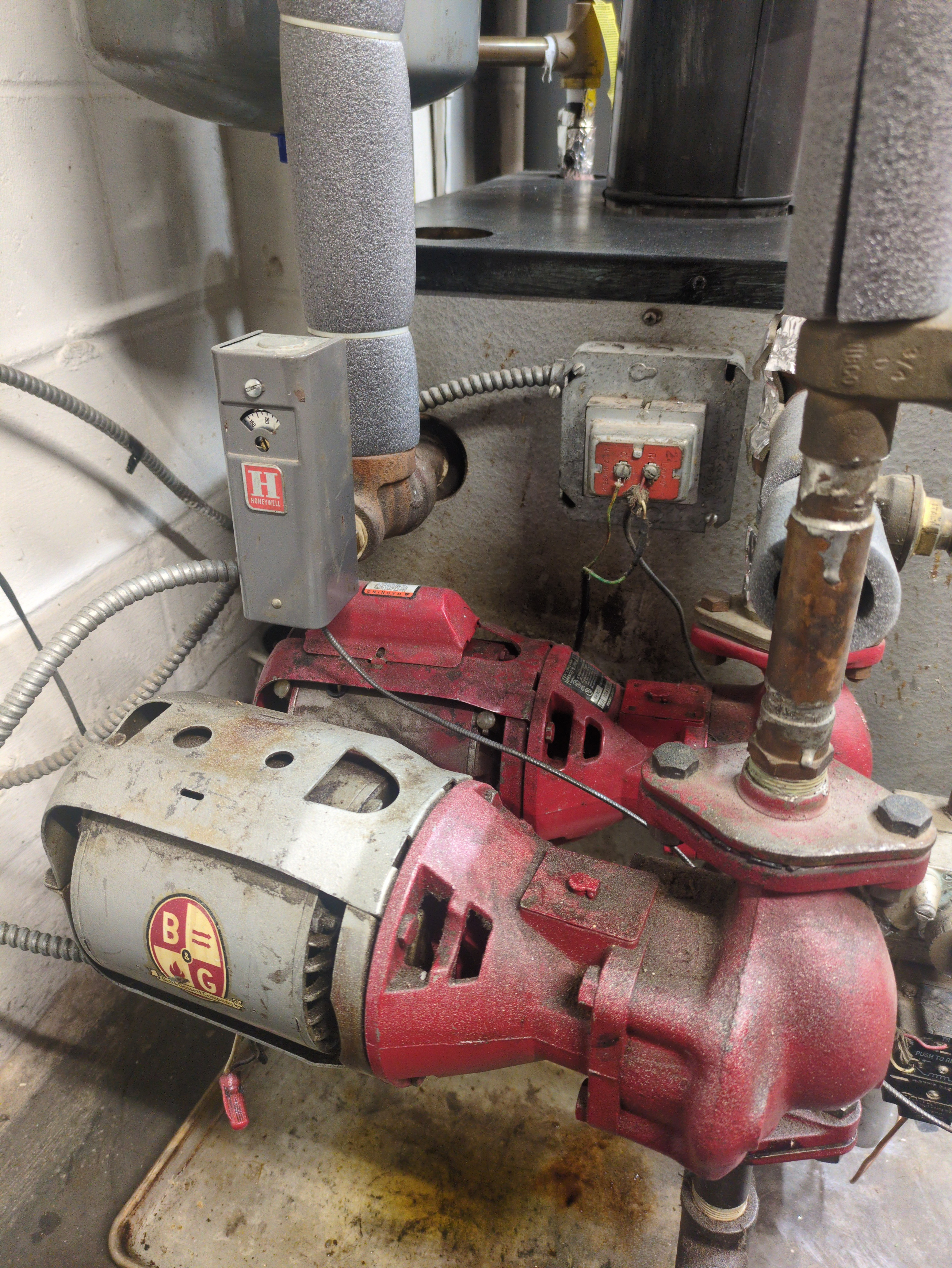

    Here's a pic of circulator/Aquastat

    That Burnham is an oldie but goody. the B&G circulators are also great pumps. I can tell from the cover of your L4006A control that is probably the original. The replacement cover will have the cover screw on the top and/or bottom, not on the face of the cover. Getting an adjustable Diff. will make a difference. I would set it at 180° with a 25° Diff, and see how that works out for you.
    And let me be the third to say, It will fit just fine. LOL
