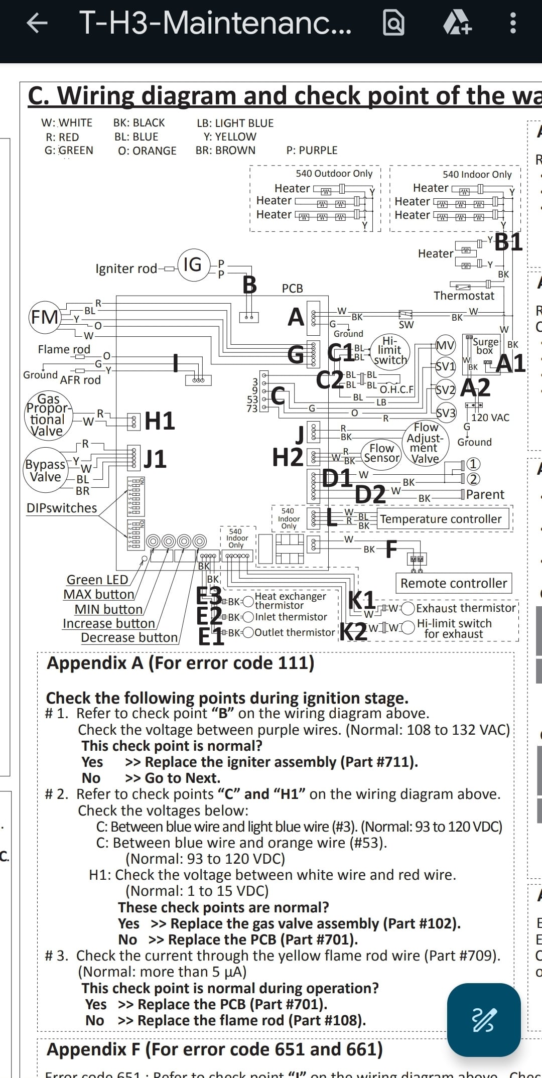

If you have confirmed getting a spark at the igniter and proper gas flow, can you tell if it ignites at all? If the pilot does not ignite, maybe the pilot valve isn't opening?

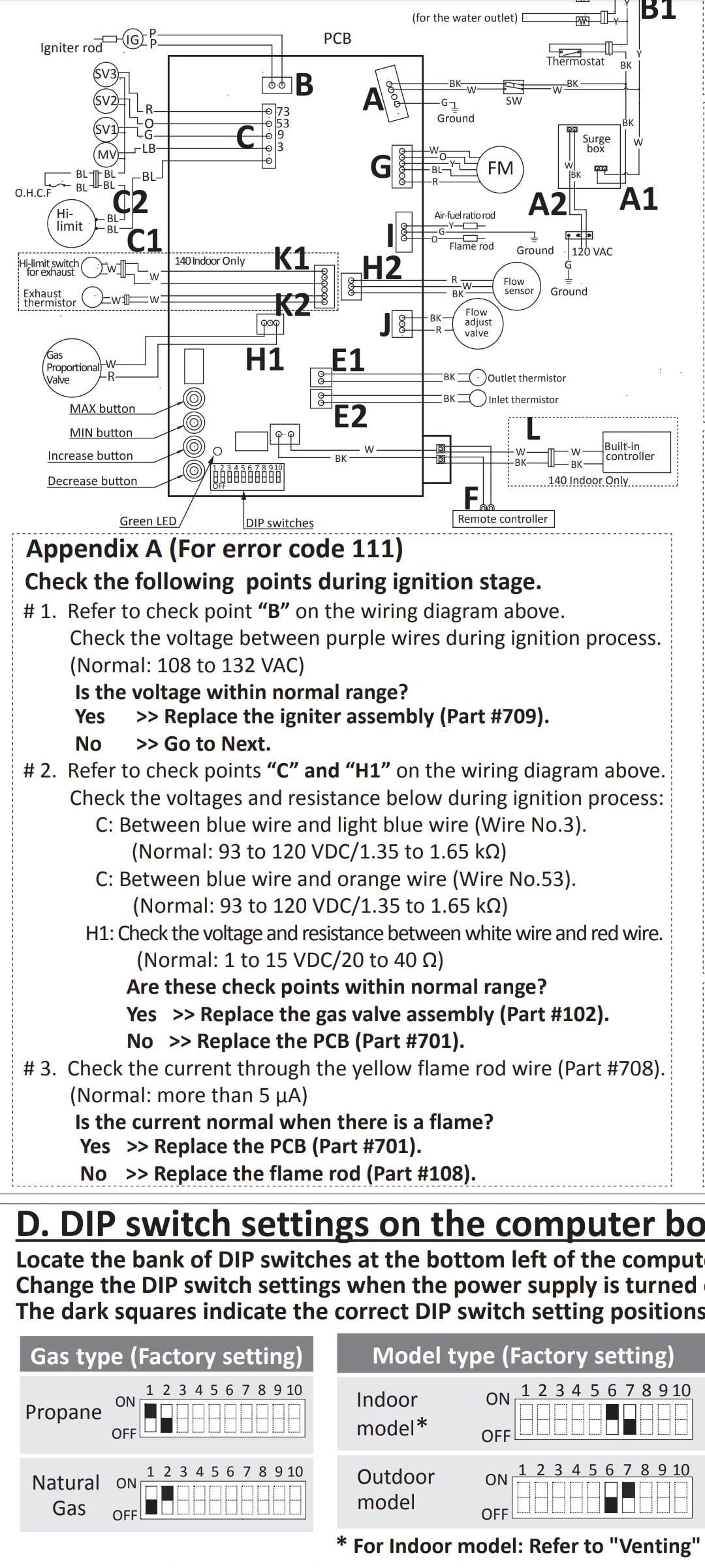

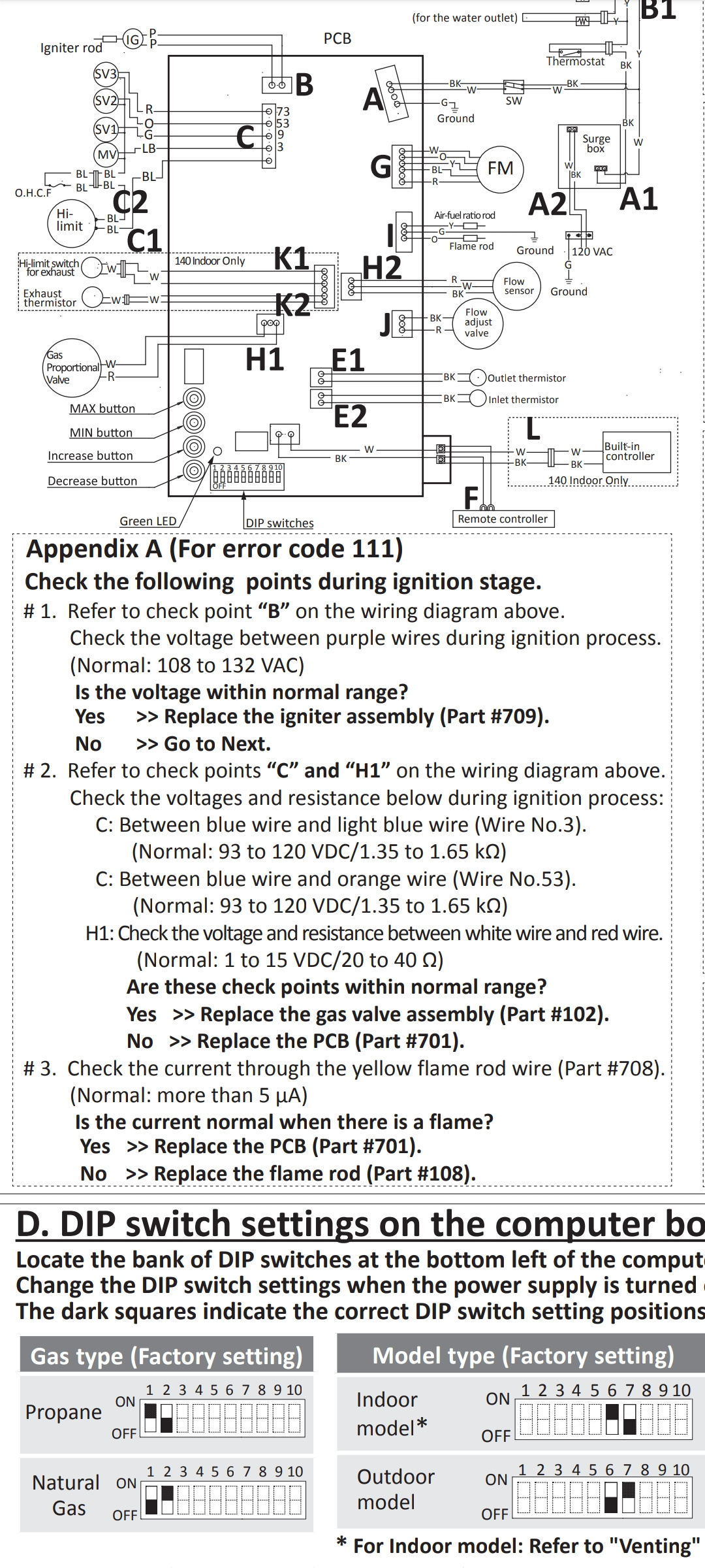

I'm not sure if either of these are your exact model. Did you find the maintenance manual with trouble shooting error code 111 for your model?
1 -
Pull the ignitor out of the unit and crank open a faucet. Does it spark?
