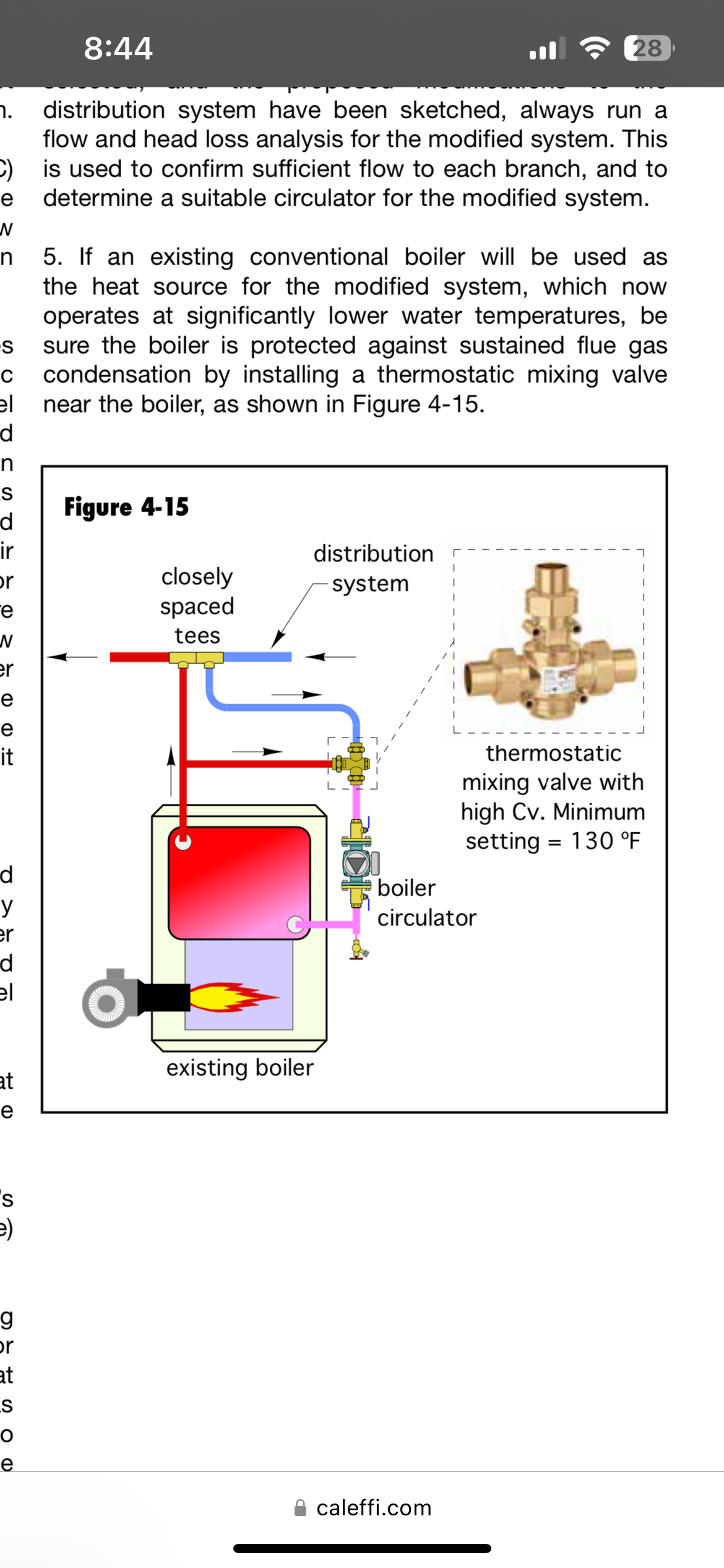

    hot_rod Posts: 28,699
    the 4 way valve you have discussed, is another option to protect a cast boiler.
    Hot_water_fan
  • I understand the 4 way mixing valve. It was the 130F return temperature that is confusing me as I thought it needed 135F to avoid condensing.

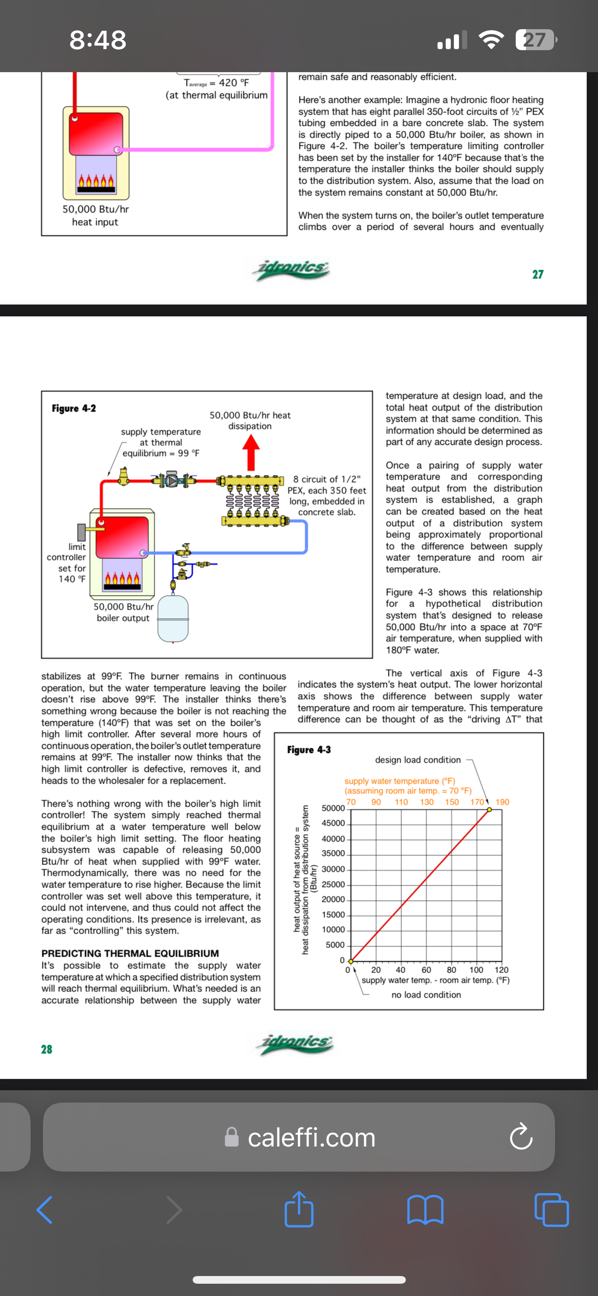

    All boilers condense on a cold start condition. As does your ICE powered vehicle.
    You want to limit the amount of time that a non condensing boiler operates below the fuels dew point. 130 is a realistic number to use for gas, oil and lp.
    The industry rule of thumb is within 10 minutes the boiler and entire flue warms above dew point.
    The distribution piping and heat emitters drive the operating temperature of the boiler. High mass concrete slabs , some gravity conversions are systems watch for with non condensing boilers.
    Primary secondary piping does not necessarily prevent low returns to the boiler, nor will a hydraulic separator, or a 4 way mix valve
    There needs to be a temperature sensor involved to respond and adjust flow rates. Some intelligence added to the piping.
    https://www.caleffi.com/sites/default/files/media/external-file/Idronics_23_NA_Heat%20transfer%20in%20hydronic%20systems.pdf
