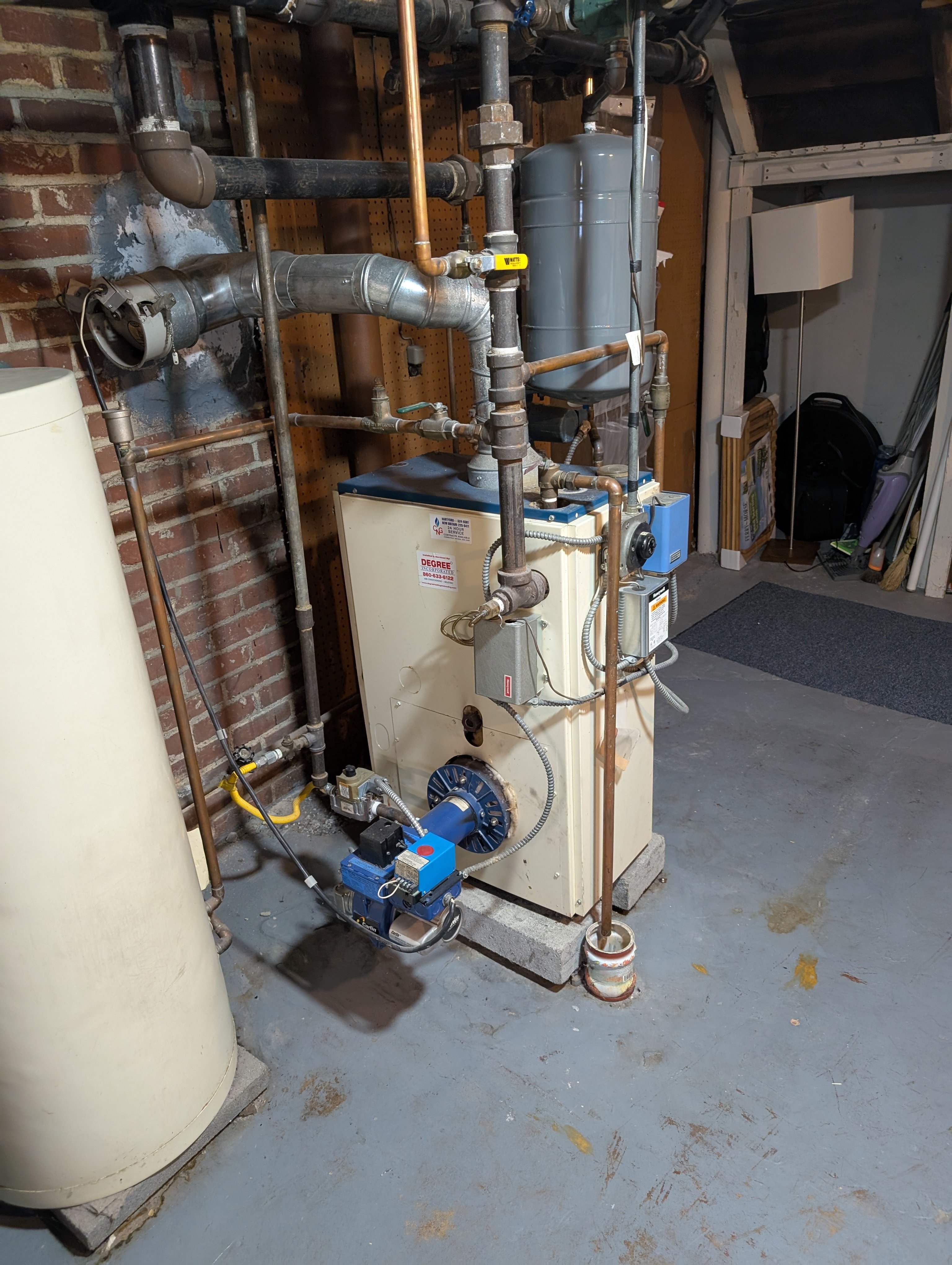

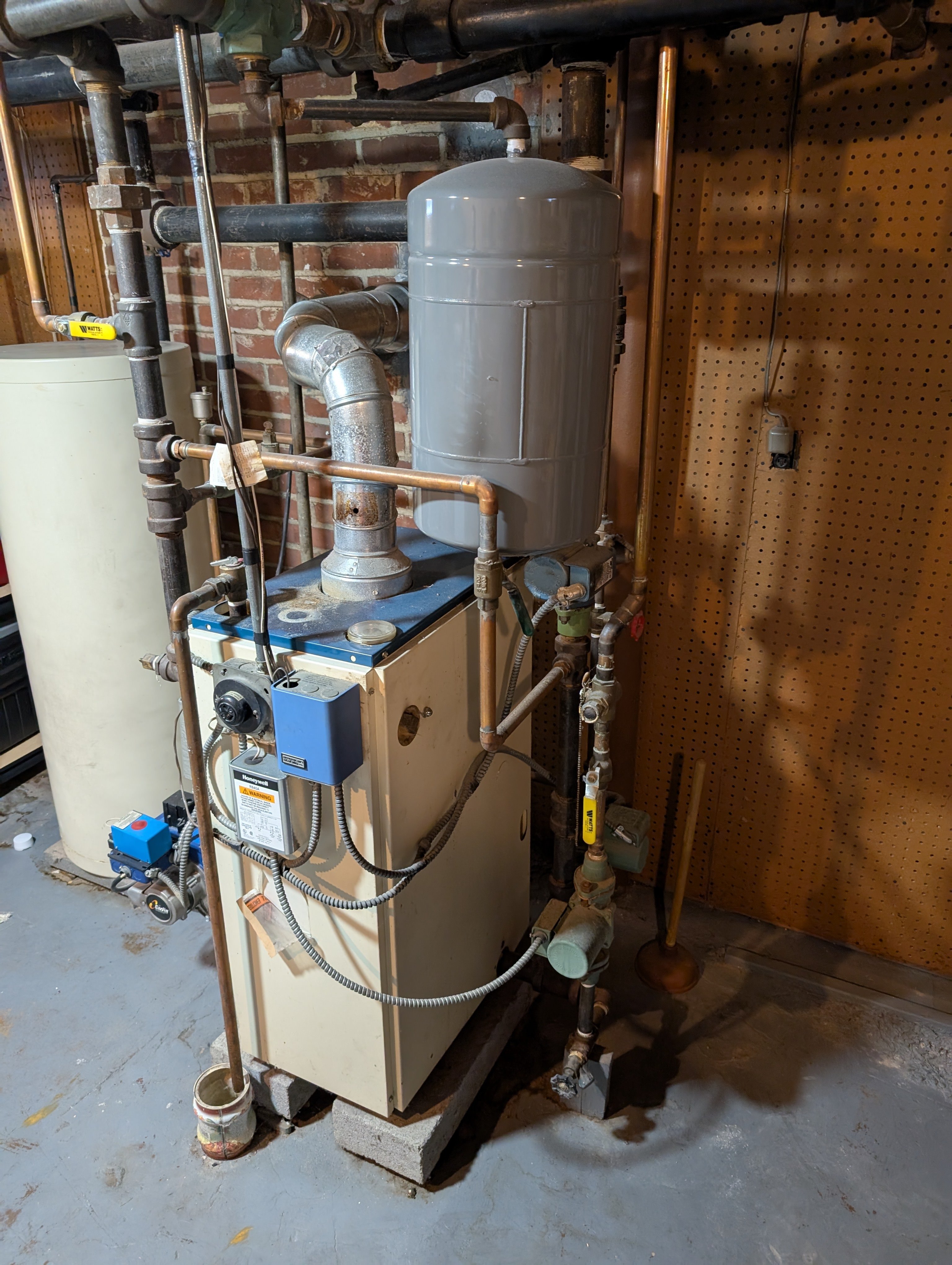

Good afternoon,

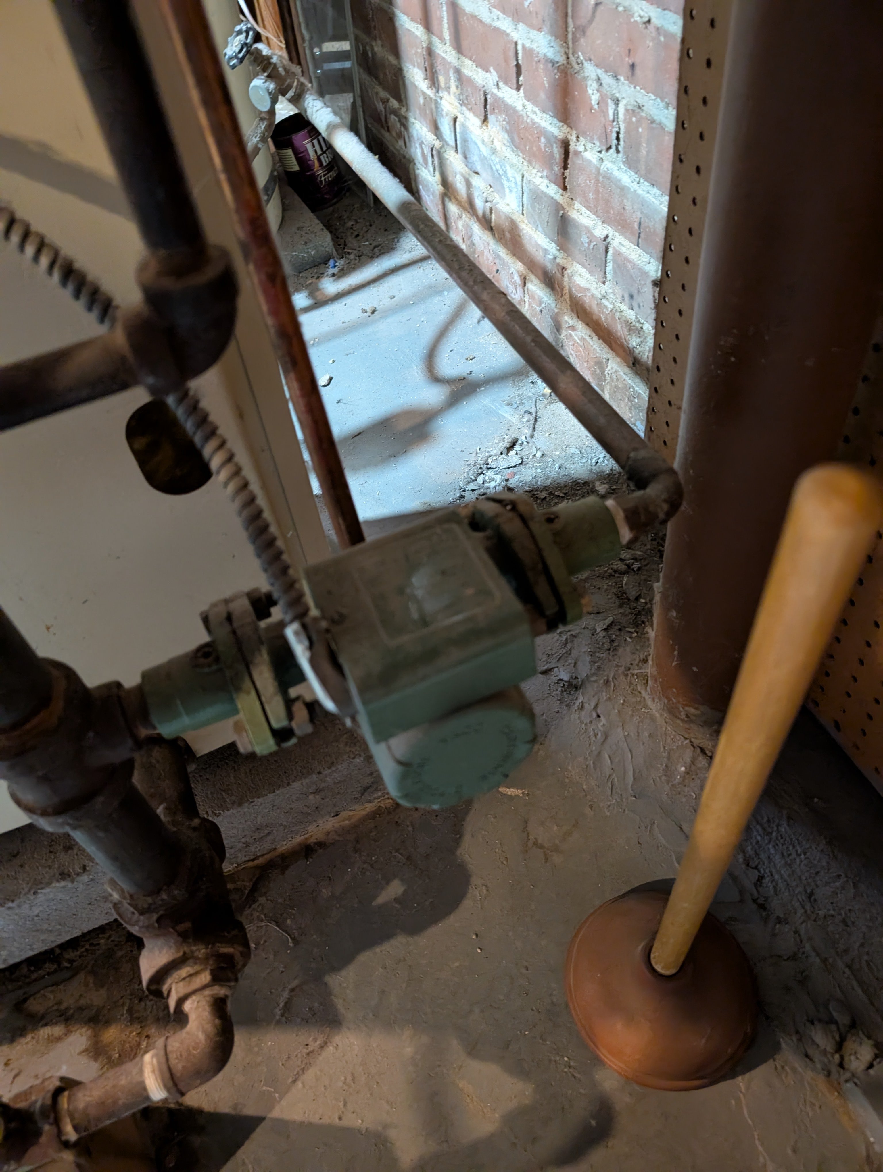

I'm working on a instruct swap out and cannot locate another 005-f2 Circulator pump. Would a 007 e or a regular 007 work? Thanks in advance.

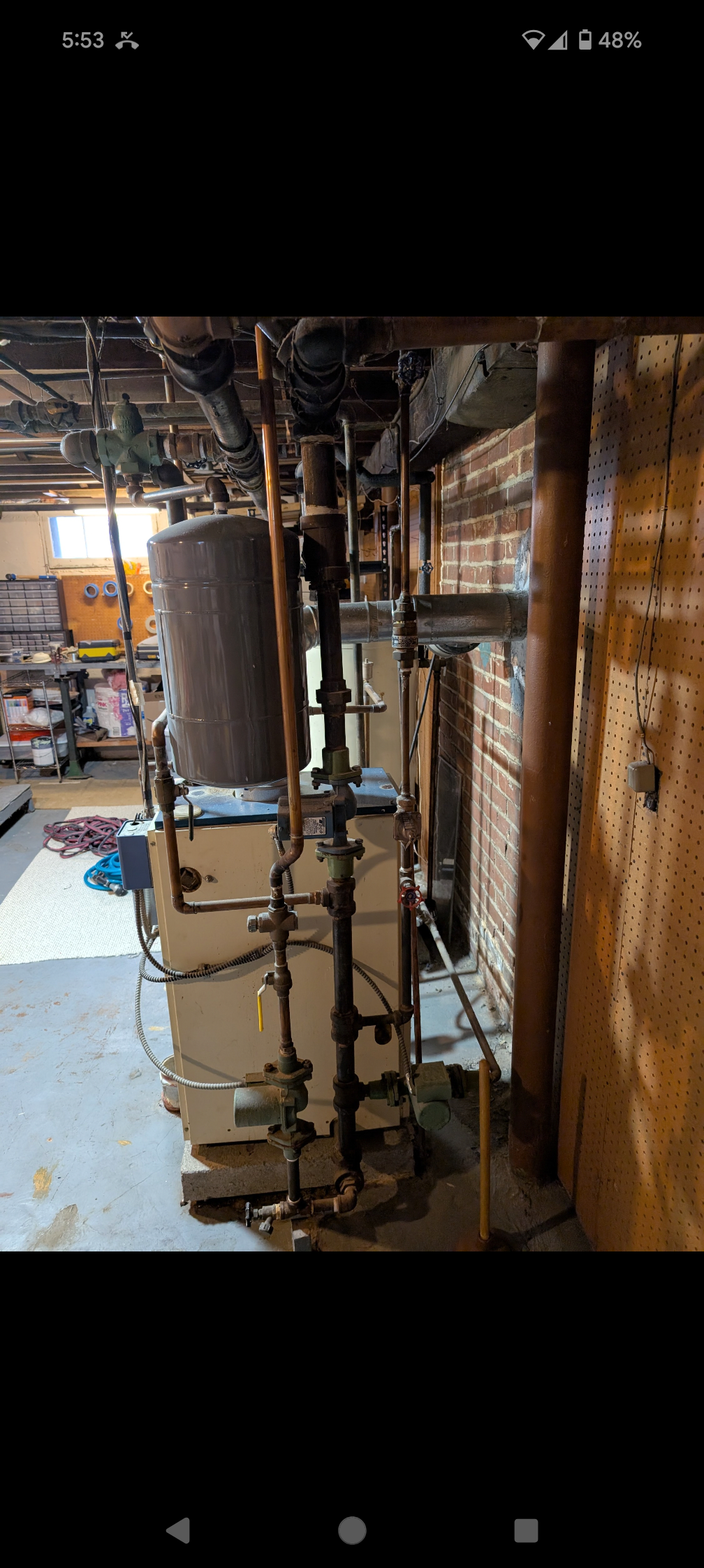

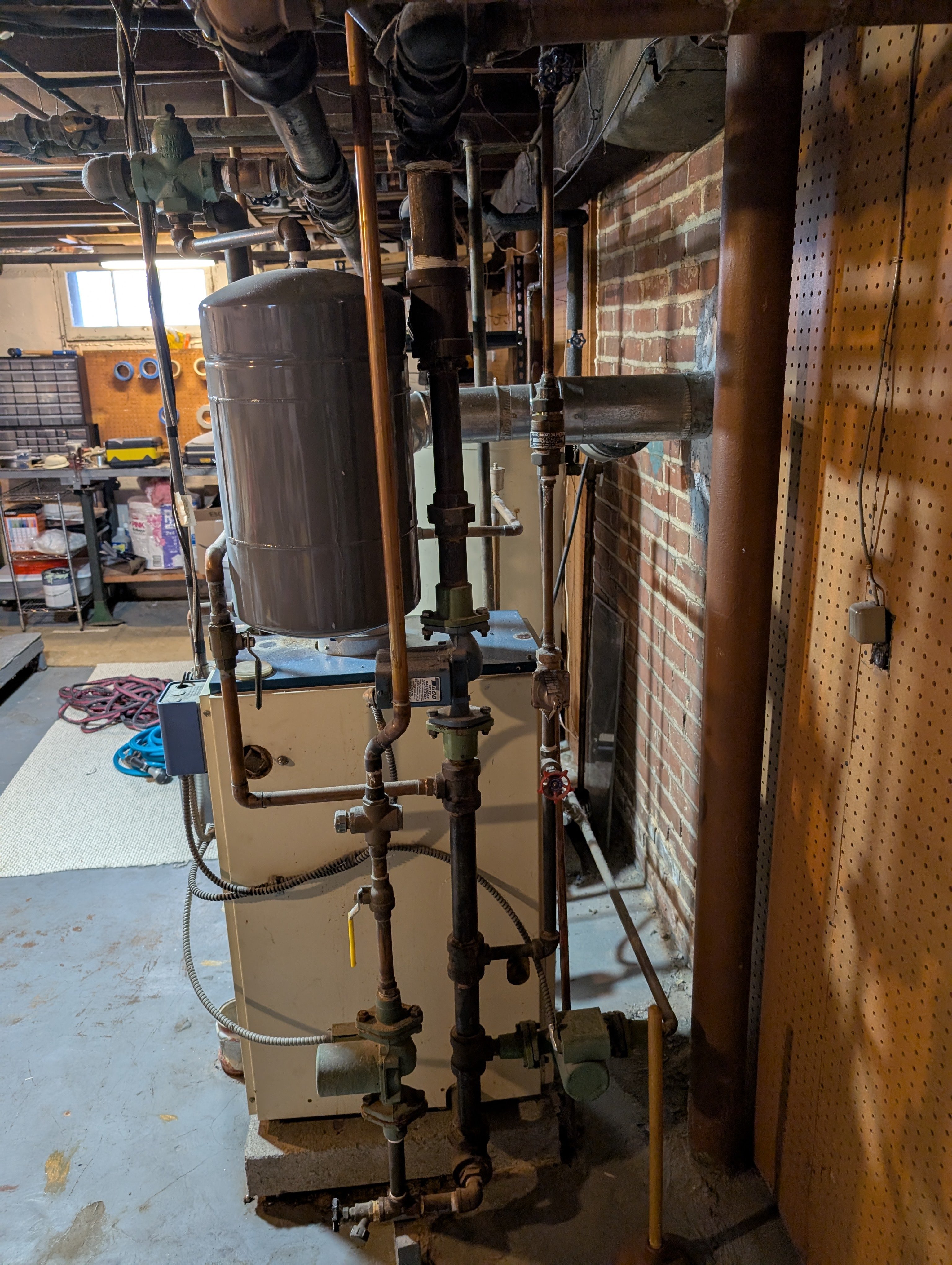

Another question I have that's related to the job, this is a old steam system that was converted to hydronic, I am trying not to drain the system fully do so this job because I fear it will be a nightmare to purge all the air. Has anyone had an issue purging air from systems like this? Any tips?

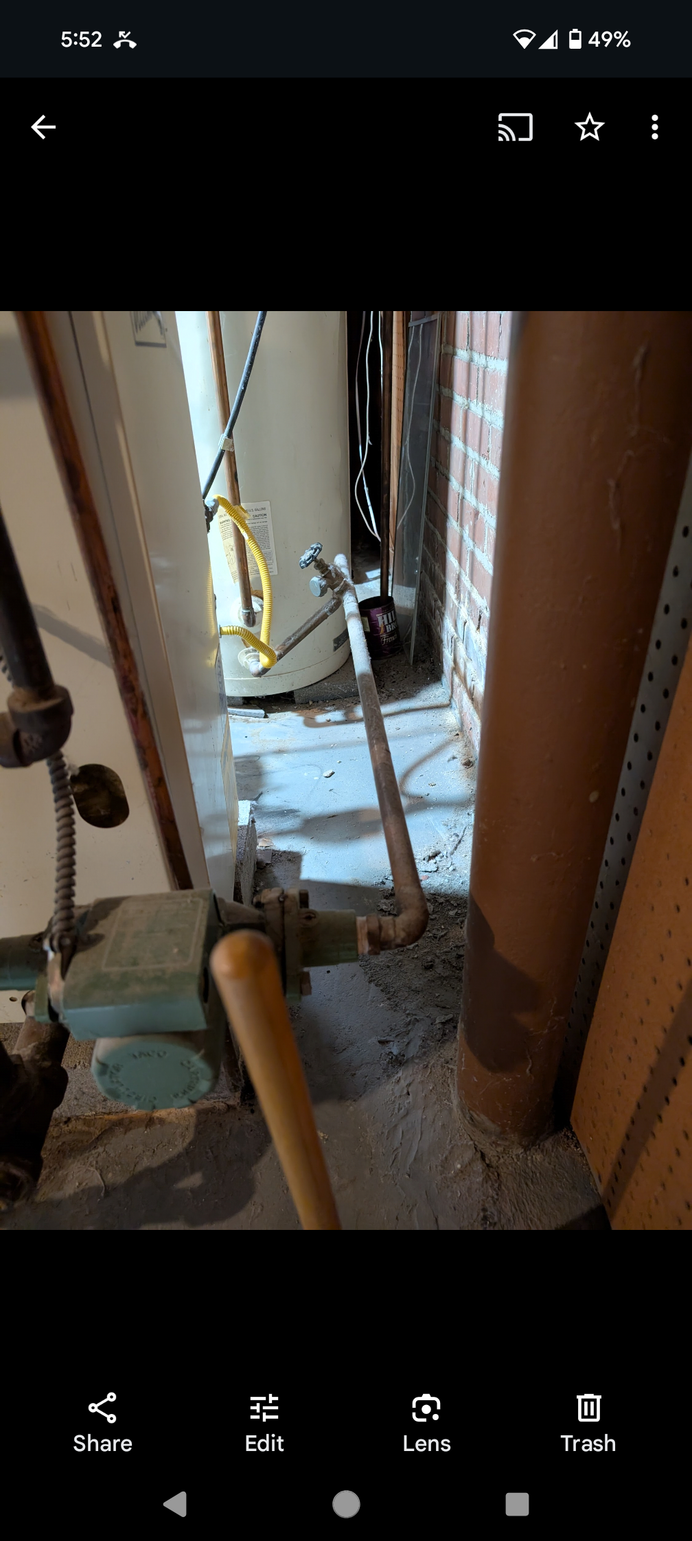

I am hoping a jet swet may fit into the 3/4 nipple attached to the flange and I may be able to swap out the old flange and close it with a valved flange with out draining the system. I can isolate the supply but not the return.
Indirect swap out *

The problem with having a valve on one side of a loop and not the other side makes it impossible to open the system without draining the water above the point where you want to do the work.
As you can see from this Performance chart, the 005 has a similar curve as the 007. it falls just below the 007 performance curve, that said the 007 would be able to do the job that the discontinued 005 pump can do.

I'm trying to avoid draining the system, have you ever used a tool similar to a jet swet to plug the hole to avoid draining the system?

Might be better to drain it and add isolation valves and a magnetic dirt separator or wet rotor circulators aren't likely to last that long on that system.
Thanks for all the comments. I did not know that was a valve. I have only seen the newer style circ flanges with isolation valves. I am going to soak them before I try and open them.
I will recommend the dirt separator as well, Thanks!
The job went smooth. Thank you for all the help. The existing flange worked and held. You guys are great.
