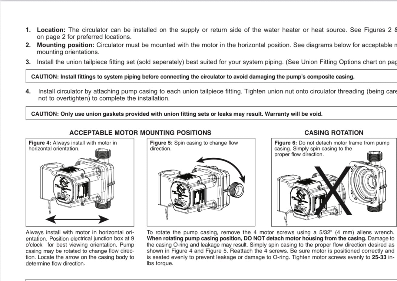

    Sorry about the slow reply. Helping to cater a wedding. Here are the boiler pictures:
  • gotgas
    gotgas Posts: 98
  • gotgas
    gotgas Posts: 98
  • gotgas
    gotgas Posts: 98
  • gotgas
    gotgas Posts: 98
    No error codes. I have not discerned a pattern. Incoming temp is approx 54F year round. Boiler heat side is fine, no problems. I will check the filter. We piped the whole house so I am pretty sure there is no crossover.

    hot_rod Posts: 28,699
    spin that Taco pump when you get a chance
