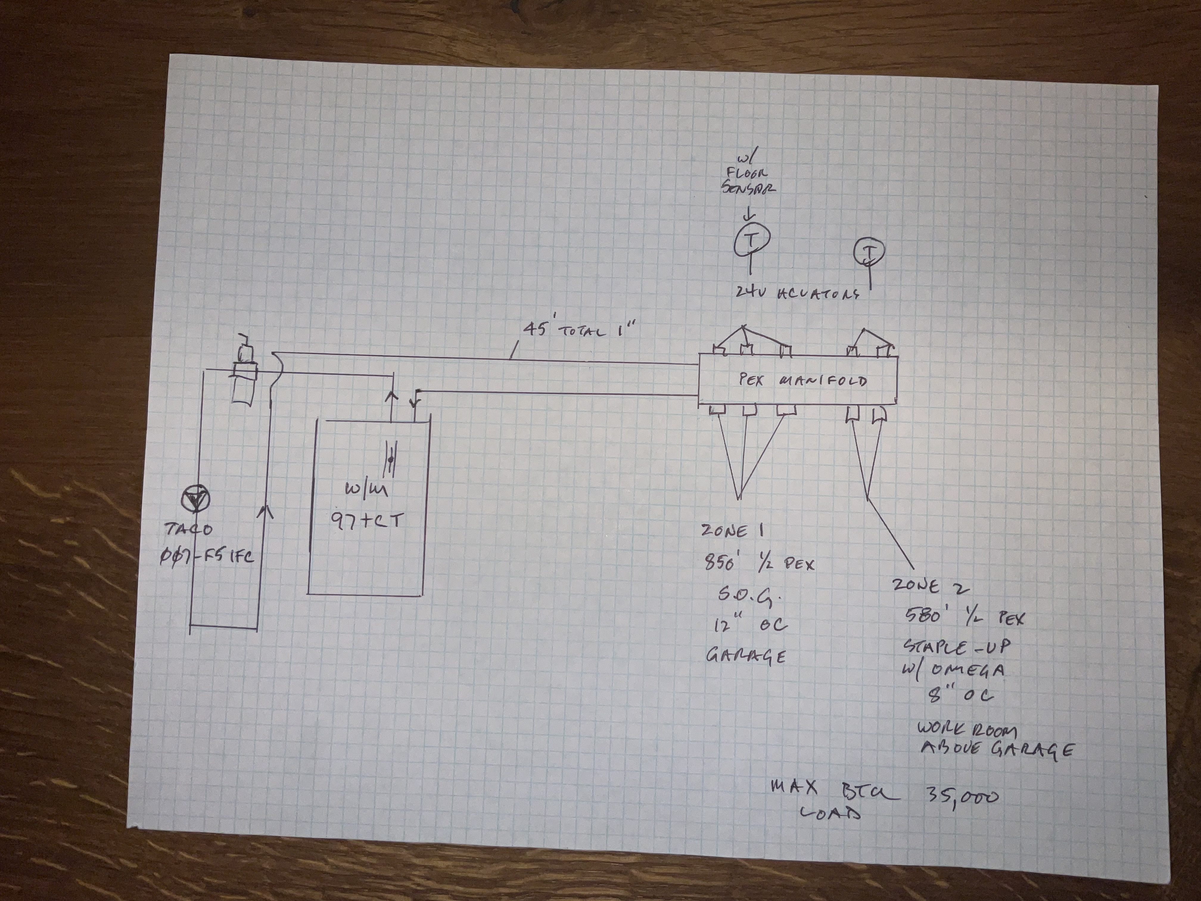

    Bob, yes see attached.
    I think I should stop getting hung up on boiler temps (6* delta)
    sitting here on a 4* night, Thermostat & room temp 65*, mid cycle:
    70% modulation ( progress bar)
    mech gauge at SWT ( top of boiler)- 107*
    Target T -118* ( makes sense with ODR of 70/0)
    boiler SWT -110. (@ manifold 106*)
    boiler RWT- 103 (@ manifold 88*)
    @ 4* OST
    meeting load fine, space comfy as hell, firing along at 70% speed
    Curious as to why the system 007 motor housing temp is 150* while the same 007 in boiler is 132* if they are pumping the similar temp water (and head is not that high for system circulator) ?
    Looks like I am in good shape .
    Thanks again everybody for the time….
