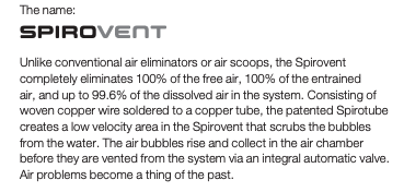

    Unless you adapt a microbubble air separator to send air back to the compression tank, the airtrol boiler fitting won't do as good a job of moving the smallest air bubbles out of the flow. It will still flow but there will be some pockets of air that won't get removed they way they would with a microbubble separator.

    That's how B&G specs it now. IAS /EAS to Airtrol. They don't even sell Airtrol boiler fittings anymore. WM has an air sep built in, I think Peerless too.
    jesmed1
    hot_rod Posts: 28,699
    The small micro bubbles go in an out of solution every time the flame hits the boiler wall.
    The ramp purger or a single boiler section doesn't have any means to capture and remove those, almost invisible bubbles.
    With todays thin metal boilers it is more important to remove all the types of air for efficiency and longevity.
    No harm in doing that with a cast boiler also. If a goal is to maximize efficiency and limit corrosion.
