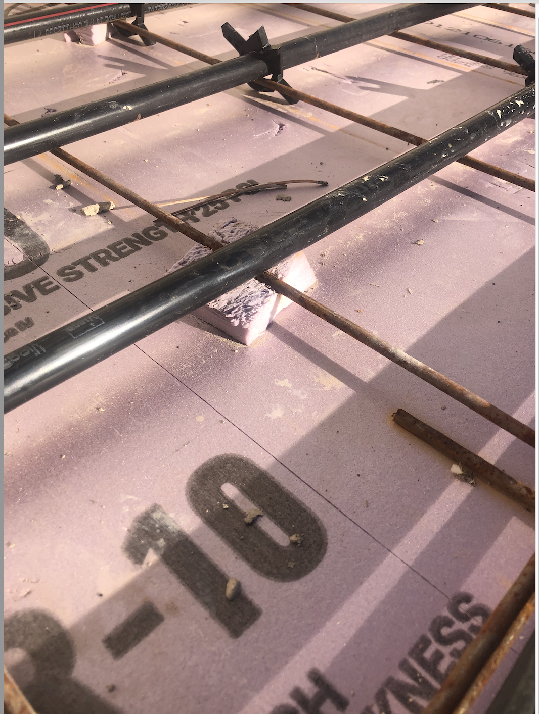

    I recommend all slabs get the tube installed 6" on center. Keep the tube 2" below the top. This allows for the lowest possible supply temperature. So you have high efficiency boiler or heat pump compatibility.
    Use a 6X6 mesh for to tie the tube down.

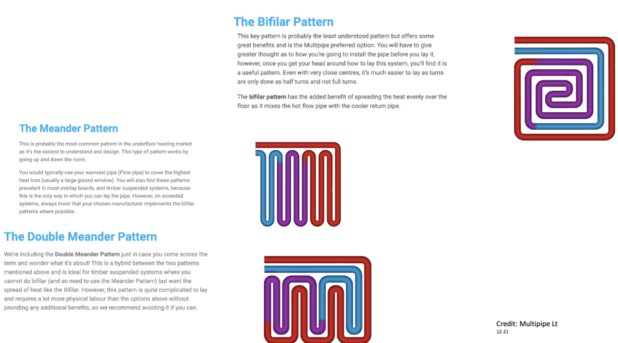

    Here are some tube layout options. The bifilar is a nice pattern, not so many 180 turns to tie down.

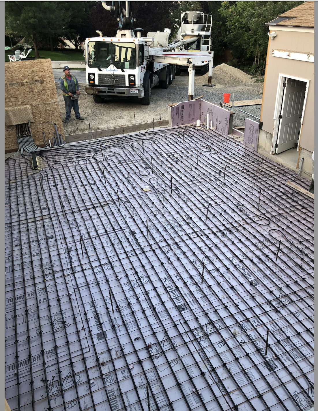

    Also pics of my shop with 6" tube spacing.

    2" foam, closed cell like Owens Pink or Dow BlueBoard.
    The edge insulation is a big deal, and if it is a slab on grade that is a tricky detail to cover the top edge. Usually a metal Z flashing under the siding to cover the top edge of the foam. Then edge foam should go down to frost level. May be a detail in that guide.

    Take pics of the tube layout for future reference. A drone is great for that.

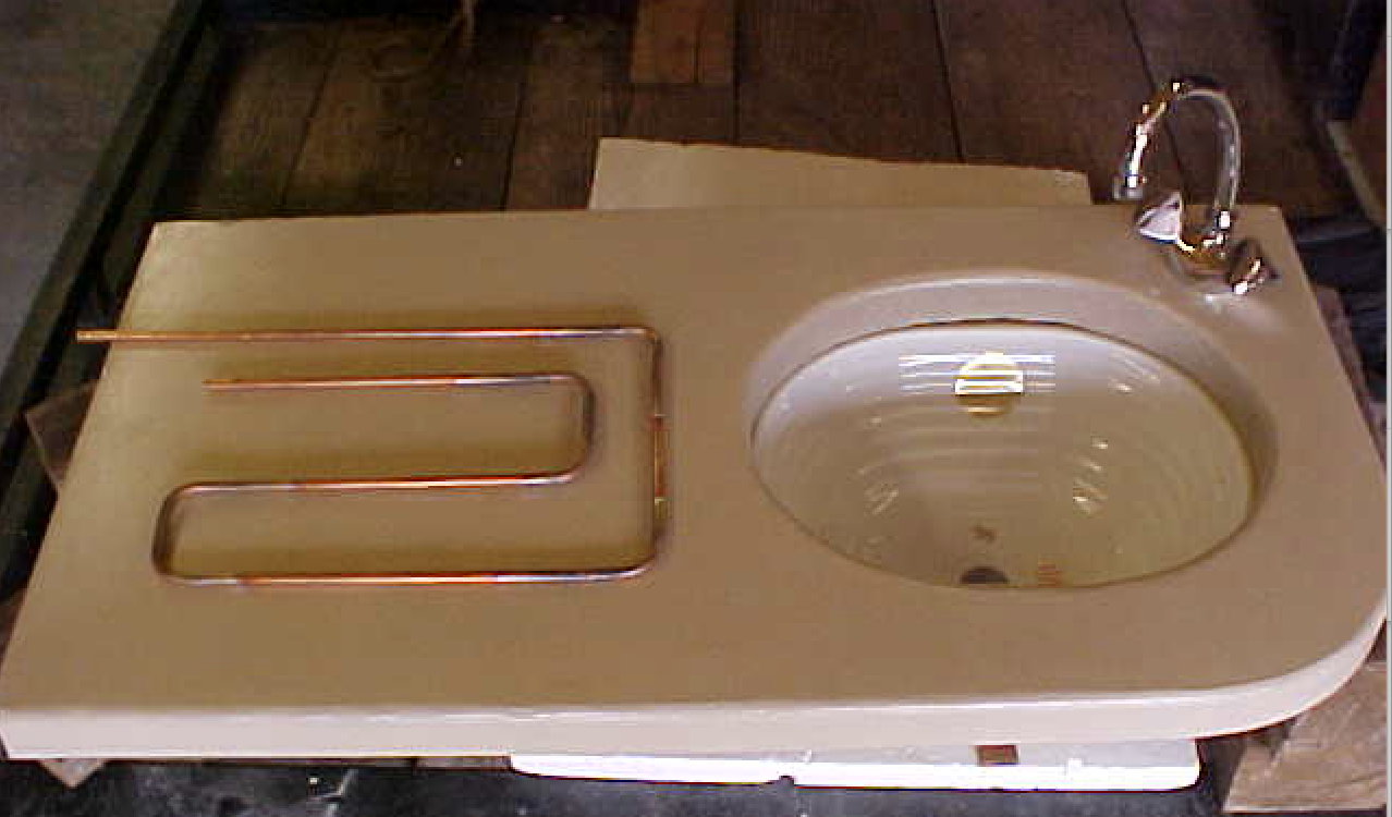

    Panel radiators are a radiant system also. The move the heat to any object in their line of site. Easy and fast to control, some really creative designs. I put radiant in my concrete counter tops :)
