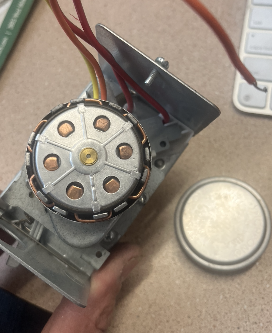

    Thanks for all the advice from the community. Just to close this one out, the issue was with the gunk build up (the dark viscous grease) in the gears of the motor, causing the motor to fail to push the valve open. I tried the "tear down, clean and rebuild" method, and it worked (for now). But in the end, I don't think it's a good use of my time (other than learning about the internal mechanism) and decided to order the replacement motor part (Honeywell 802360JA).
    @HVACNUT - For some reason, I detect 24v power on the yellow motor wires even when the thermostat is off. I even shut off the emergency shut off switch for the air handler, and I still get 24v at the motor. I don't understand how the motor recognizes when there's a call for heat from the thermostat if it's already getting power, but that is what I see.
    Not sure if it spins for that long, but yes I did see it spinning then coming to a twitching stop (spinning with my fingers).
    Anyway, even after I cleaned the motor gears (below), there's still a good amount of resistance when I try to spin it. I don't know how a new motor should feel, so I'll check when the new part arrives.
    Thank you again.
    hot_rod Posts: 28,704
    The resistance you feel is the gear reduction inside the assembly.
