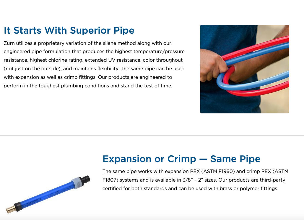

    That last sentence. I find very interesting. I don't believe Viega has distinguished between the "A" and "B" pex types? Was, or is it because they don't offer expansion? Probably. SiouxChief offered an expansion pex "B" that was "introduced" during covid. I haven't seen it since. Any insight?
    hot_rod Posts: 28,699
    I see several of the B pex now approve expansion fittings. Sioux Chief and Zurn are two.
    Intplm.
  • GroundUp
    GroundUp Posts: 2,573
    PureFlow is a Pex-B, per Viega. They have many studies and videos out there comparing their products to cold expansion/ Pex-A and it's quite apparent that they will not allow cold expansion with their tubing. I've personally run across a few instances in the field as well as ran a few tests myself using cold expansion with Pex-B and C with no apparent trouble, but I'd imagine under certain circumstances it'd fail prematurely. The Sioux Chief in particular, being orange in color, when expanded turns white which looks very sketchy but it seems to hold just fine. I did the same with a chunk of cheap BlueFin tubing and it also turned nearly white, but the sidewall of the tubing blew out before the expansion joint did… Technicalities, I suppose, but the point was that Viega does not approve expansion fittings for their tubing.
