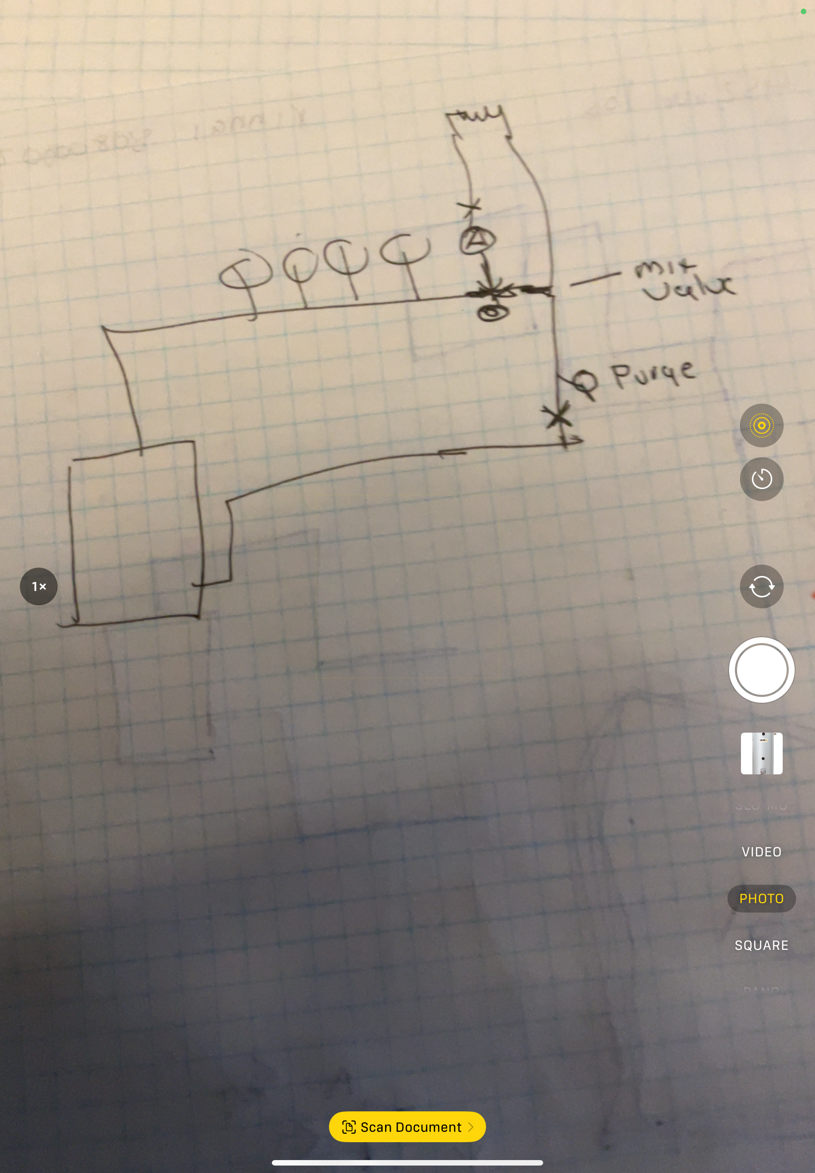

    Getting back to adding the mixing valve, do I add it between the manifold supply and the taco pump, like in this picture? Asking because most examples of mixing valve installation I found were on the main supply and the main return, instead of an individual zone supply/return.

    Mix valves like this
    @hot_rod Bob is trying to tell you the proper orientation for the mixing valve. By your diagram, I can see that you may not be completely seeing what Bob is actually illustrating when it is on your system. The Hot for that zone must go directly to the Hot in on the mixing valve. The Cold from the return must go the the Cold in on the mixing valve with a tee to the system return. The MIX from the mixing valve then goes to the circulator inlet. Caleffi actually has a valve made just for your situation as illustrated in the photograph below.

    Zoom in to the mixing valvearea to se the detail.
    Otherwise you will need a lot of 90° elbows to make it work like in this illustration:
    hot_rod Member Posts: 28,010
    In this suggested piping, remove the plugs at the end of the headers. The H hot port of the mix valve screws into the upper manifold. The C cold port of the mix valve gets a tee. The radiant return comes into the top of the tee, and the run of the tee connects into the lower return manifold. It just seems like the quickest, cleanest piping.
