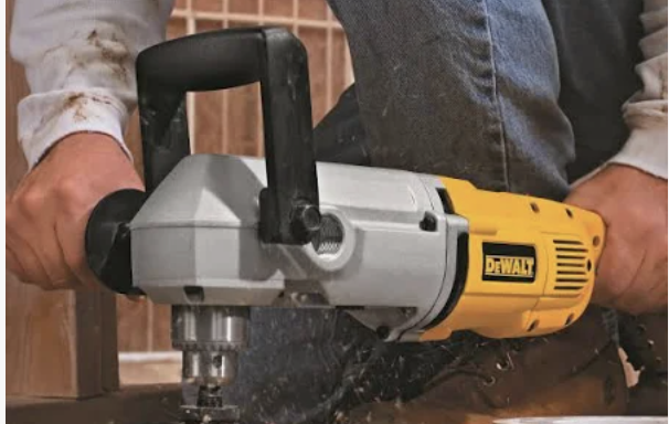

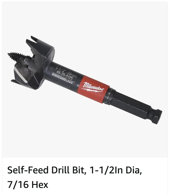

    This bit and one of these drills. Buy a small file and keep the "spurs" on those bits sharp.
    This bit works on TJI and dimensional lumber.
    You can drill a 1-1/2" hole about anywhere but use a drill chart

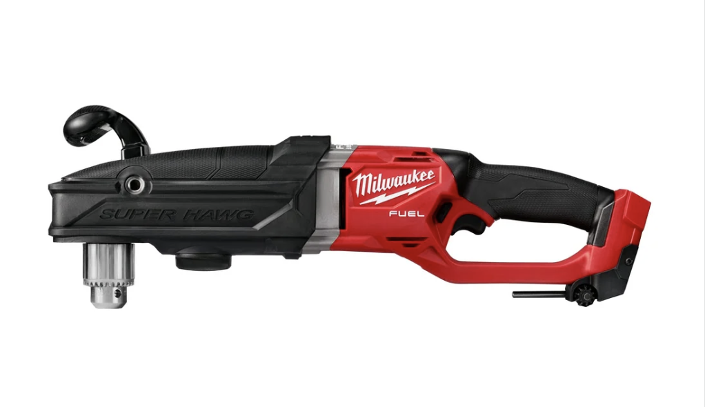

    I prefer a corded tool for a lot of heavy drilling. Probably rent one from a Box Store
    mattmia2 Posts: 18,233
    I love that style bit. I just used one to drill a hole in my rim joist for some conduit for a transfer switch today.

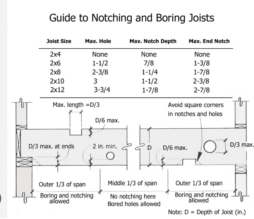

    I have tons of experience boring holes in joists and make sure to stay 2" from top/bottom and no more than 1/3 depth.
    What is your opinion of drilling 2 smaller holes, instead of 1 large hole, for when supply and return need to share the same space?
  • psb75
    psb75 Posts: 1,175
    I believe you are not supposed to bore below the center line of a joist. Two inches from the bottom is not good.
