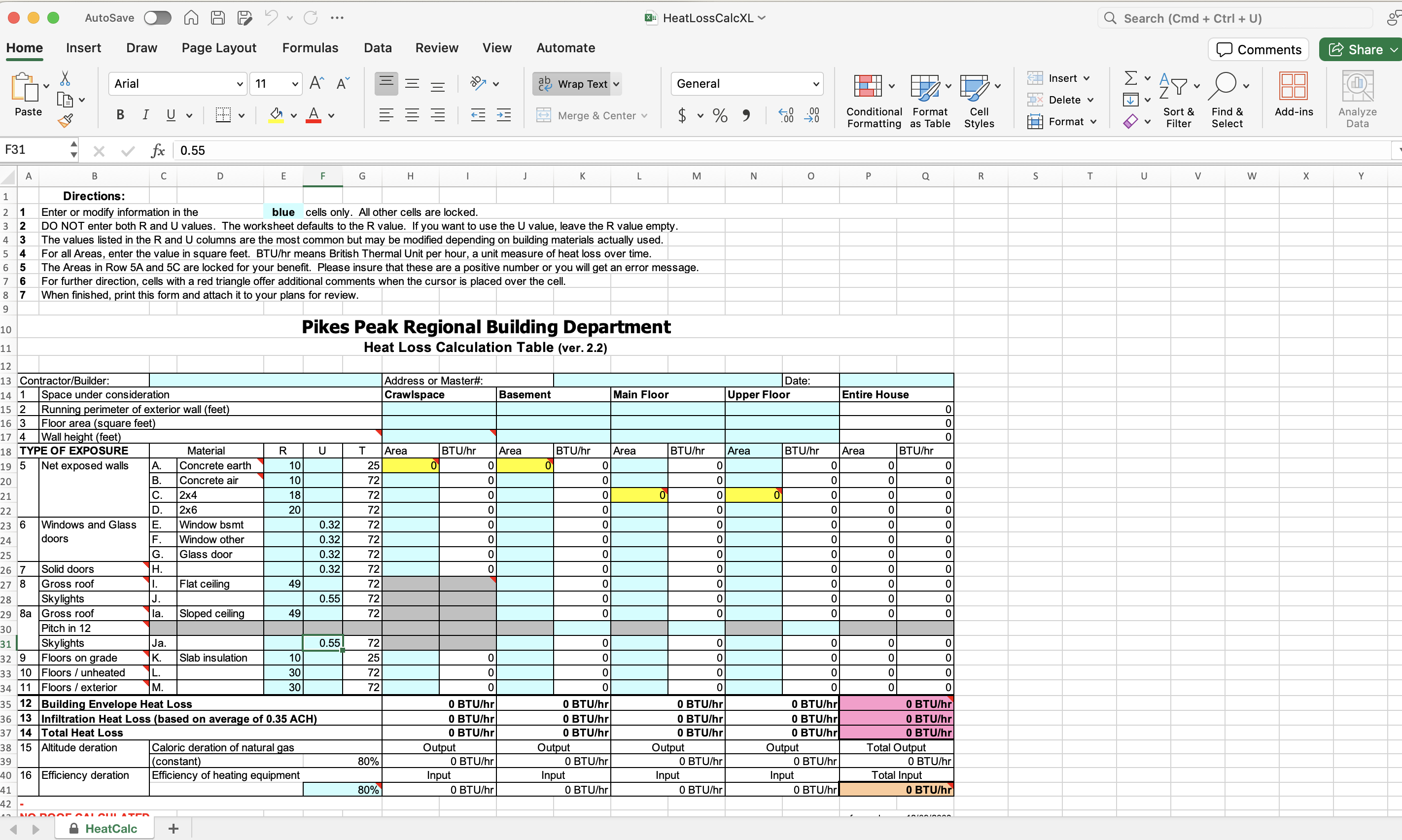

    Pikes Peak Building Dept has this Excel based load calc for download.

    https://www.pprbd.org/File/ByAlias/HeatLossCalcXL
  • MY wife and I spent the afternoon with a tape measure. All the room's exterior walls and glass area were measured along with square footage of the floor space. 1 thing I have noticed in a few of the calculators I have perused is the insulation factor. I built our home with 11" exterior walls and an abundance od ceiling insulation.
  • Bob, I am printing it out and will have a go at it. Thanks

  • The free download doesn't seem to work. Thanks anyway.
