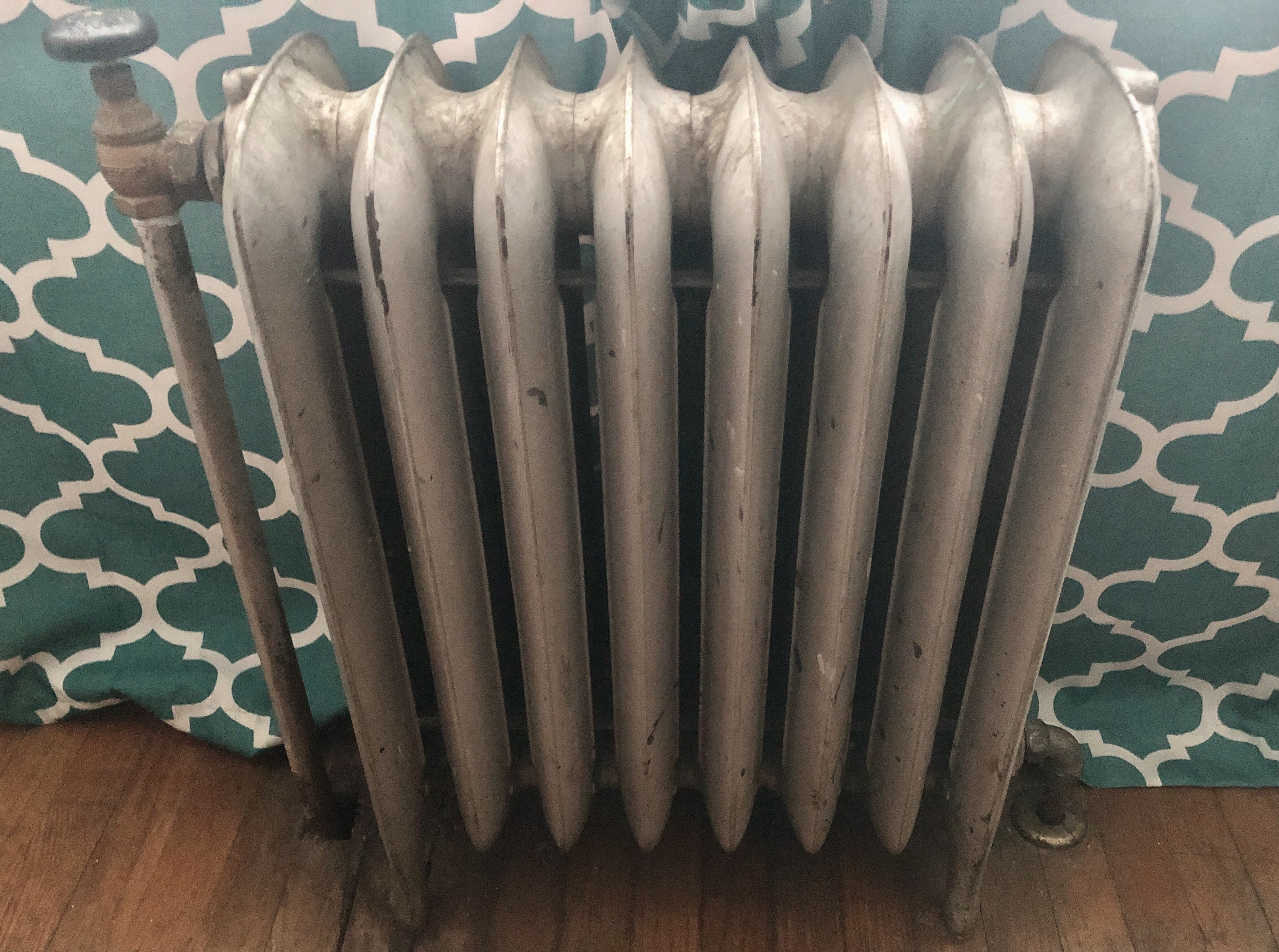

    Post a pic of a typical rad. Please show the valve and rad trap.

    @delcrossv thank you for confirming it’s okay. Btw attached is typical rad.
  • delcrossv
    delcrossv Posts: 2,204
    edited February 2025
    Oh dear! You have no traps! 😲
    What does it say on the side of your supply valve?
    Any markings on the elbow on the condensate side?
    We'll have to take this step by step. There'll either be an orifice plate on the supply side or the valve is a regulating one.
    You'll REALLY need a vaporstat now. You have a Vapor system. Upside is you won't have to worry much about your B dimension at the pressures this operates at.

    @delcrossv i thought it was at the bottom inside the last elbow for return. Here is a closer shot . Will need to add them if there are none, which I was going to do anyways given the age. Should I add on supply side or return side and which valves would you recommend? Also pressurtrol not vaporstat. Was going to run on lowest setting.
  • delcrossv
    If the supply valves work, I wouldn't mess with them. It will be a considerable expense to get trap bodies for all your rads and you'll have to find a new body that will fit where the elbows are now. I strongly recommend a vaporstat- you can get a mercury switched one off ebay for a pretty reasonable price.
    Any writing on the valves and elbows?
    Long Beach EdNoah_1
  • Noah_1
    Noah_1 Posts: 44
    @delcrossv i would take out the ones in which radiators did not heat after lowering the pressure. I couldn’t make out anything on the valves. I guess the only way to find out is to open one up and see if a valve is in the orifice.
  • delcrossv
    With those radiator elbows on the condensate side, orifices are pretty much guaranteed as the original regulating valves look to have been replaced. If you're curious, you can open the union on the supply side valve to see if there's an orifice plate.
    In any event, there's really no reason to add traps to each radiator, ($$$) when the system will heat fine provided the pressure is kept low.
    At the correct pressure range, the orifices will only pass enough steam for the rad to completely condense it before the steam can get to the elbow. Sweet spot is when 80% or so of the rad gets "steam hot" at max output. If the pressure is too high, the dry returns fill with steam, the vents close and the system stops heating. Hence the vaporstat recommendation. 🙂
    Looks like a Kriebel system. Any idea when the place was built?
    Lastly, what's up with non heating rads, aside from the one that drained into the loop seal?

    I think you’re right about the type of system given the design…however, there is no vapor-vacuum controller near the boiler. Also the return side of the radiators may have bafflers on the elbows.
    From an operational perspective does this change what we previously discussed in terms of the piping and venting on mains and dry returns?
  • delcrossv
    @Noah_1 No, you're replacing the vacuum controller with vents. Basement pipes should be as we discussed.
    The system should work fine if:
    The inputs on the rads are metered so you get full condensation and
    The pressure is low enough so that can happen without losing your water seals
    For the rads that were disconnected, were any orifice plates found? Do you see a check plate (baffler) in the return elbows?
    Important:
    Is the new boiler already bought? Reason I'm asking is the effective EDR for this system is only 80% of the measured EDR (due to the metering and full condensation requirement). You may also consider dropping the usual 33% pickup factor to 10-15%
    Here's a table of orifice sizes I found here that specs sizes by EDR and pressure if you have to replace them.
    I don't think the table has the 20% EDR reduction built in.
