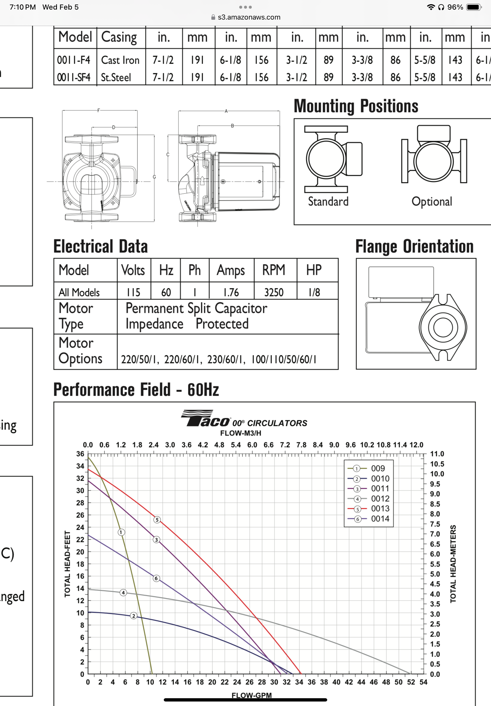

It's a 399k btu Natco boiler feeding an 80 gallon storage tank. the pump is a Taco 0011 Stainless. Prior pump was a Taco 0011 bronze. Boiler is probably 20-30 years old. Water pressure is in the 80s. They do get some hammering from the machines.
I called Natco who said the 0011 should work but a 0012 would be best. They're looking for 17-20gpm at 10-14'. He doesn't think that it would make the pumps go bad though.
Any thoughts? Part of me wants to blame the pump sizing but it worked that way for many years. I'm thinking maybe the heat exchanger is getting clogged with calcium after many years of heavy use and wrecking the pumps.

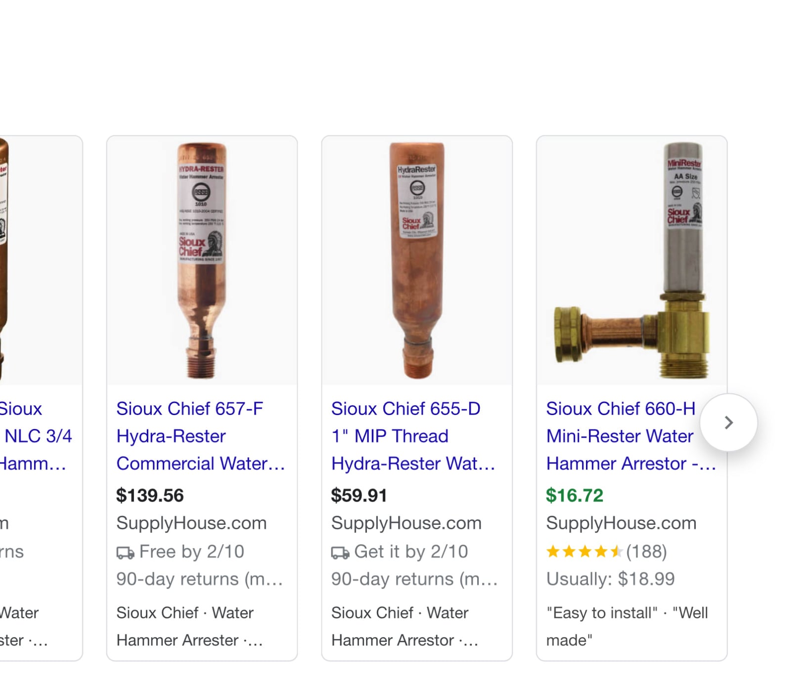

    Any application with fast closing solenoids needs water hammer arestors. Maybe one at the end of the supply to the machines. High flow rates and high pressure against a fast acting valve are a big concern.
    If you have arrestors they could be damaged
    You can get arrestors that go on the individual hose connection, or a large size to cover multiple machines

    Ideally, according to Sioux Chief, the arrestor should be at the device that causes the hammer. You need an air pocket to absorb the shock wave, catch it before it travels the length of the piping.
    So they make mini arrestors for washers, icemakers dishwashers, hose bibs and whole building type.
    Water hammer can also cause BFDs to spray, the dual checks at boiler fill valves are susceptible to this shock wave and the droop below static is what causes a quick spurt.
    Some installers claim a swing check upstream of a BFD can catch and break the shock wave and protect the BFD?

    I would not install 40 arrestors either. A large one at the end of the row of washers might be a good placement. Close to the machines as possible.

    The difference in a 0011 or a 0012 at the specs from Natco is very minimal, however, once you get away from those design numbers, the difference between the two pumps is drastic. If the system is scaled up, head loss has increased, the amp reading like Joe mentioned tells alot.
    Changing to a three piece circ at those numbers is also fine but rather than keep replacing or changing circs, we need to diagnose why. To keep doing the same thing to expect different results each time is not helping the situation.

    I got there today and replaced the pump. The amperage is slightly high, 1.95 and settled to 1.85 reading, 1.76 rated. The pump was is the process of self destructing. The water leaking onto the floor was making its way into the windings then out.

    I did order a couple hammer arrestors. I'm going to put on the lines where they come downstairs about 15' from the hot water system.

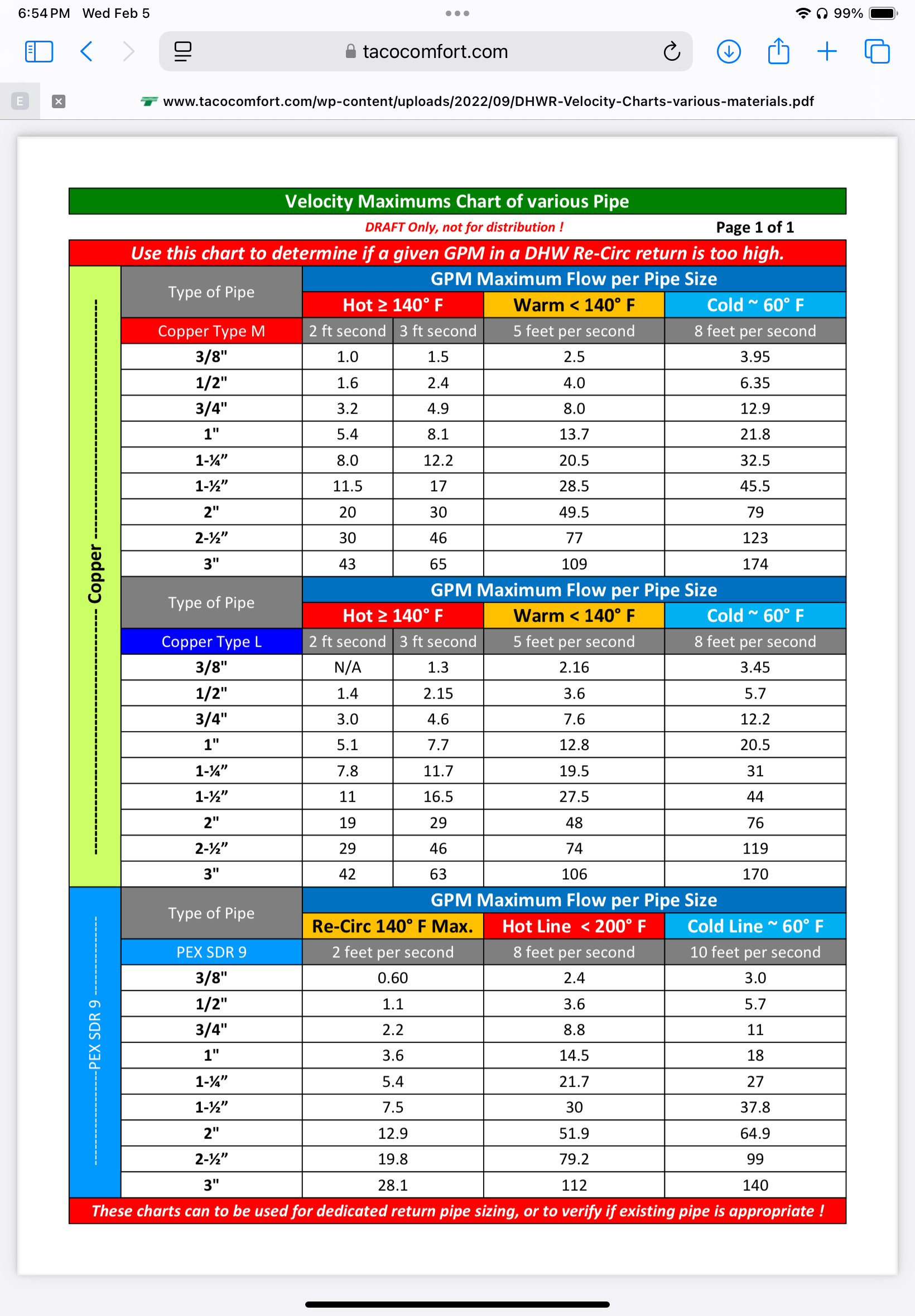

    what temperature is it running? The hotter the water the more aggressive. Water quality along with high velocity and hot water, over 140 will wear out copper tube
    The copper tube association suggests 2-3 gps if the water is above 140 F

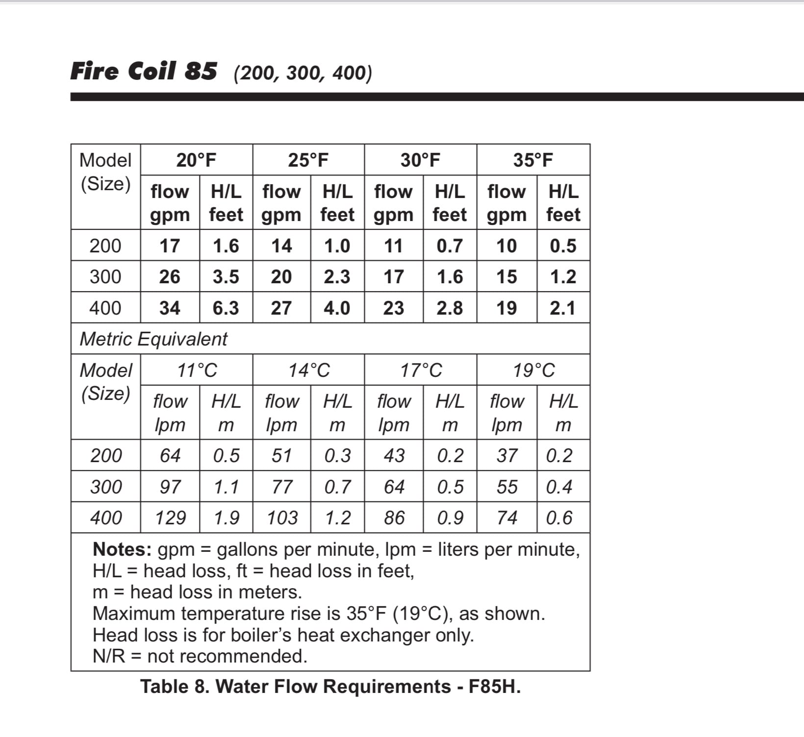

    Any idea what the flowrates is or what the boiler manufacturer requests? Here is an online example of velocity/ gpm. I would guess 2” minimum.
    Tube pinhole is often velocity related. Reaming the tube is also important.

    here is the required flow rate on one of the Natco models. Look up your exact model to get the best info.
    Some pump info, once you determine the required flow. I would think a flat curve circ like an 0910? The boiler manufacturer would know best

    Water is not hard. Temp is 125. Changing the tube to 2"'and/or reeming it solved the issue. It does have an expansion tank. I was just throwing that out there as something else that has changed on the system trying to get the the bottom of this pump thing.

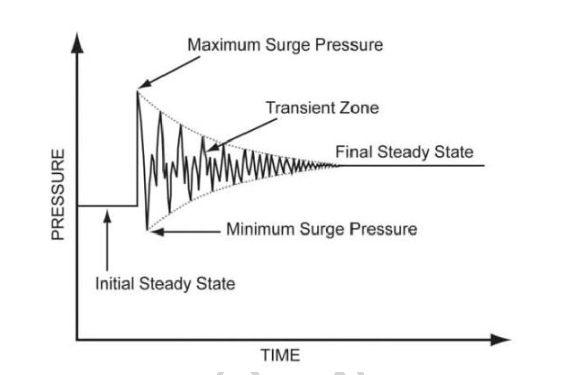

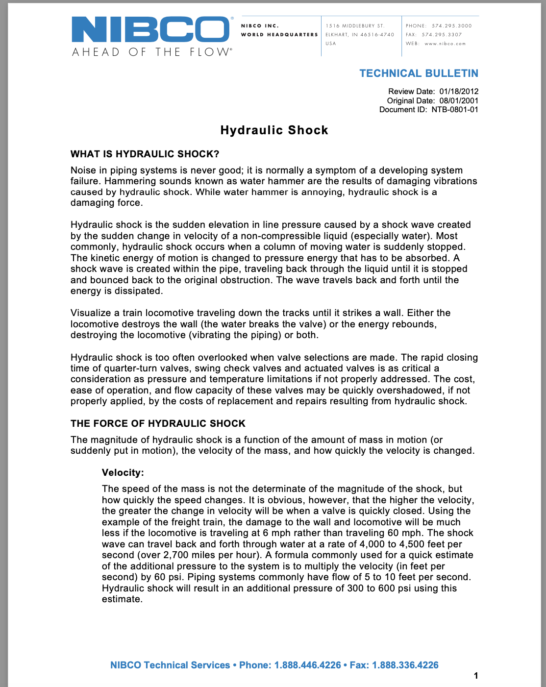

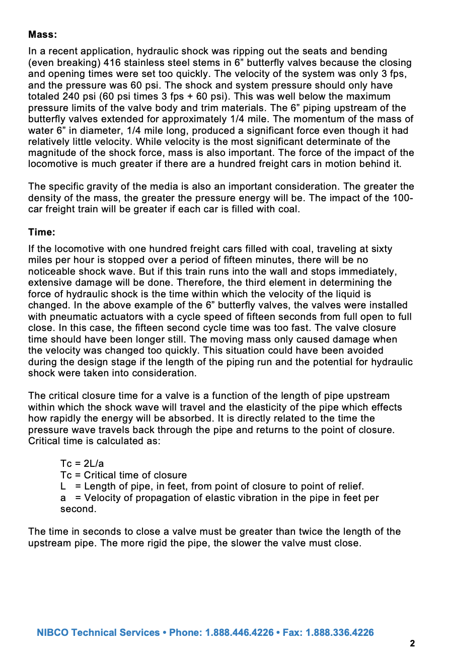

    I'm still thinking something like a 300 psi pressure spike, caused by a water hammer could blow out the pump cartridge.
    Some reading from Nibco on water hammer.

    I do still see is the new 0012 pulling double the amps it should be. This is better than what the 0011 was pulling so it's a start. Interestingly I put a used 0010 I had on to get them through the weekend. That pulled 5x its rated amperage. I'm thinking of tossing a gate valve on the line and trying to throttle it a bit to get the power draw in spec.

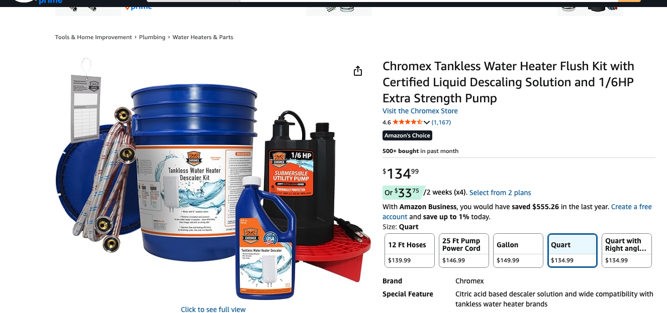

    Have you tried running a descaler through the boiler? If the pump cannot flow enough you are running it way up it's curve in an unhealthy condition.
    You need to try something other than replacing pumps.
    If you can isolate the boiler from the piping, add a few hose connections these descale kits work very well and quickly. No harm in flushing that boiler.
    And it is cheaper than a new pump :)

  • If you're pulling high amps and the rotor isn't binding then you're likely running way to the right of the curve. The left end of the curve is deadheading and has low amp draw because no water is actually moving. The right end of the curve is maximum power use because it's not making much pressure but it's making a ton of flow.
    Adding a valve on the discharge to force some discharge head for testing isn't a bad idea if its something you can do easy enough. I'd suggest using a ball valve over gate for throttling though. Watch your amp draw as you throttle it down. As you close the valve more, the amp load should drop because your shifting your operating point on the curve to the left.
