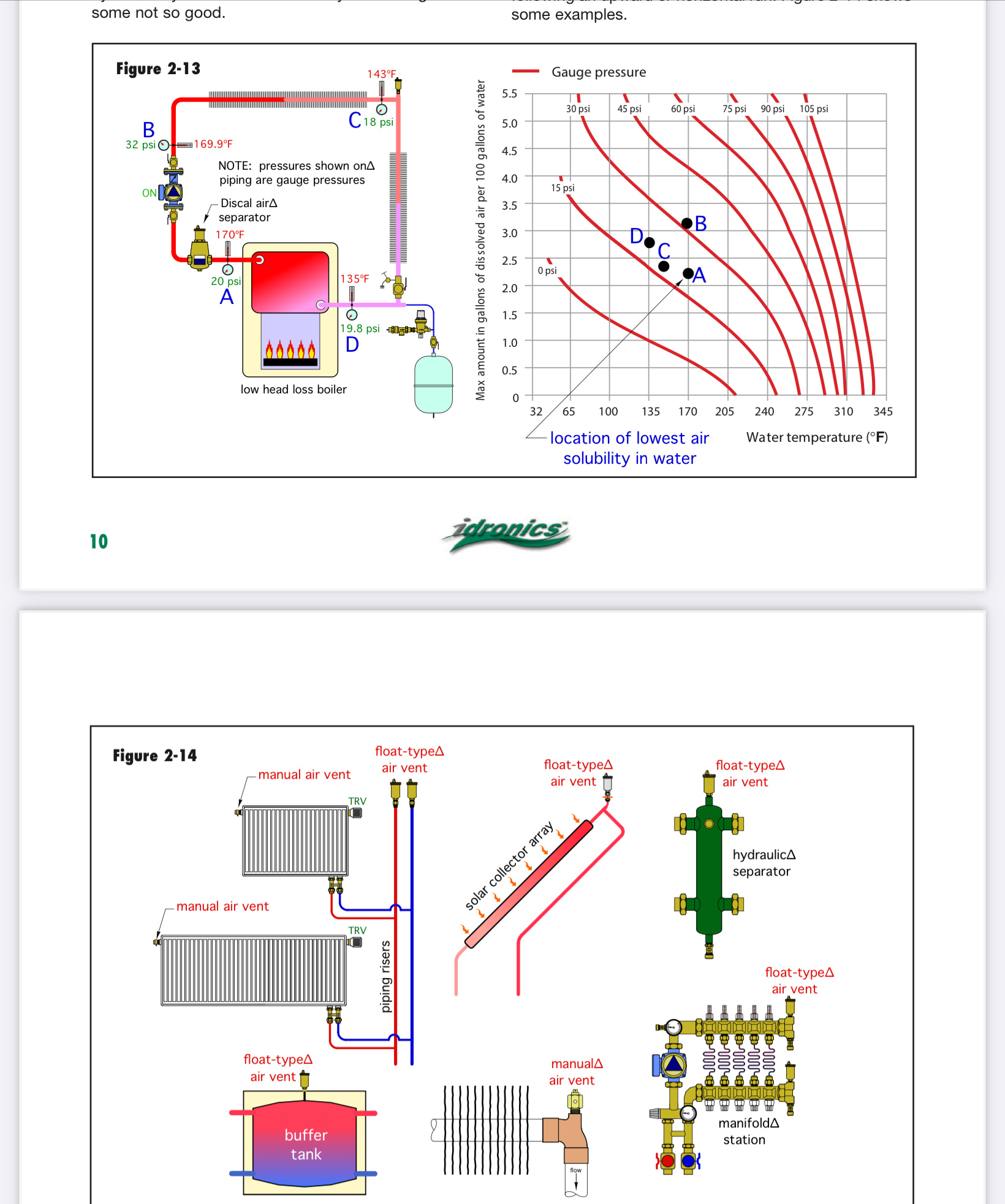

Location of the Honeywell supervent.
Hello all, I have in floor heating in my shop currently with the supervent right off the boiler. I'm adding a water to air heat exchanger to the system which will be at a higher point than the supervent. Currently, the supervent is at the highest point. My question is will I need to install another one at the new highest point?
you want an auto vent at the highest point, ideally.
It will work in conjunction with the super vent. Position C on the drawing
Living the hydronic dream0 -
That makes sense! Thank you. I see it shows it after one of the heat exchangers. I was going to put it before my only heat exchanger in that loop. Does that matter?
