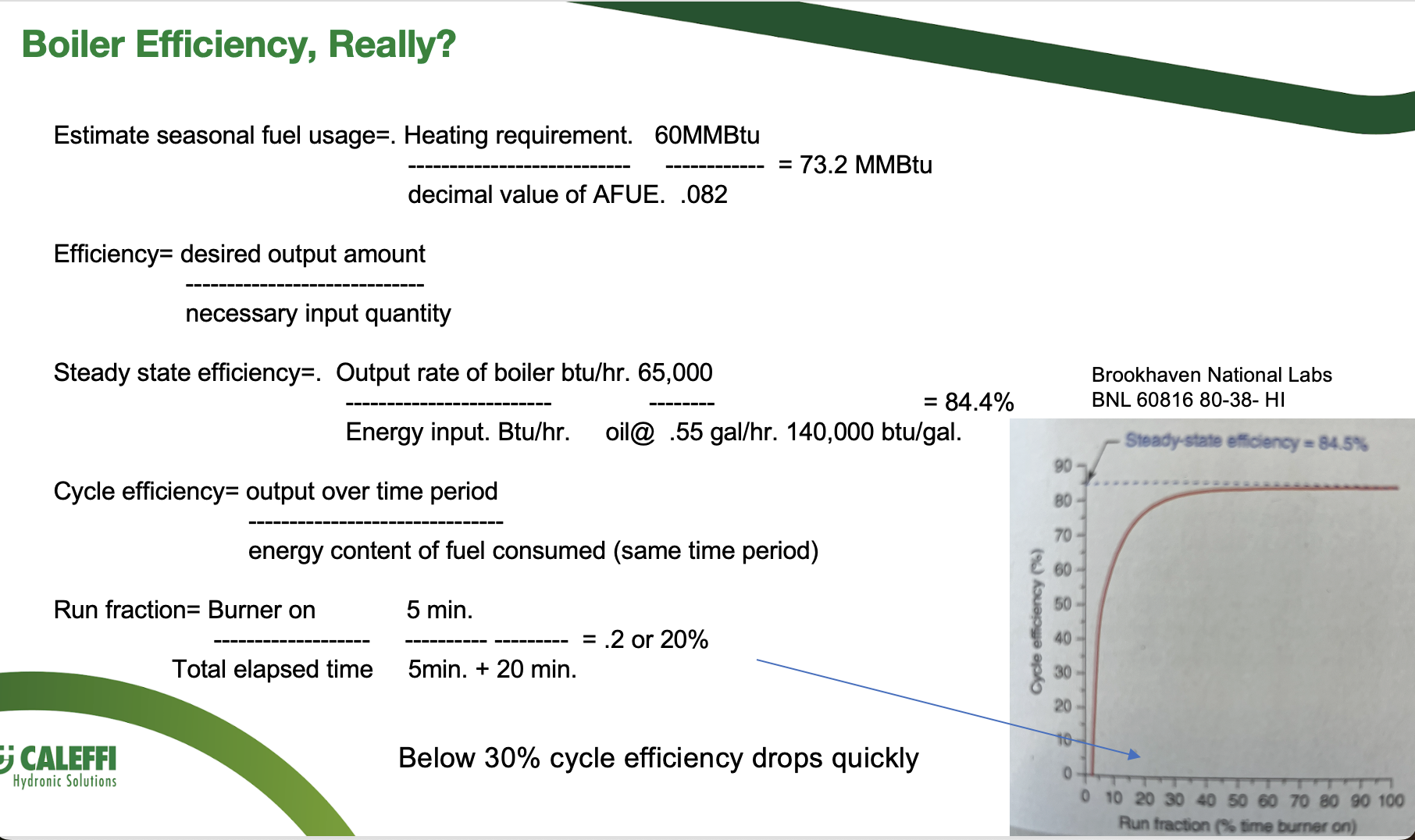

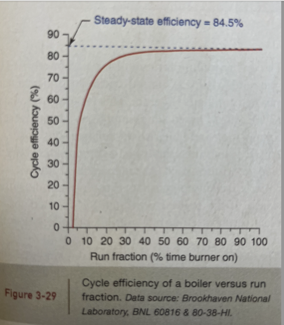

    hot_rod Posts: 28,524
    Your cycle efficiency drops off quickly however when you have low loads and less that 10 minute run times. So your boiler efficiency drops and fuel costs rise. Your 85% boiler can drop int the low 70% efficiency.
    You can throw your own numbers into the formulas. If you spend the bucks for for of the highest efficienct oil boilers, 20 plus year life efficiency, you want to maximize it's potential.
    Chapter 3 of Modern Hydronic Heating & Cooling 4th edition has a in depth explanation and example.

  • LRCCBJ
    LRCCBJ Posts: 1,043
    There is a solution for this and it is inexpensive.
    In the shoulder seasons, where the boiler might get down to below 20% run fraction, thereby seriously affecting efficiency, adjust the stat for a much wider differential. I've got the FHA stats set for an estimated 2°F and the run fraction is never less than 30%. In the shoulder seasons, it absolutely makes no difference regarding comfort.
    Some of the digital 'stats don't discuss differential. Just set 'em on the setpoint for steam. That will give the widest differential without explaining how they work.
    Additionally I disagree with the "run fraction". If I can have a boiler that runs for 12 minutes every hour, that would be a 20% run fraction. This would absolutely NOT be an efficiency of 70% as shown on the chart provided by Hot Rod. Now, if it ran for two minutes every 10 minutes over the course of one hour, with the same "run fraction" NOW you are talking about a severe penalty. These are two completely different scenarios and the offered charts are wildly in error because of this.
