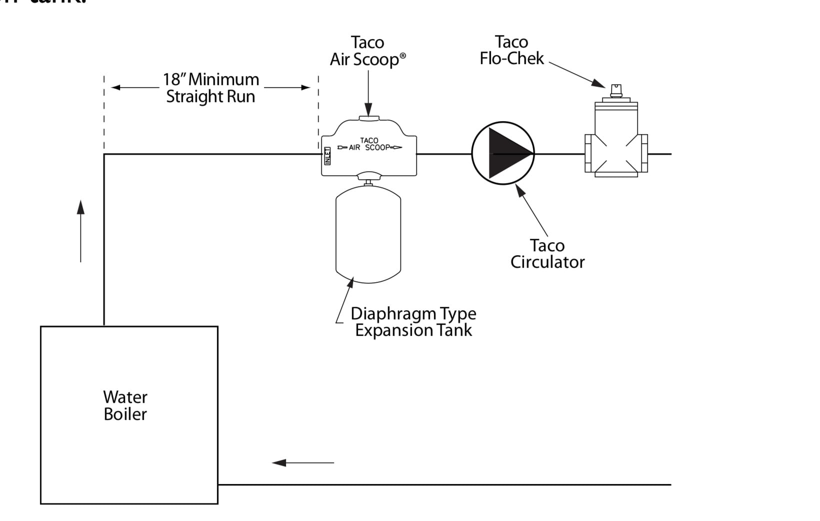

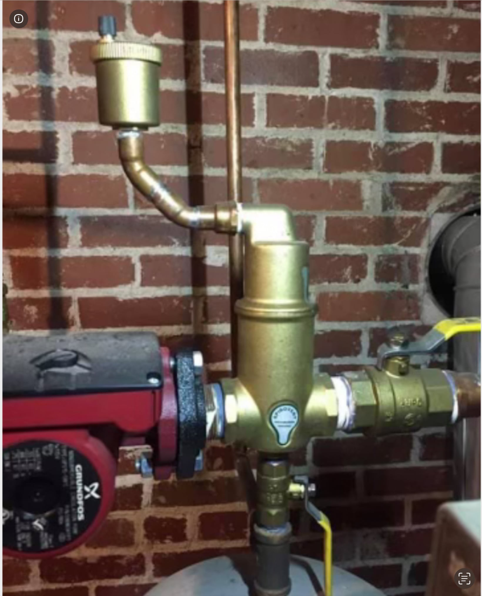

    I Personally perfer the Mircro Bubble type such as the spiro Vent especially when the Mechanical room is small/constraint…Taco Air scoops require at least 12" of straigth piping prior to it to work correctly

    The microbubble separator if located between the outlet of the boiler and suction of the circulator does a great job of removing the last traces of air that you can't purge or bleed out.

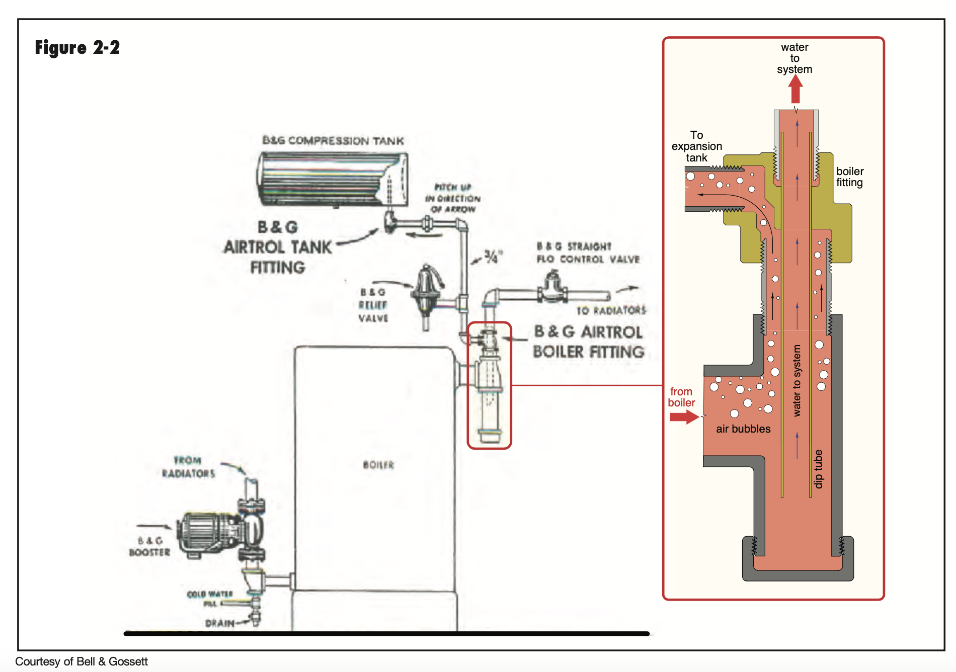

    Air scoops do not go bad, you can make your life a lot easier and not have any maintenance to do ever if you eliminate the bladder tank and connect the air scoop top tapping to an AIRTROL valve connected to a steel compression tank. A little more work but no bleeding of baseboard-ever.
    You can eliminate the air scoop and install an Internal Air Separator and connect it to the AIRTROL valve and strip the air bubbles out of the water as it is pumping away.
    The smallest B+G steel compression tank is 15 gallons and when it is installed with the airtrol valve it has a 5 gallon air volume and 10 gallons of water to create the point of no pressure change. The air bubbles that enter the air scoop or internal air separator rise up and enter the airtrol valve and are absorbed by the air blanket and the cool water in the steel compression tank falls down the cold water passage back to the system replacing the air bubbles that rise up into the airtrol valve.

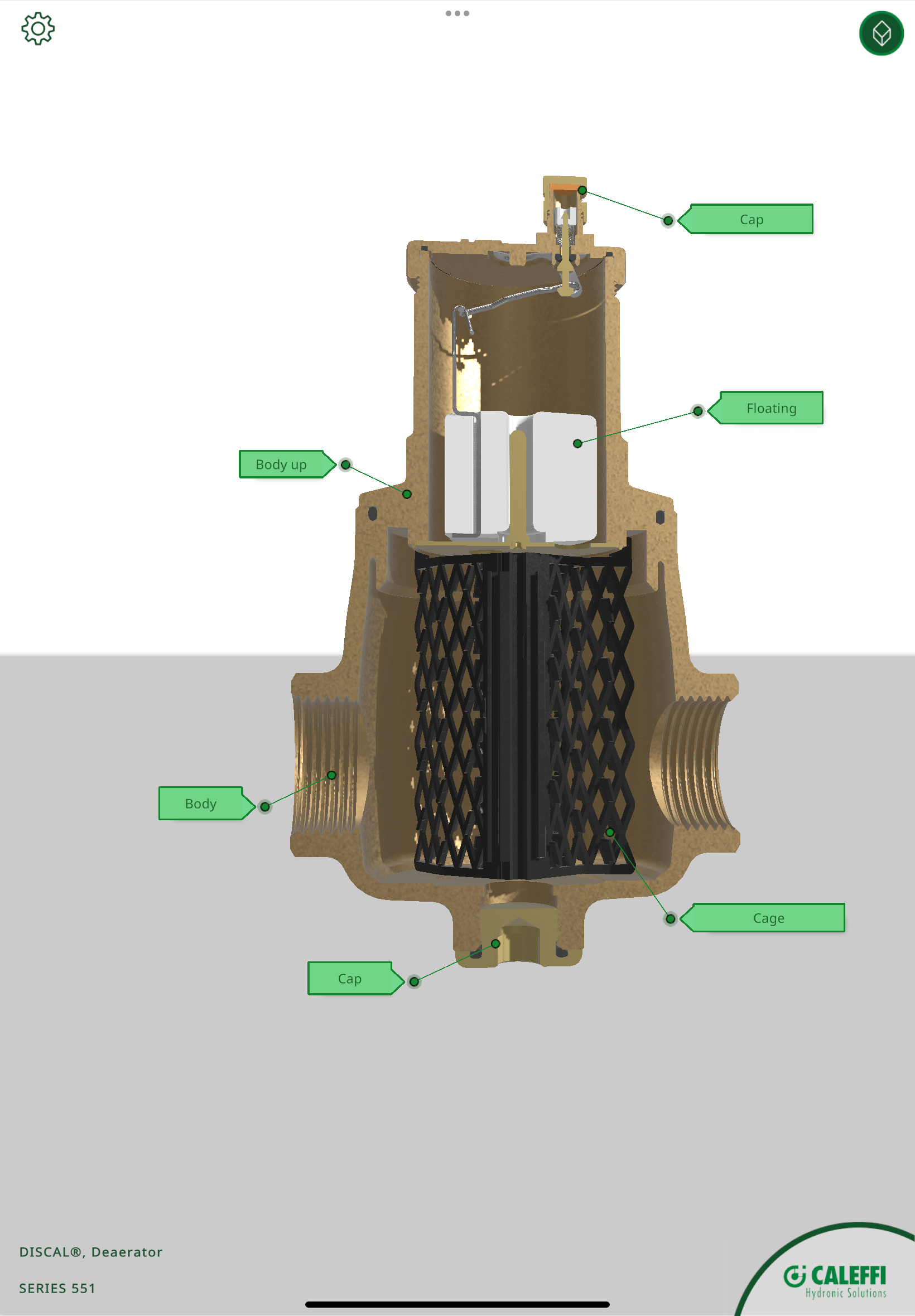

    The Discal has a large chamber for a low velocity zone, and a large non metallic media
    It can be disassembled at top, usually by hand, to clean or replace the float and needle valve

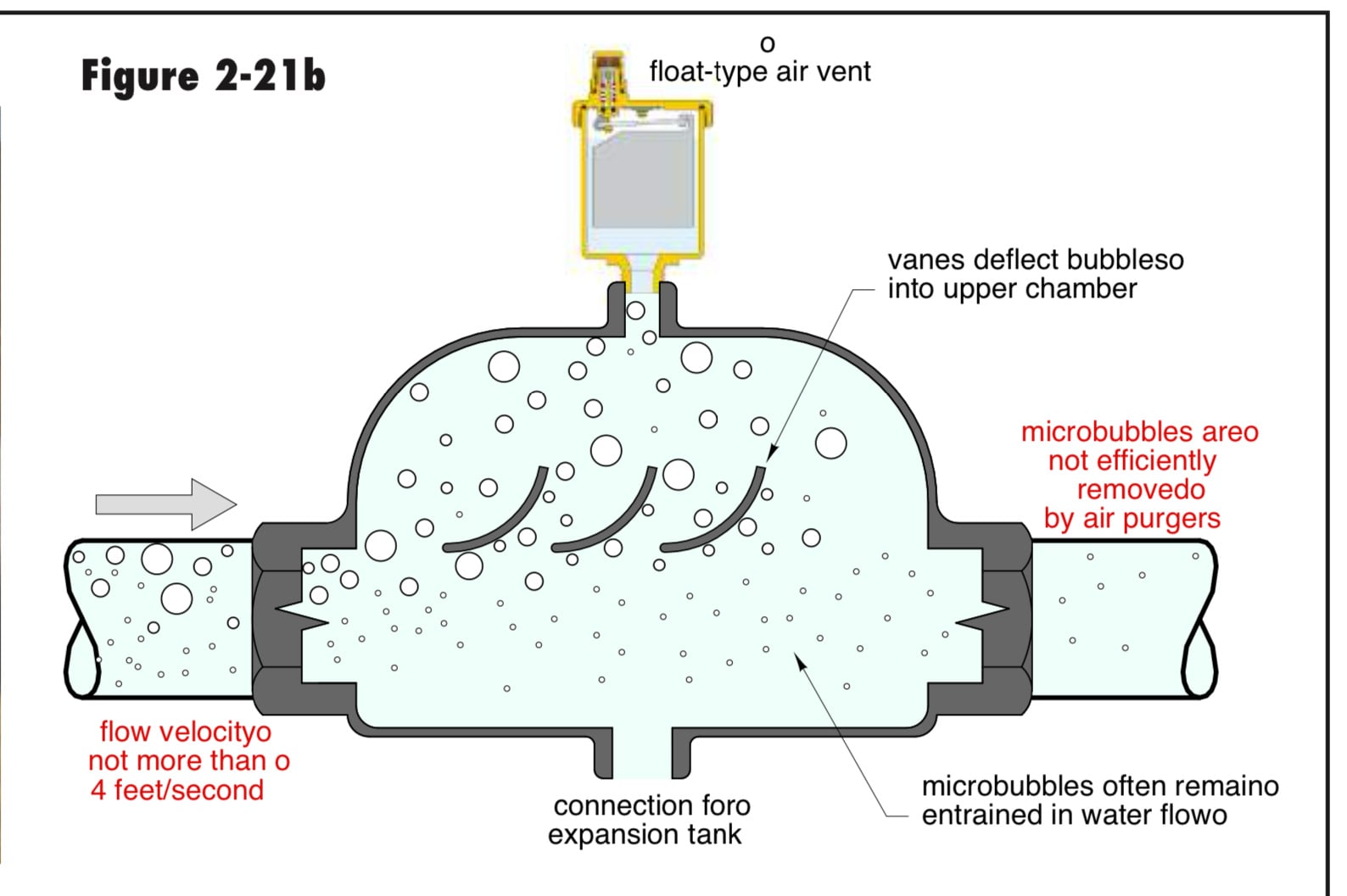

    hot_rod Posts: 28,846
    I’d guess from watching the job pic here, over the years maybe 1 in 10 air scoops are installed per the manufacturers instructions.
    I’ve seen different straight pipe requirements, most show 18-24” some use to show that dimension based on the pipe size. Some brands have scrubbed the required distance from the installation completely.
    Assuming you have 18” and velocity is below 4 fps which I doubt anyone confirms😳You still have no mechanism to grab the micro bubbles, some of which are smaller than the eye can see.
    Time was when the auto vent screwed into the top of the cast iron boilers did most if not all the air removal work. As such the purger became more of an expansion tank bracket.
    The small, thin metal, high wall temperature, high velocity coil type mod con heat exchangers really need and deserve a microbubbles device . But even fire tube and cast boilers get a boost in air removal efficiency and speed with air separators.

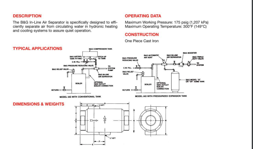

    Bob, I do not know how to do this, but do you have a drawing of the Internal Air Separator (IAS) connected to the airtrol valve and steel compression tank and a drawing of the air scoop connected to the airtrol valve under the steel compression tank that you could also post for the forum?
    Thanks much,
    Leon

    Yes Bob,
    thank you, they show how simple and effective the IAS, AIRTROL and steel compression tank are able eliminate air bubbles and maintain point of no pressure change AND also keep the weight of 10 gallons of water pressurising the system at all times eliminating any requirement for a bladder tank to create a point of no pressure change.
    The Internal Air Separator has a cast in place baffle that diverts any air bubbles upward through the top tapping and the air bubbles and micro bubbles rise into the Airtrol valve and dissolve as they rise in the water in the Steel Compression Tank. The cool water in the steel compression tank falls into the cold water side of the casting and sinks back into water stream being pumped from the boiler to the heating load.
    The IAS does seem to be more engineered than the basic ramp style. But my money is still on any of the microbubble resorbers for 97% efficiency.
