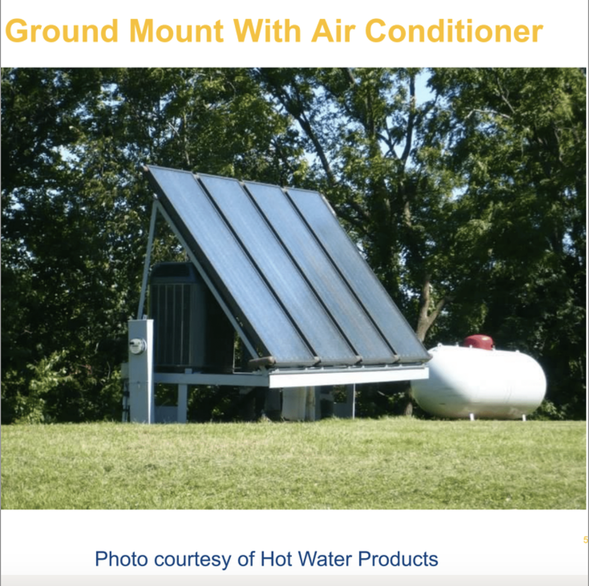

    hot_rod Posts: 28,699
    One 4x8 solar thermal panel with a 50 gallon solar tank might cover the DHW needs. A resistance element for no- sun days.
    If you could get the tank above the collector it could be a no pump thermo-siphon system.
    Here is an interesting ground mount ST in Wisconsin. The array shades the AC.

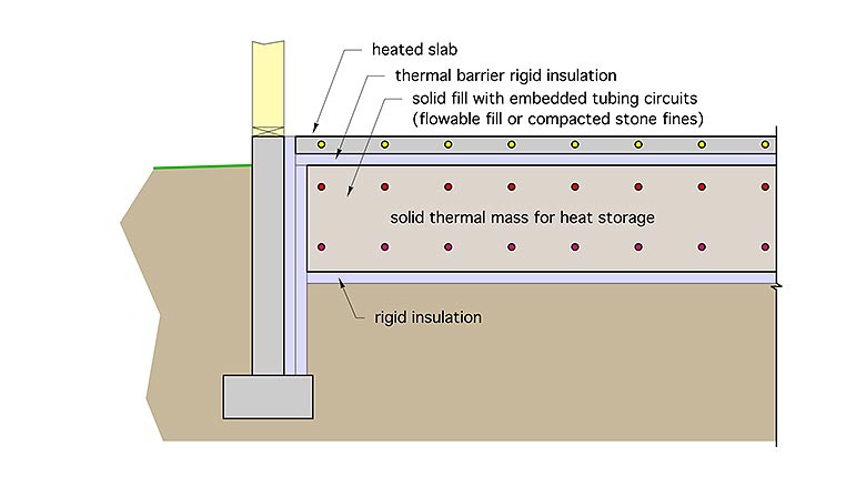

  • CDHE
    CDHE Posts: 23
    Have you considered a Solar H20 slab battery system? Ultimate simplicity, and enough heat stored to weather a long storm or power outage. These are simple systems without the need for limited life span "appliances". Electricity use would be minimal, so batteries could likely run the needed pumps for several days. Siggy has some useful info on the subject.

    DCContrarianneilc
    That is a bit more engineered Bob Ramlow sand bed storage concept.
    Bob has been promoting and installing sand bed radiant, throughout Wisconsin, charged all summer with solar thermal for maybe 30 years now.
    His systems are not top insulated, so they radiate through the winter at a bit of an uncontrolled rate
    Spending many years at the MREA event and meeting owners of these sand bed homes they love them, and learn to live with the idiosyncrasies.
    https://www.builditsolar.com/Projects/SolarHomes/SandBed/RamlowSandbed.htm
