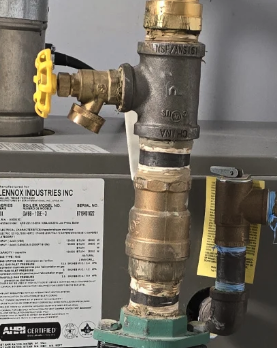

    A second purge point at the boiler. Close the large ball valve, connect hose to yellow handled valve. This will purge the loops through the boiler also

    But if I close the ball valve it will shut off the water to the yellow handle valve. It also interrups the system loop. Am I wrong? There has GOT to be a way to purge, but hell if I can figure it out.

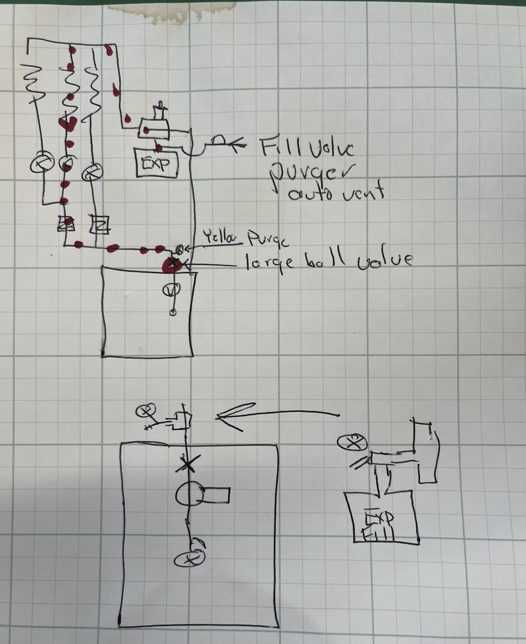

    I can't quite see all the supply side piping, I think it goes like this.
    Black steel pipe out of the top of the boiler turns and an air purger, expansion tank air vent and fill water come together there??
    So fill water enters the system and boiler. With the large ball valve under the yellow handle hose valve closed, water can only go up, around all the circuits and back down thru the zone valves. But it stops at that closed large ball valve, so air, dirt, what ever is in the system will come out the yellow purge/ hose valve.
    Purge one circuit at a time by closing off those lever/ butterfly valves above the zone valves. Open one purge for 5 minutes or more, close it, open the next, repeat, then the 3rd.
    Once you do a fast purge like this the air purger above the boiler will clean up remaining air.
    Follow the red dots on this drawing to see the flow path.
    The near5 boiler piping is not the textbook pumping away. Another possible upgrade would be to add a tee where the yellow handle purge valve is. Move the expansion tank and fill valve to that location. Then you would be pumping away from the PONPC. Makes air removal much easier when piped "Pumping Away"

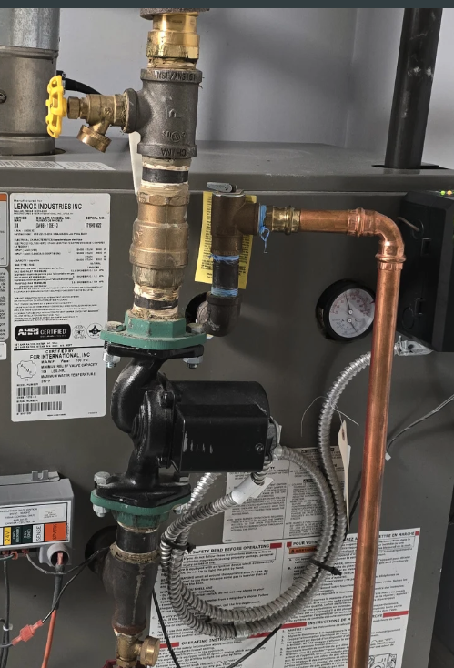

    By the shape of this circulator, and the location low on the boiler block, I think this is the return? Should be an arrow on that pump also.
  • Is this the arrow? If so, I'm an idiot.
    Intplm. Posts: 3,160
    Yes, thats the arrow and No, you are not an idiot. You are asking very good questions.
    MikeyDee
  • I appreciate the help and kind words... but I insulated the pipes going INTO the boiler! LOL!
  • Nothing wrong with that. They should be insulated as they contain hot water, even when returning to the boiler.
