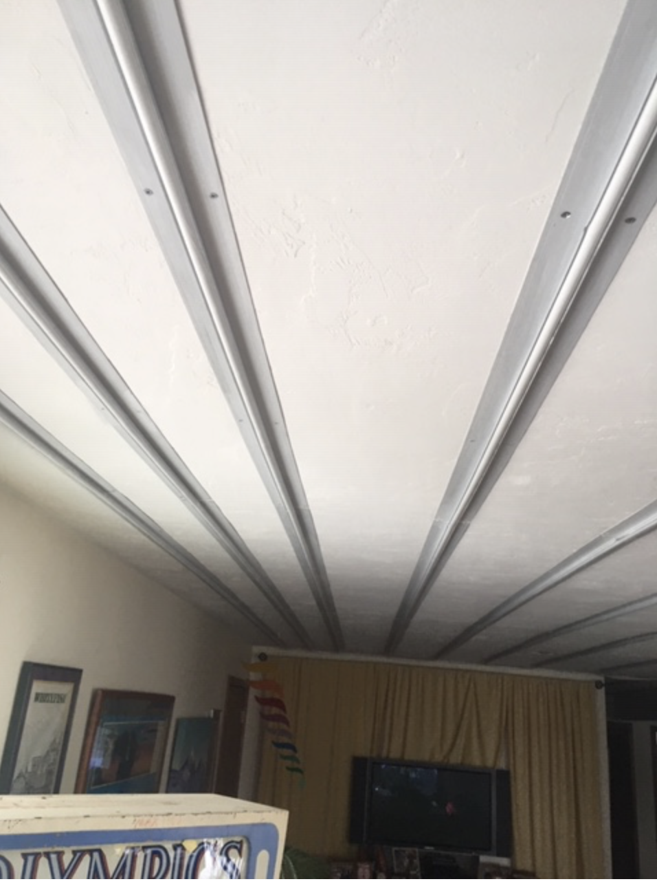

So since my background is woodworking/finish carpentry I had a crazy idea. Why not fabricate a radiant heat panel for a wall? Use plywood with the appropriate size groove for the pex and cover it with sheet aluminum and set it a nice frame. Rigid insulation on the backside.
Crazy idea??
    mattmia2 Member Posts: 17,416
    edited January 2025
    There are systems to do that. It is typically just put under the finished wall material. The output per square ft of radiant isn't a lot so you typically need to cover most of the walls or ceiling.

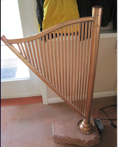

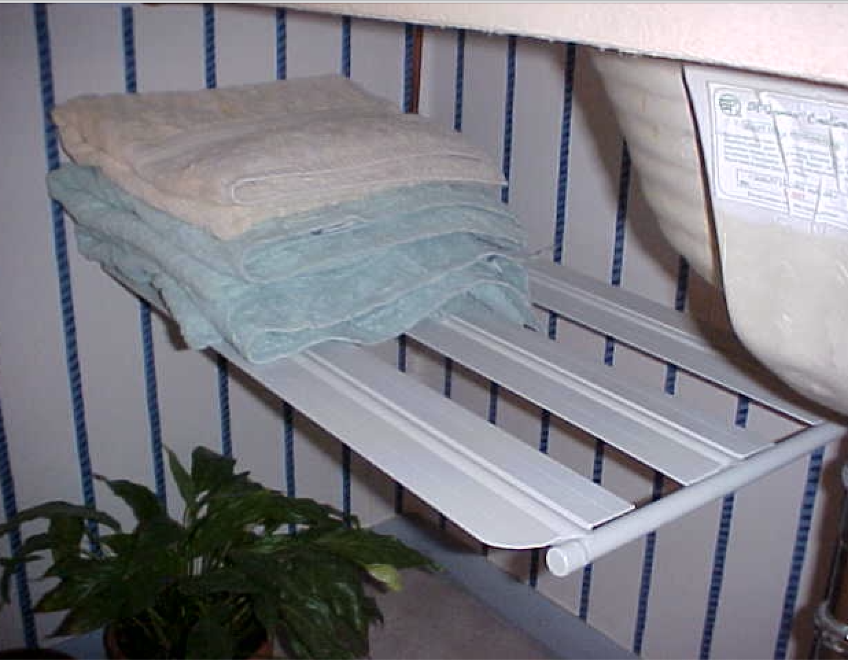

    Hi, You might get more output with solar panel tubing. Just guessing though.
    Yours, Larry

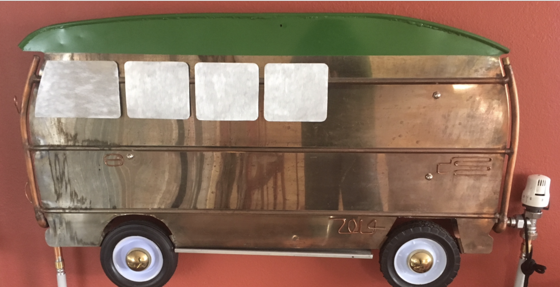

    Almost all radiant heat panels are custom made.
    I'd say that Warmboard is probably the state of the art, look at their design for inspiration.

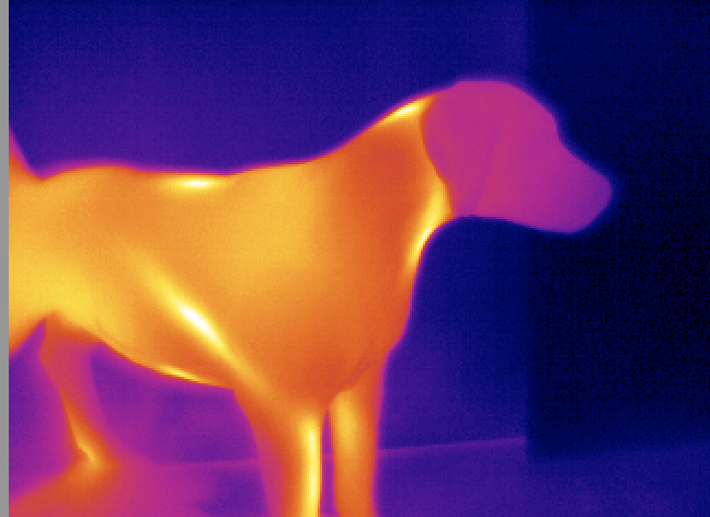

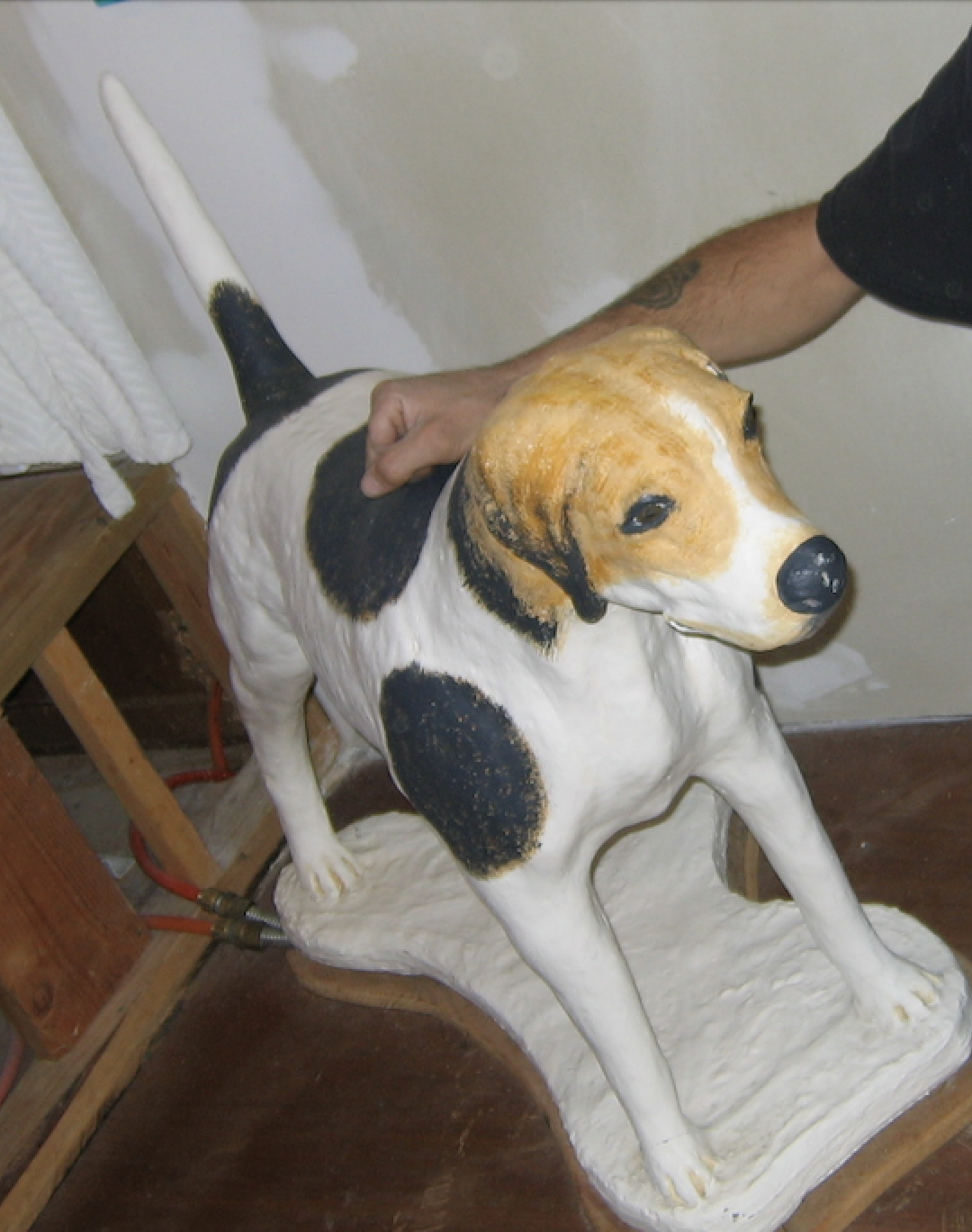

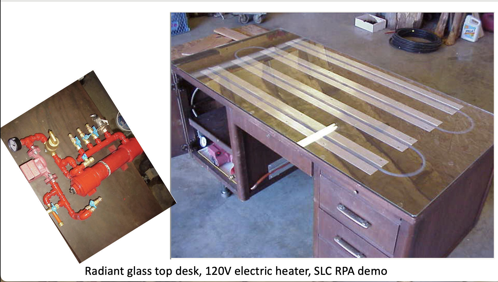

    I moved that 400 lb dog across the west a few times. The last move broke several legs and was the end of an era.
    It was actually connected to the homemade electric boiler in that desk, standing on a piece of Warmboard, as a working display at the RPA event in Salt Lake, many years ago. The desk, dog and Warmboard were all heating.
