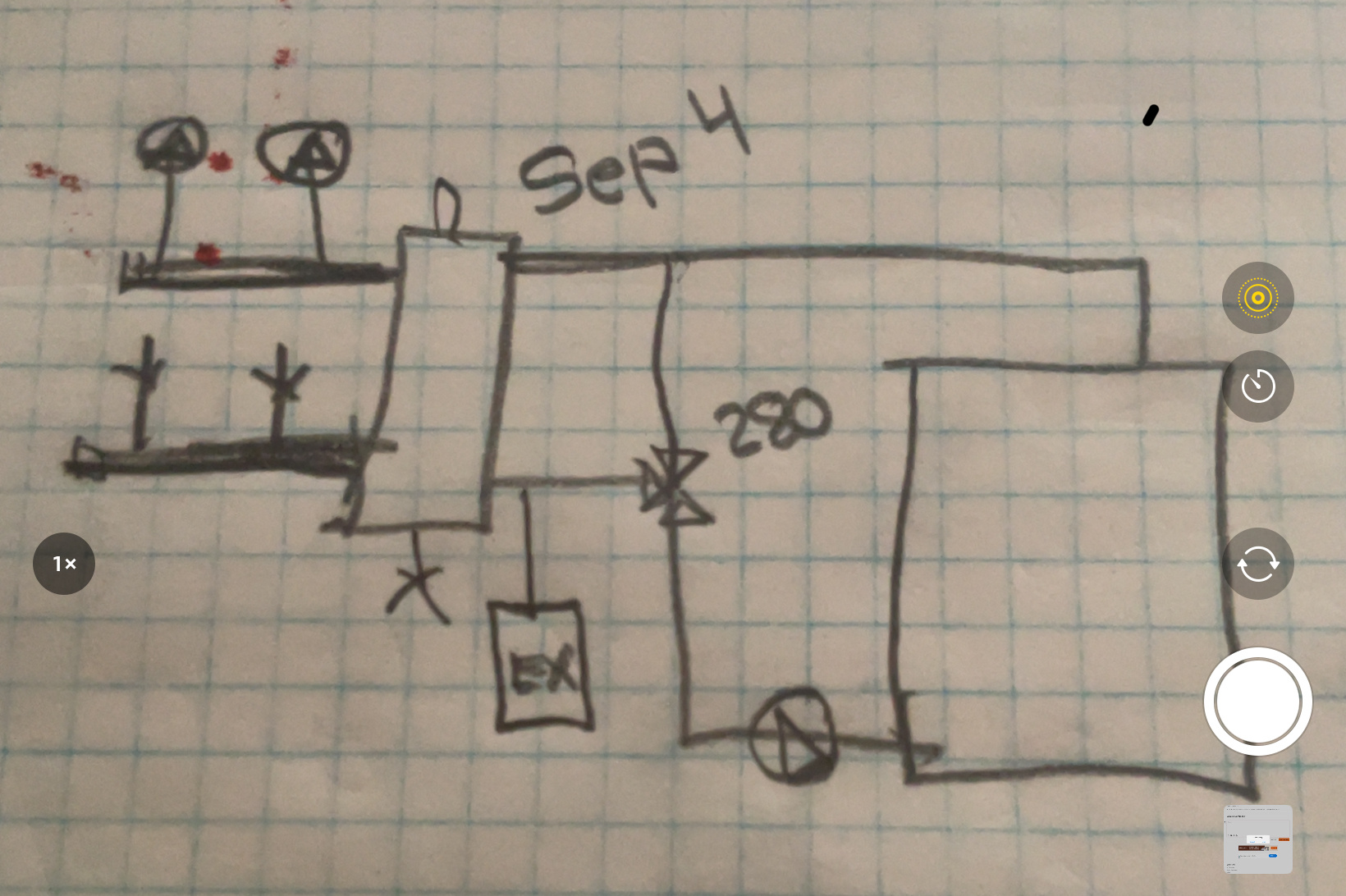

Thanks for everyone on this site so far, it has been incredibly helpful in getting our addition setup for radiators. If I could pick everyone's mind again, I'm looking to address a few issues with the near boiler piping.
The system with just the converted gravity piping originally ran best with a AM10 circulator (essentially a Taco 0010). Once the 3/4" zones with zone valves were added, the AM10 circulator was moving the water way too fast through the smaller zones. For the interim, there is smart circulator (UPSe 15-58F) installed, and it has made the smaller zones work better, but the original converted system seems much slower to warm and the radiators at the end struggle.
I am assuming that the necessary circulator to move the water in the old gravity pipes is fairly different than the circulator needs of the newer zones that are only 3/4" copper lines. I also noticed that the system overall is currently throttled by the ESBE, which is great for the boiler but does seem to slow the overall water movement in the farthest radiator lines.
I read Dan's Pumping Away book and think I found a solution… Would the below piping layout let me run the appropriate circulator for each zone and better distribute the heating needs? Am I overthinking this?
Thanks for any thoughts anyone has on this setup.

    Move the zone valve to the return and tie in the feed to the expansion tank connection ..
    What is the purpose of the mixing valve ?

    Thanks @Big Ed_4 , the purpose of the mixing valve is boiler return water protection, it keeps the return above 130 degrees. When it is just Zone 1 running, since the piping and radiation was designed for another era, it would take over 45 minutes to get the return temperature over 120-125
    The smaller zones, 2-4, never had that issue since the mass is much smaller, but I think I read that Dan's book suggests having the boiler protection in place.

    hot_rod Member Posts: 27,810
    A great application for a hydro sep.
    The sep would give you air, dirt, magnetic, and hydraulic separation in one device.
    Your loads are now in parallel so the get the same temperature.
    In your drawing the loads are in series and will get a different blended supply temperature

    I agree, didn't think about the temperature difference. Good thought.
    Would it be better to switch over to manifold setup at the same time to allow me to service the radiators without having to dump all the water in the system every week for the next month or two?

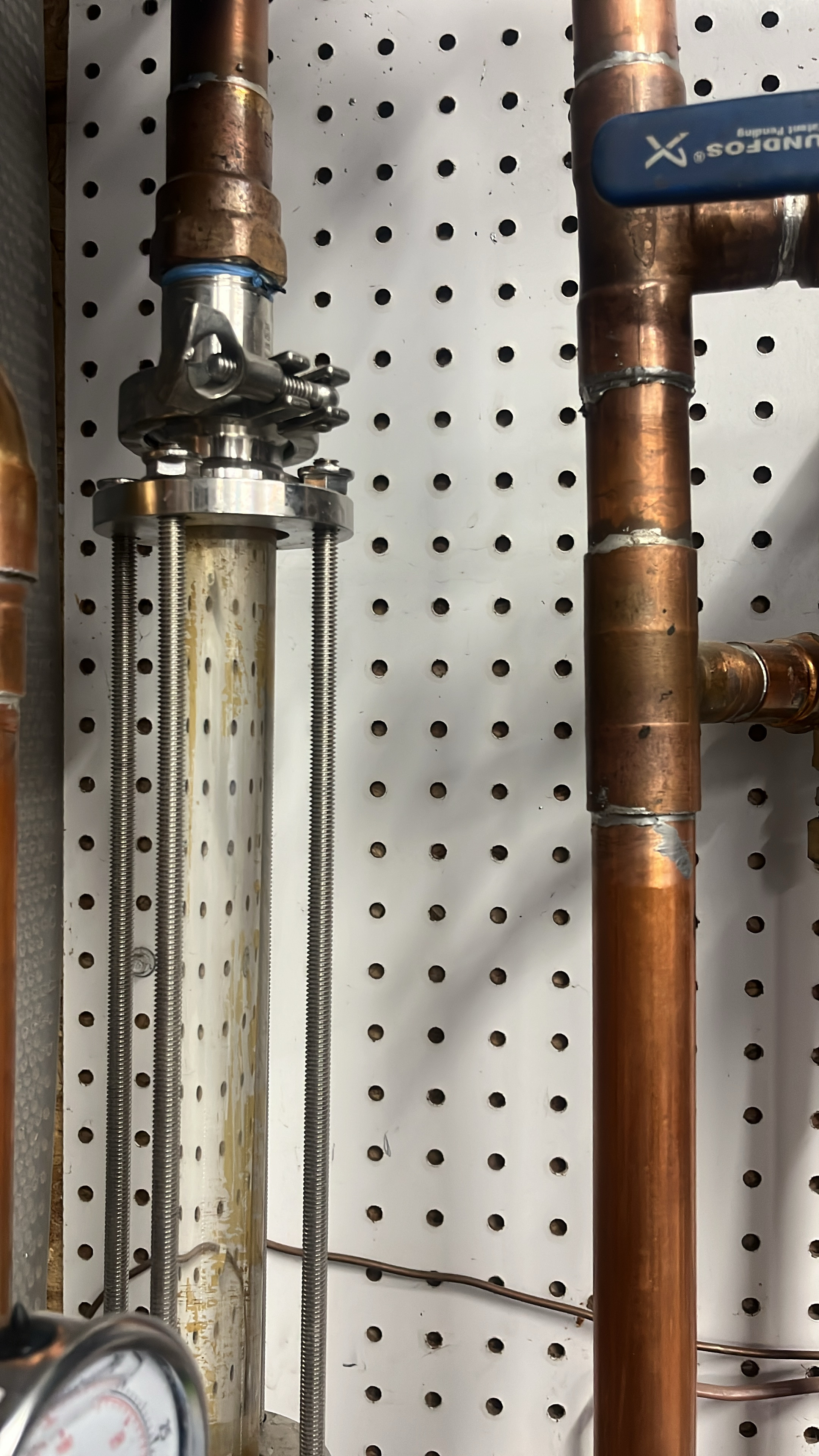

    you could buy or make a 50 gallon drum if DI water and use it over and over. That way you are not adding another batch of minerals with every refill.
    When you are finished, run a cleaner, flush with the barrel water, then refill with DI water and some conditioner.
    A small 1/2 hp transfer pump to fill and flush from the barrel.
    Axiom has an assortment of DI filters to make Deionized boiler fill water.
    Here is my boiler water, filled with DI and a bottle of Adey HC1. It does have iron pumps, steel expansion tank, some steel nipples, etc

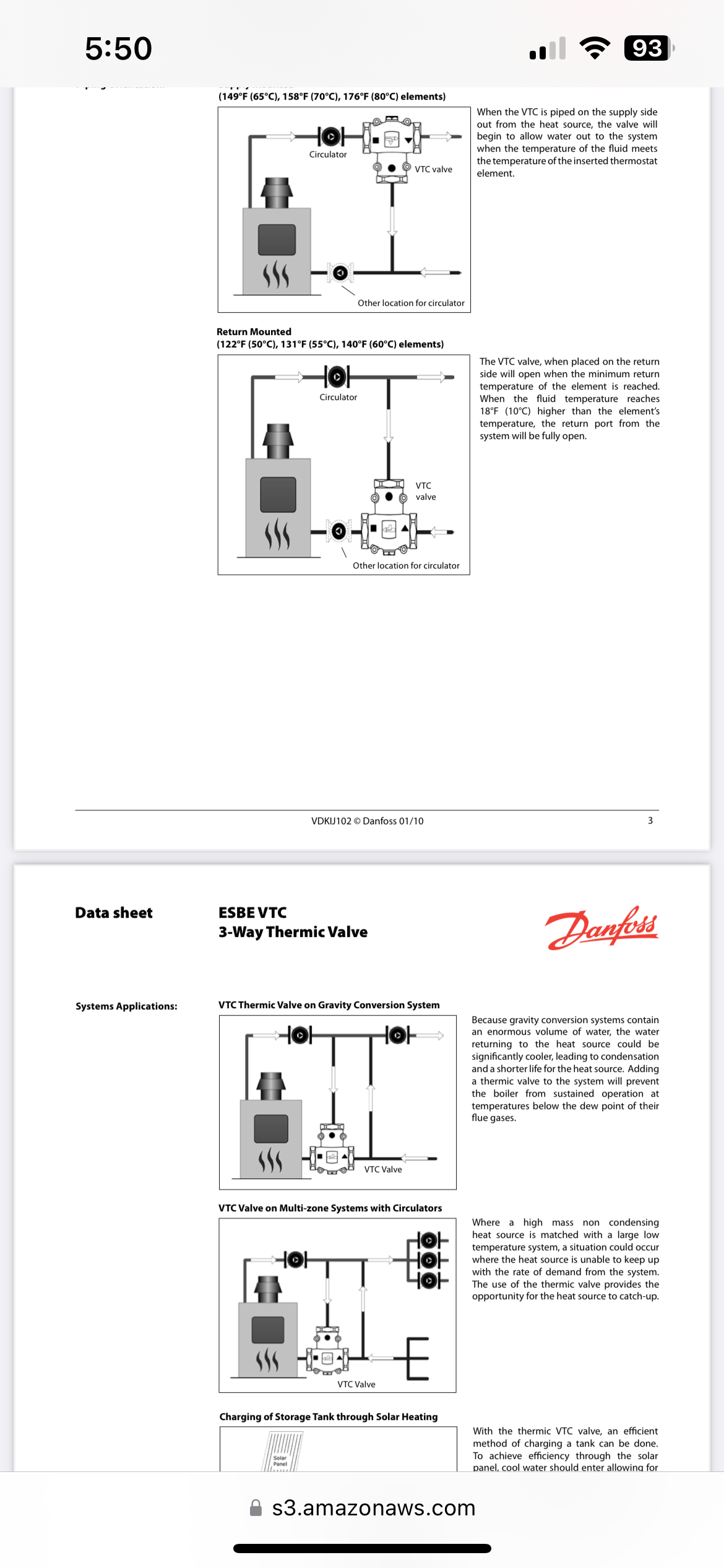

    These graphics help explain the concept. When the boiler is cold 100% of the flow out of the boiler returns back to the boiler.
    So an additional "second" pump pumping across that bypass pipe is only moving room temperature water, not much heating will happen. I'm not sure of the purpose on that particular valve unless it is a low Cv valve? And how does the bypass get adjusted?
    With na 280 valve as the boiler temperature starts rising, the protection valve slowly starts to open, think of it a slipping the clutch. The valve is a hydronic clutch. It is not an on/ off valve, it modulates based on temperature.
    Once the return is coming back above the setpoint + differential, the bypass closes 100% and the flow is 100% out of the boiler and back to the boiler.
    Our largest market is the wood boiler industry. Most of the solid fuel boilers sold in Europe include a return protection valve. Wood or pellet boilers and flue creosote quickly if they run too cold, not a good condition to experience if you have ever been around a chimney fire..
    I suggest a 115° sensor cartridge for gas or oil fired. There is an 18° differential, so 115 + 18= 133° is when bypass is shut-off.
    (the graphic happens to show a buffer tank, it can connect directly to radiator distribution piping)
