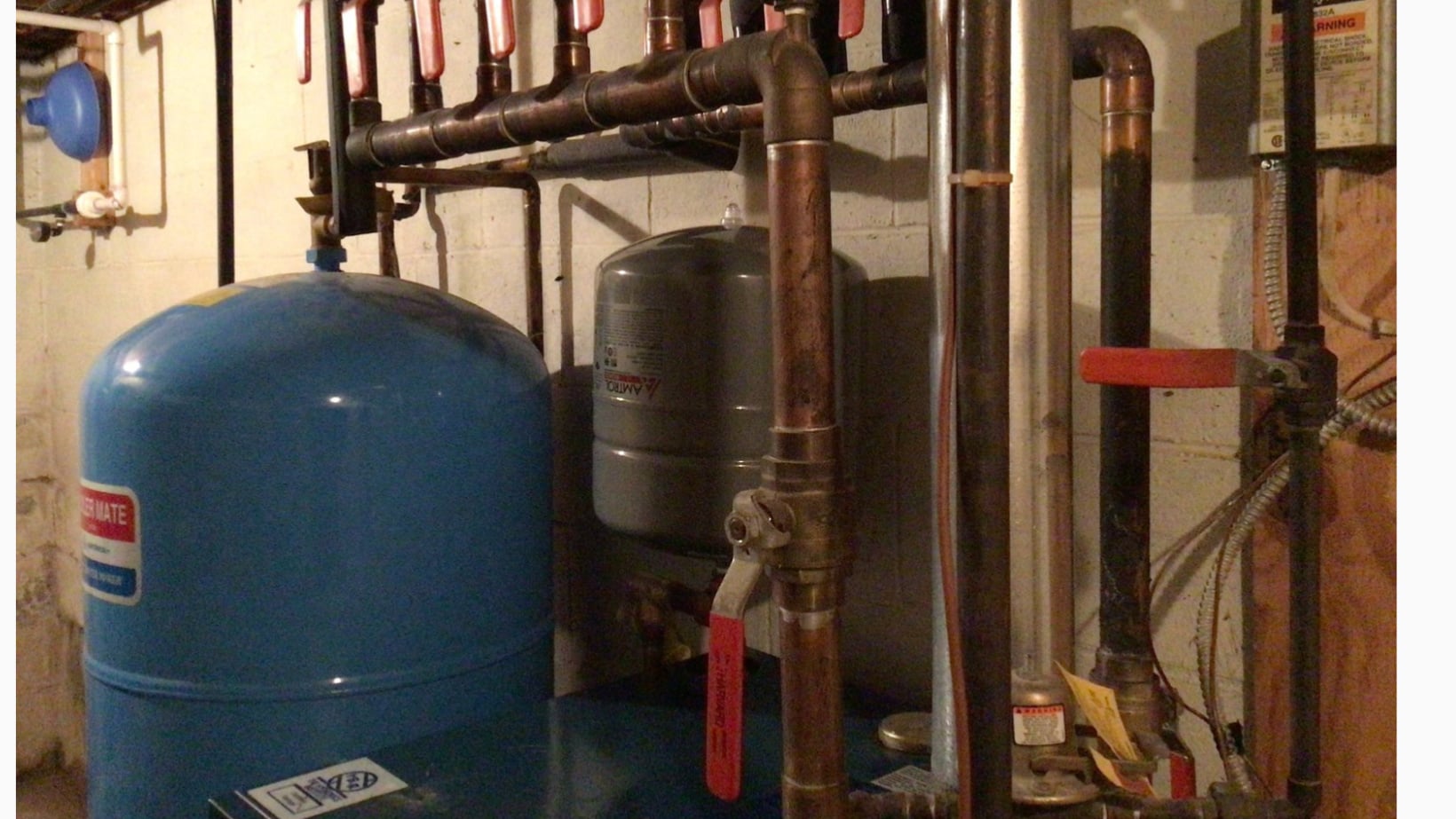

Hello, I have a hot water boiler with 5 zones . There are no purge valves . It does have auto air vents on the high points of the piping . I would like to add some purge valves . I’m sending along a picture. Does anyone have any recommendations as to where to place them ? Thanks
I added a few more pictures. 1 relay is for indirect water heater , remaining 3 are master br, family rm, and living room which have radiant floor heat. All 4 relays have their own circulators .
are the zone valves on the return? If so a purge valve jut above this large ball valve

Yes they are on the return. I like that idea with the T-drain . Would the other end on that return be an option ? Remove the elbow and sweat in a tee with a valve on the end?
take that vent out, increase it to 1/2, see what you get for flow. Take the fill to 25 psi or so. It may work for one zone at a time

As a practical matter, considering the difficulty of adding a T and valve elsewhere,… Adding a purge valve (or two purge valves as described below) in the second photo, in the horizontal pipe exiting the left side of the second image would probably be the eziest place to add a T and purge valve. Or, maybe in the vertical pipe against the wall on the left side of that first image (above the expansion tank).
It would be best idea to have purge valves, in the first image, between the ball valves shown and the zone valves above them. But not practicable to add them there now.

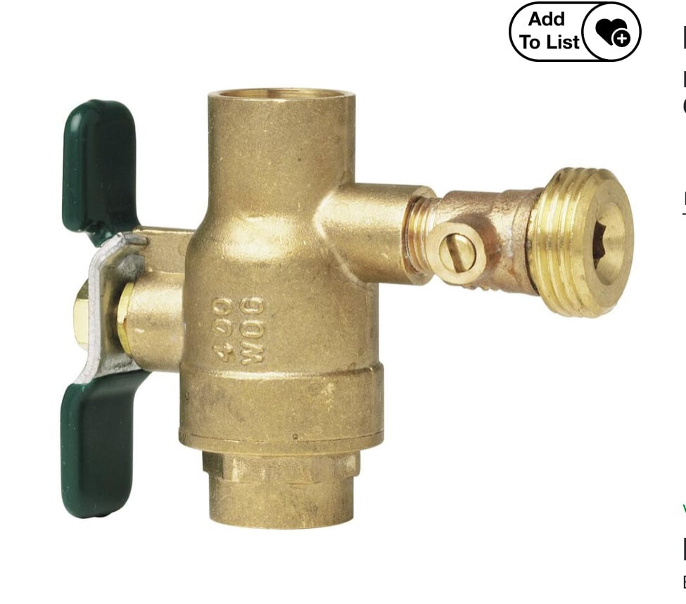

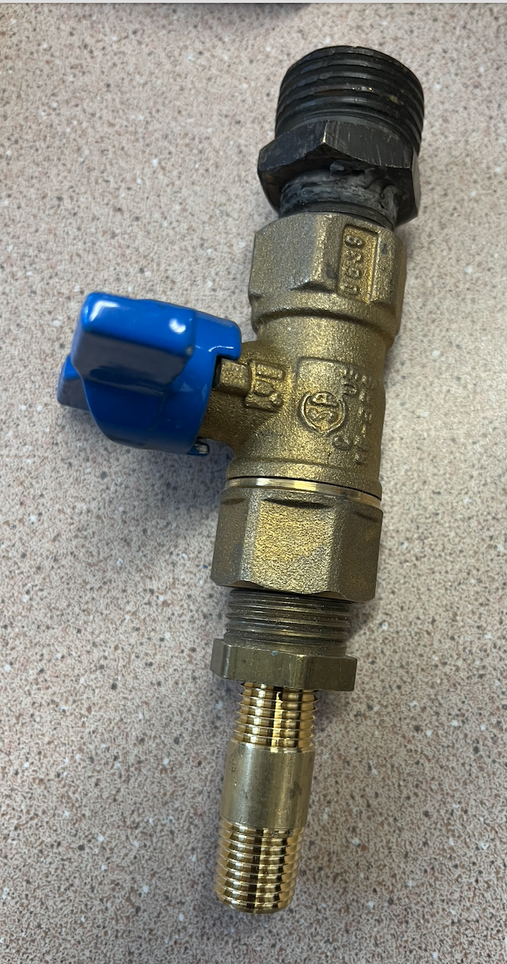

before Webstone became a household name, I used these Watts valves. That is a 1/4” purge cock and they flowed enough to purge 3/4” loops. I think the vent ell you have is where I would start. You just need to get the big air out, the air purger should finish off the air removal within hours or a day.

And while you are at it, install a Spirovent or equivalent micro bubble air separator on the system. I do not see one installed in the pictures provided. It should be installed on the feed side with the expansion tank. Otherwise you will continue to have air issues in the system.

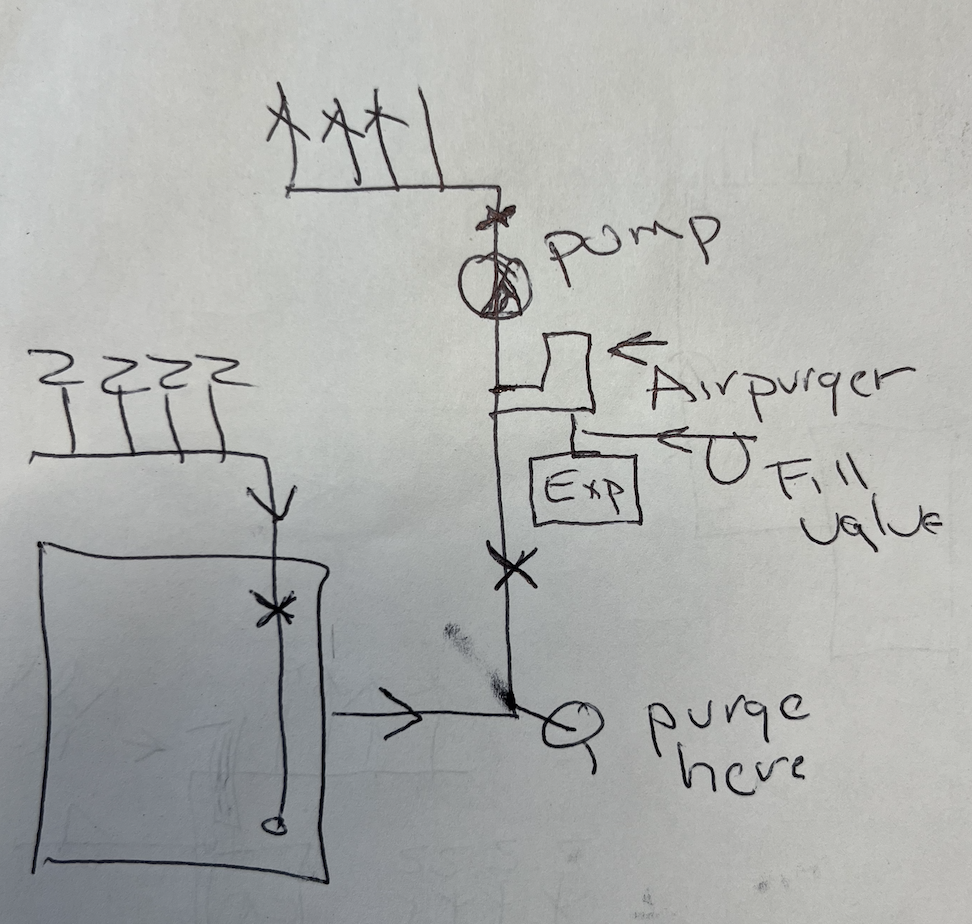

Thank you all for your suggestions. I’m sending a picture to verify the correct locations of the 2 possible locations . Would this be correct?

Remove the auto vent and add a valve there to purge. This is a quick, simple work around for now.
If you want to get in deeper at the end of the season,
Add an air sep on the supply out of the boiler, a vertical type..
Move the expansion tank to that air sep as well as the fill valve.
The circulator above that assembly, a purge valve below the large red handle ball valve you have in place.
So all the work could be done on the supply riser. Much easier than cutting into or rebuilding the return for just a purge point.
Now you have a perfect troublefree easy to purge "pumping away" fix. No more air issues.

look at the drawing, if I drain that whole loop via the boiler drain , close the boiler drain , then fill the loop with the water fill valve, the 2 small caleffi air vents are the only vents to bleed the air while filling. Is that sufficient??? That’s why I was asking about adding a purge valve ? Sorry if I’m confusing everyone.
You really want an air purger or air separator in the piping that the water passes through constantly.
The vents you have will release air as youfill, purging gets enough out to flow the system.

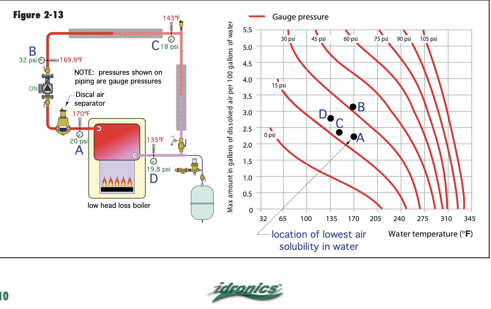

As the boiler heats more (micro bubbles) air is driven out of solution. An air purger in the hot supply at the boiler, catches and eliminates that noisy air.

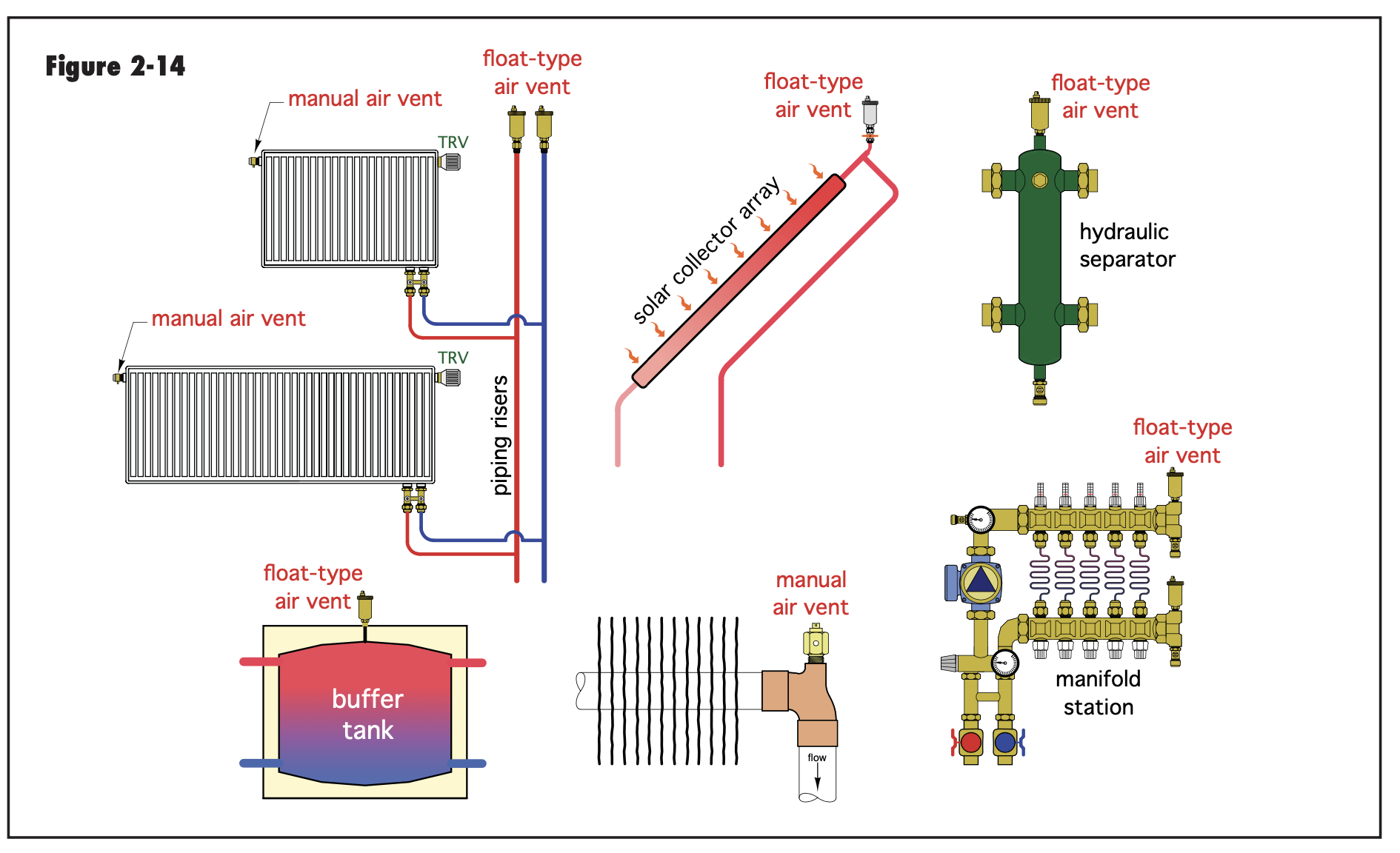

Figure 2-13 shows the multiple devices, their best location and the explanation about air, pressure and temperature.
2-14 shows where auto and manual vents are typically used
The small 1/8" air vents you have cannot dispel the air quickly, the catch little by little as the float inside drops.
