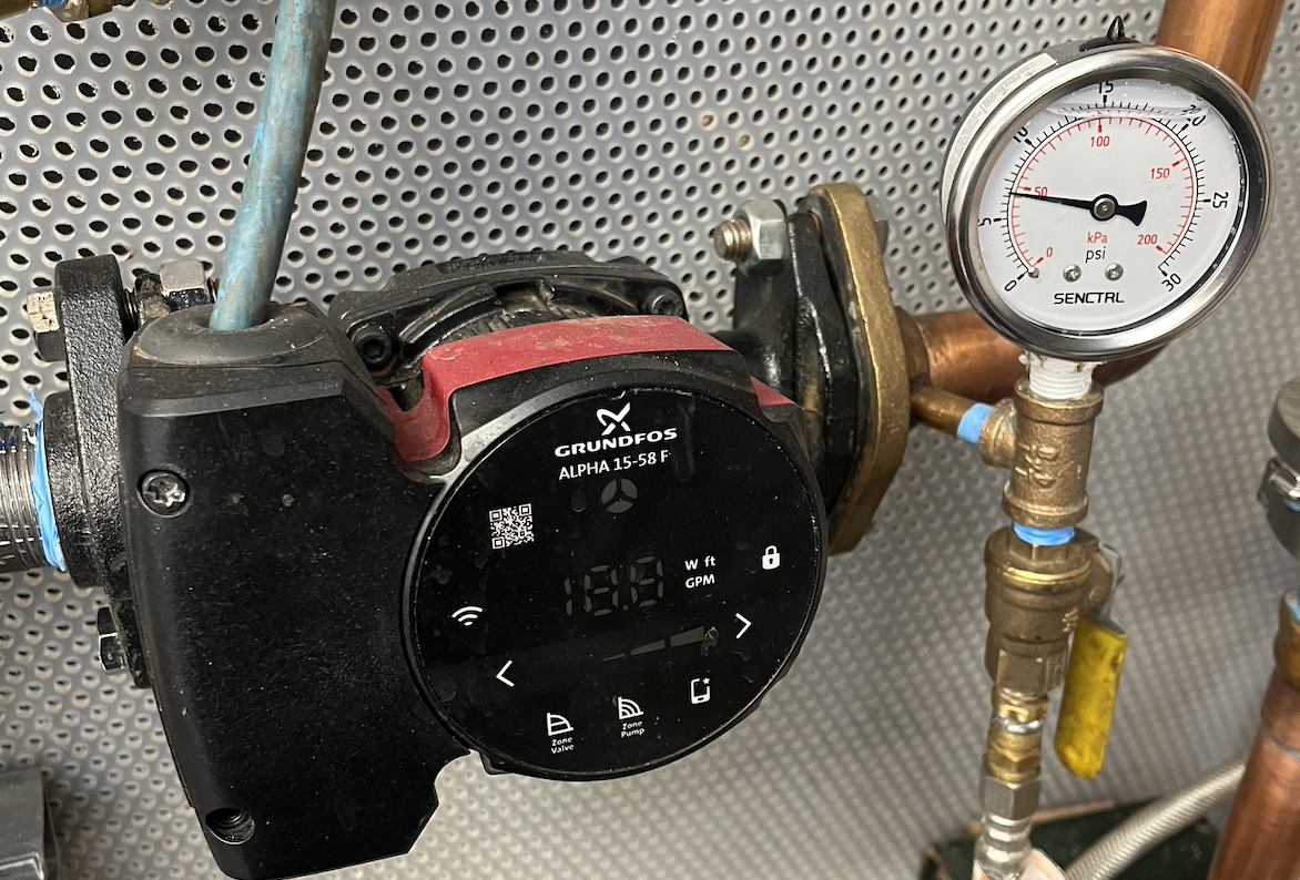

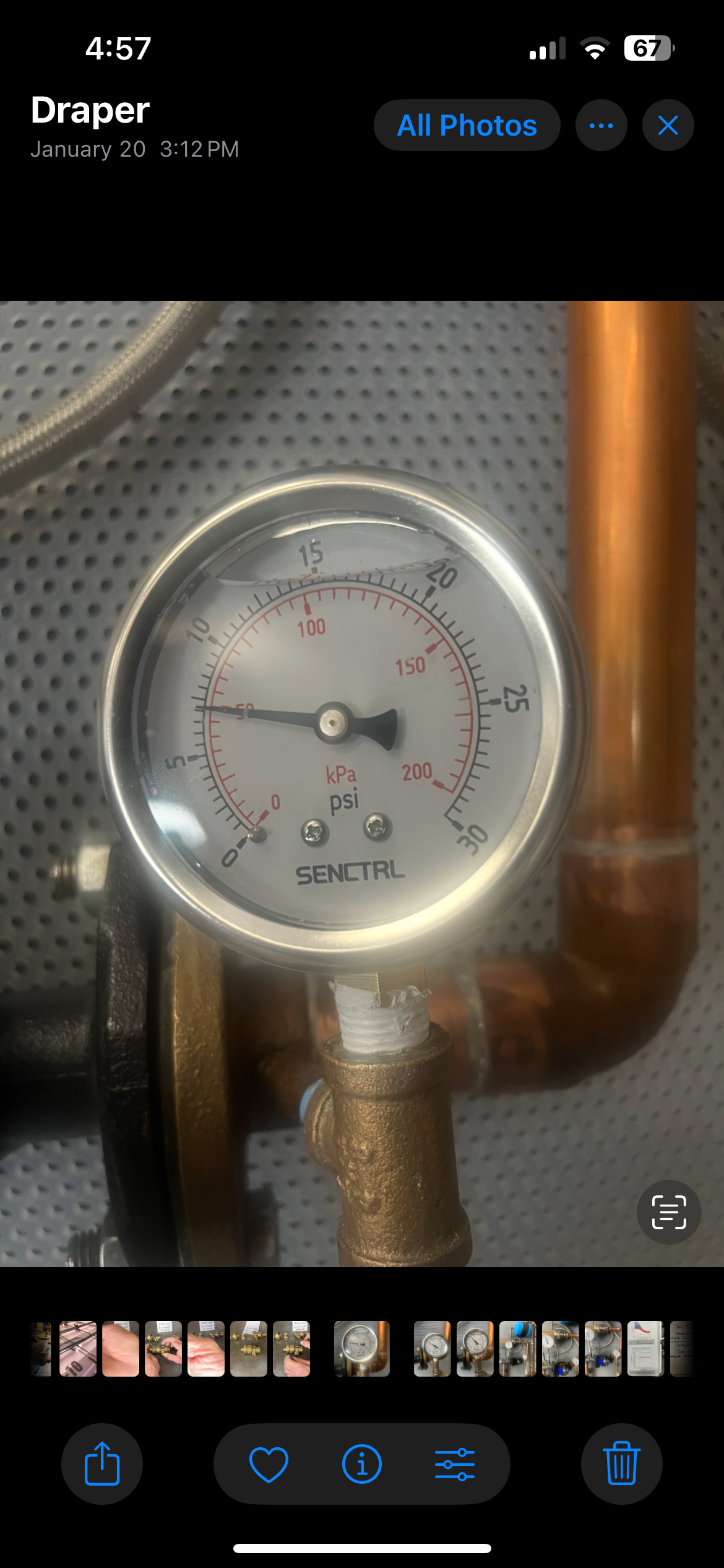

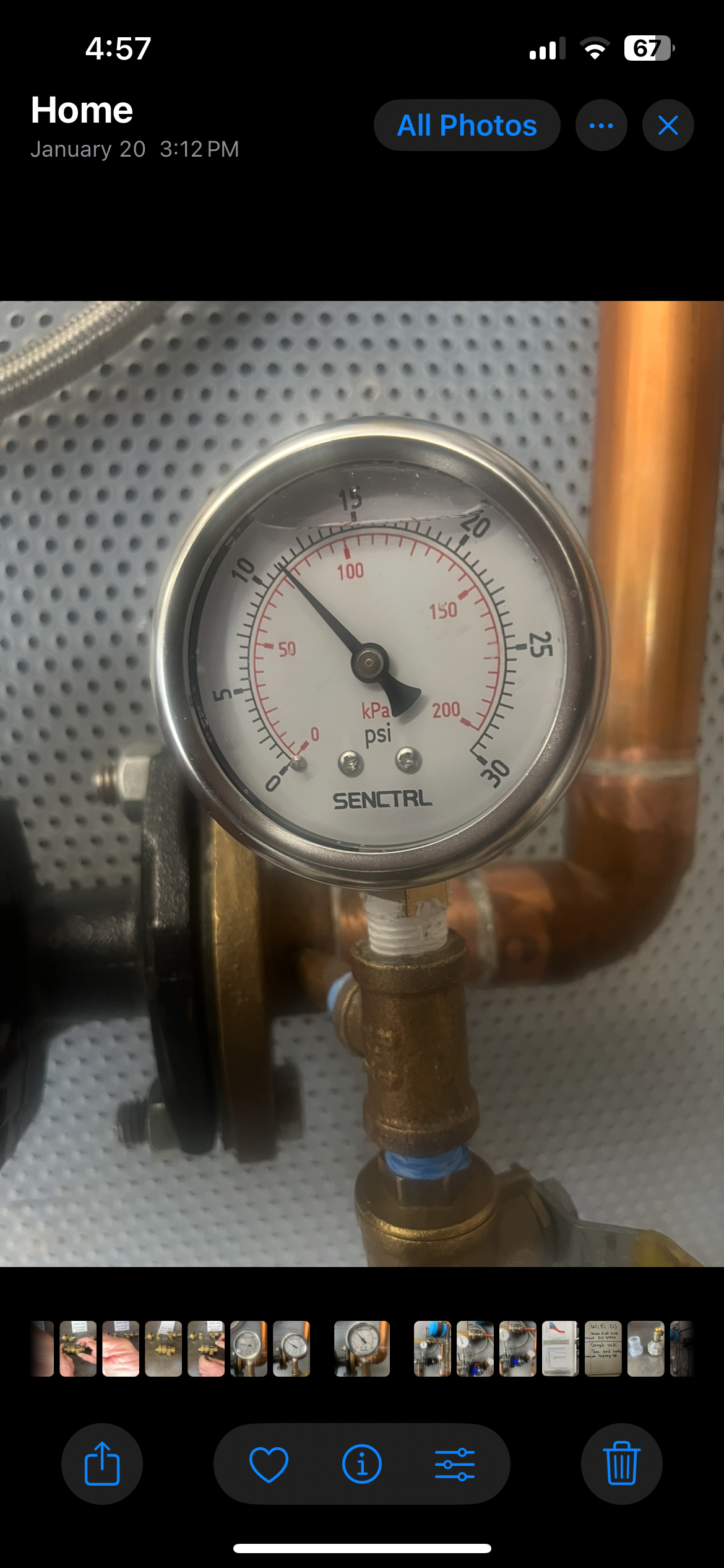

    hot_rod Member Posts: 28,010
    In some cases you can get heat going up the return side, so ZVs on supply, check on the return gives you 100% flow stopage. A gauge at the discharge of the circulator would show you how much ∆P is being added to the boiler. I sometimes tap a gauge into the flanges on these small circs.
    It depends on the head of the circuit the pump is connected into. Typically 6- 8 psi is what these small circ add.
    Thermal expansion, if the tank is sized properly, maybe 5- 8 or 10 psi from 70 to 180°?
    But if all was fine with the previous 007??

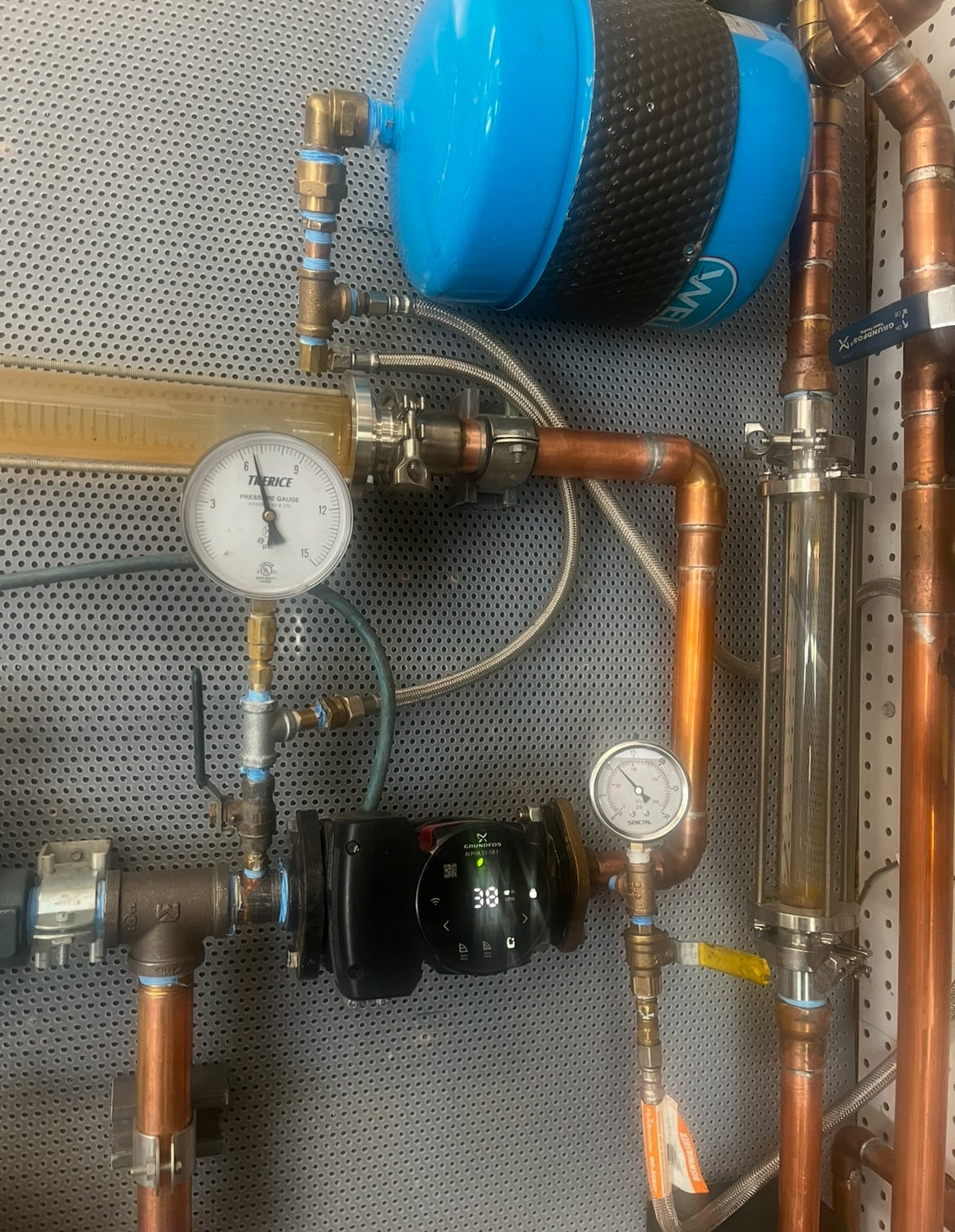

    some good reading in Idronics 16 about circulators and circulation
    https://www.caleffi.com/sites/default/files/media/external-file/Idronics_16_NA_Circulation%20in%20hydronic%20systems.pdf

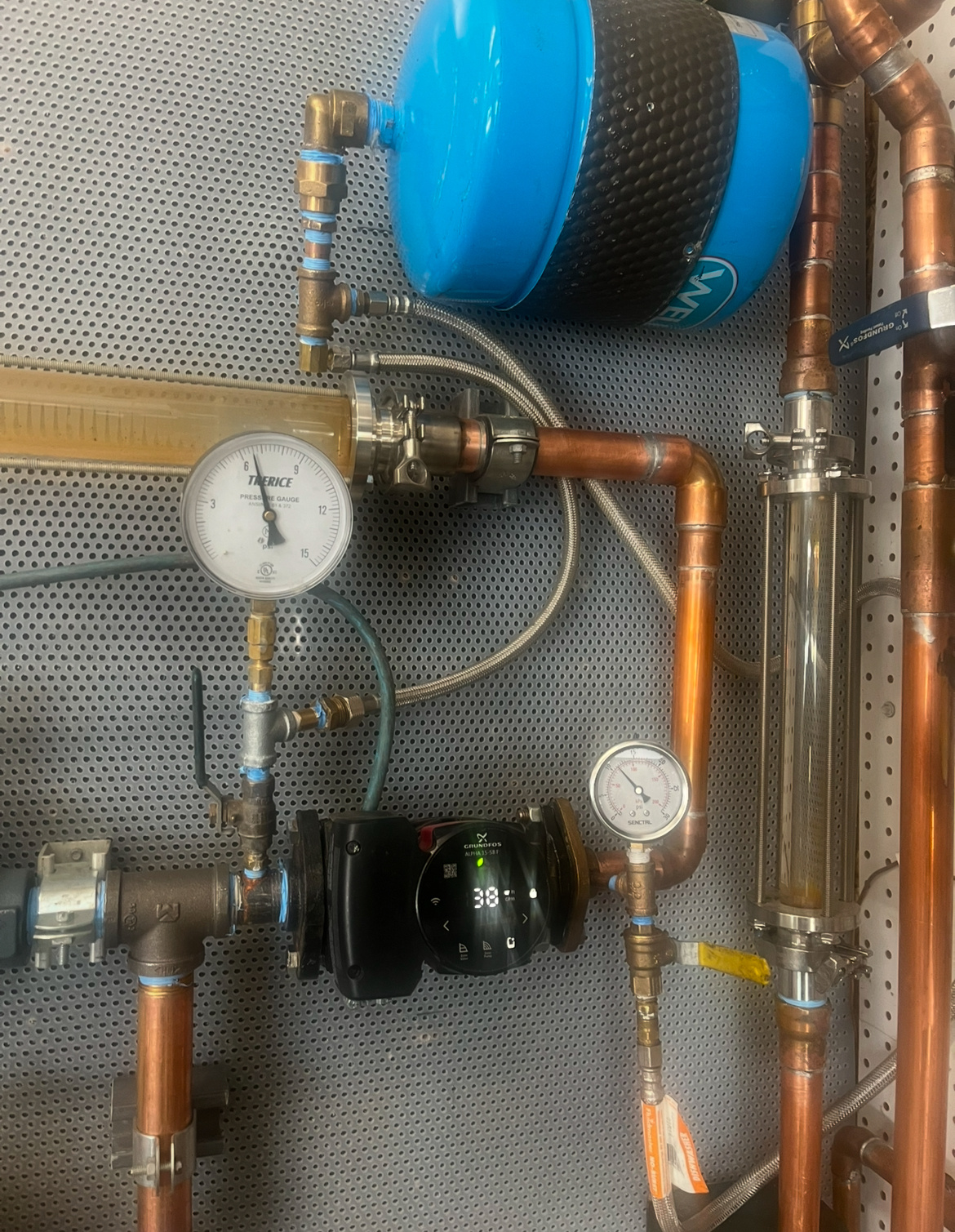

    A demo on my shop wall to show the effect of a circulator spinning adding head energy which the gauge shows connected in this small circuit static pressure of 7 psi goes to 12 psi when the circ is powered. The pressure increase is “evidence” that head energy has been added
    The demo also allows me to move the PONPC to either side if the circ

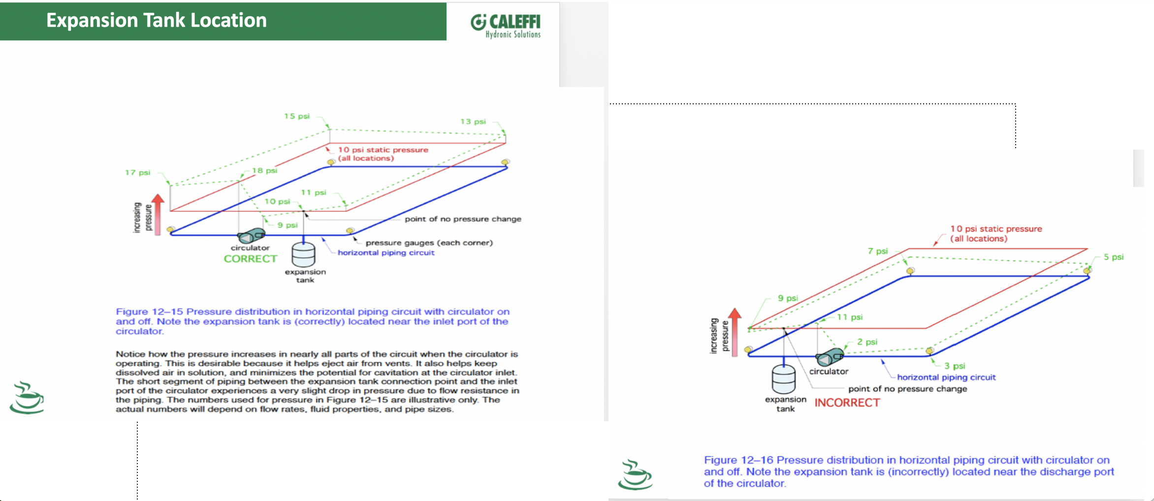

    edited January 2025

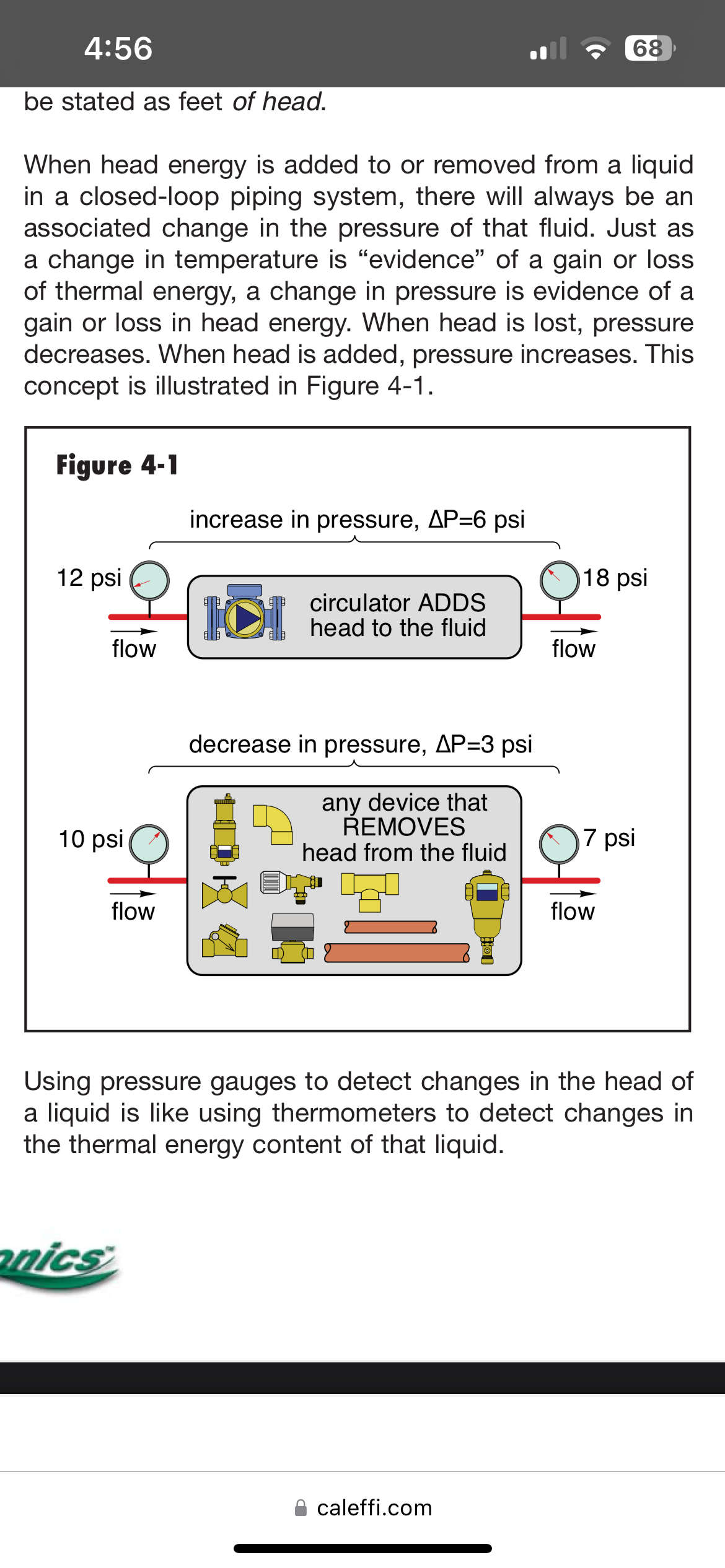

    I asked @hobbit about the expansion tank connection point. This graphic demonstrates how them pump head can show up in the system depending on that tank/ pump relationship.
    Pumping away from the tank add that pressure developed by the circ to the system, static fill of 10 psi goes to 18 psi at the discharge of the circ when pumping away./
    When you pump at the expansion tank, which is common in cast iron packaged boilers, the pressure differential the circ establishes is deducted on the inlet side of the circuit. In this example you see that static fill of 10 psi is actually 2 psi at the circ.

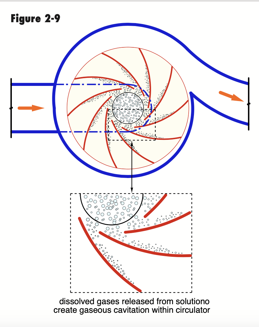

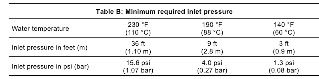

    In some cases that can lead to cavitation if you drop below the vapor pressure. Systems running high temperature, low pressure are prone to cavitation. A system running 190° needs to have 4 psi at the inlet of the circ to stay out of cavitation potential. So figure 12-16 shows a circ that is a prime candidate for cavitation at high operating temperatures.
    Cavitation is often dismissed as an air problem. But it never goes away.
