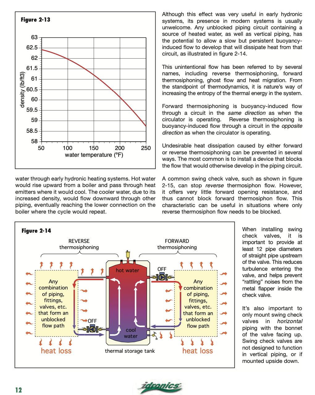

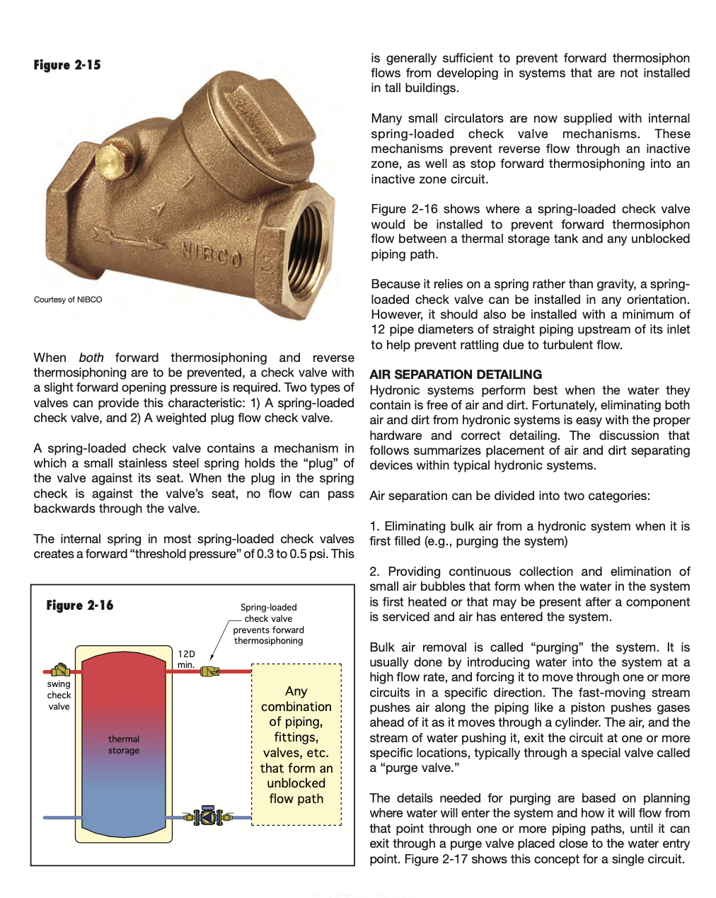

    hot_rod Posts: 28,699
    in some cases the ghost is going up the return side, large diameter vertical piping can encourage that
    So you might need to check both sides
    Use a soft seat spring type conical check for good flow and silent operation
    A serviceable type is nice if you have old iron piping. Rust and scale can hold them open a little

    Another vote for make sure you have functioning check valve. One at the zone2 circulator may be enough. If not, add an online check valve on the return side of zone 2. Theoretically that's all you need, nothing electronic necessary.

    What circulator do you have? Most them can easily accept an IFC, integral flow check.

    Either you have a mis-piped system or thermosiphon up the return. You should never need a zone valve after a circulator on a single loop circuit. A flow check or hydronic spring check will work.
    Forward or reverse thermosiphon are know causes of over-heating.

    An experiences hydronic troubleshooter will chuckle 😂 when they see a zone valve after a circulator on a single loop, single circuit.
    It is usually installed to treat a symptom, not the problem. And often doesn't help solve the problem of un-wanted flow.
