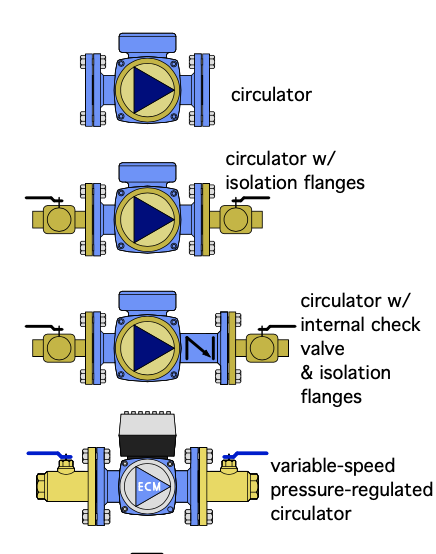

    If you used the Caleffi stencils for the drawing, we have the different circulator options in the free download.
  • mikted1
    mikted1 Member Posts: 12
    All 3 circulators are Grundfos UPSe 15-58FR High Efficiency ECM Wet Rotor Circulator Pump running with the following settings:
    BaseBoard Zone Circulator (No Check Valve) - Zone Valve (constant pressure) - Setting II
    Boiler Circulator (has Check Valve) - Zone Pump (constant curve) - Setting I
    Water Heater Circulator (has Check Valve) - Zone Pump (constant curve) - Setting II
    In Visio, I have the Caleffi Visio Stencils 2016-2-15. I do not see the Variable-speed pressure-regulated circulator. Is there an updated Visio stencil pack?
