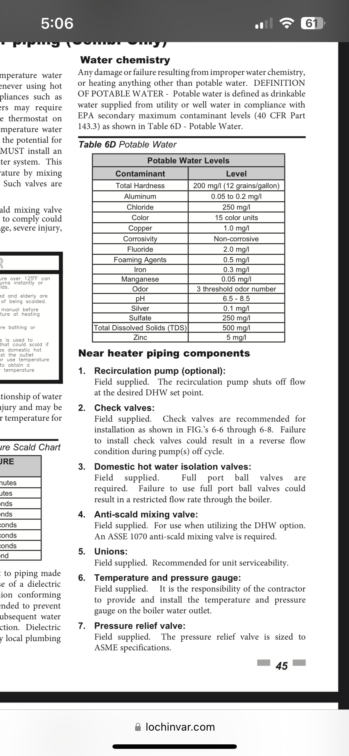

    hot_rod Member Posts: 27,806
    the installation manual mentioned the need to install a DHW mix valve, field supplied.
    The red and blue pex piping above the boilers should allow you to easily cut in mix valves? The do not need to be under the boilers should allow.

    For the 4th time, STOP worrying about the DHW temp reading during a space heating call. That means nothing whatsoever- just ignore it.
    As for the mixing valve, again as you were told multiple times, they are required by Lochinvar and will maintain a constant outlet temp to the fixtures. You said you were feeling fluctuations in DHW temp, which would be fixed by installing mixing valves as required by Lochinvar.
