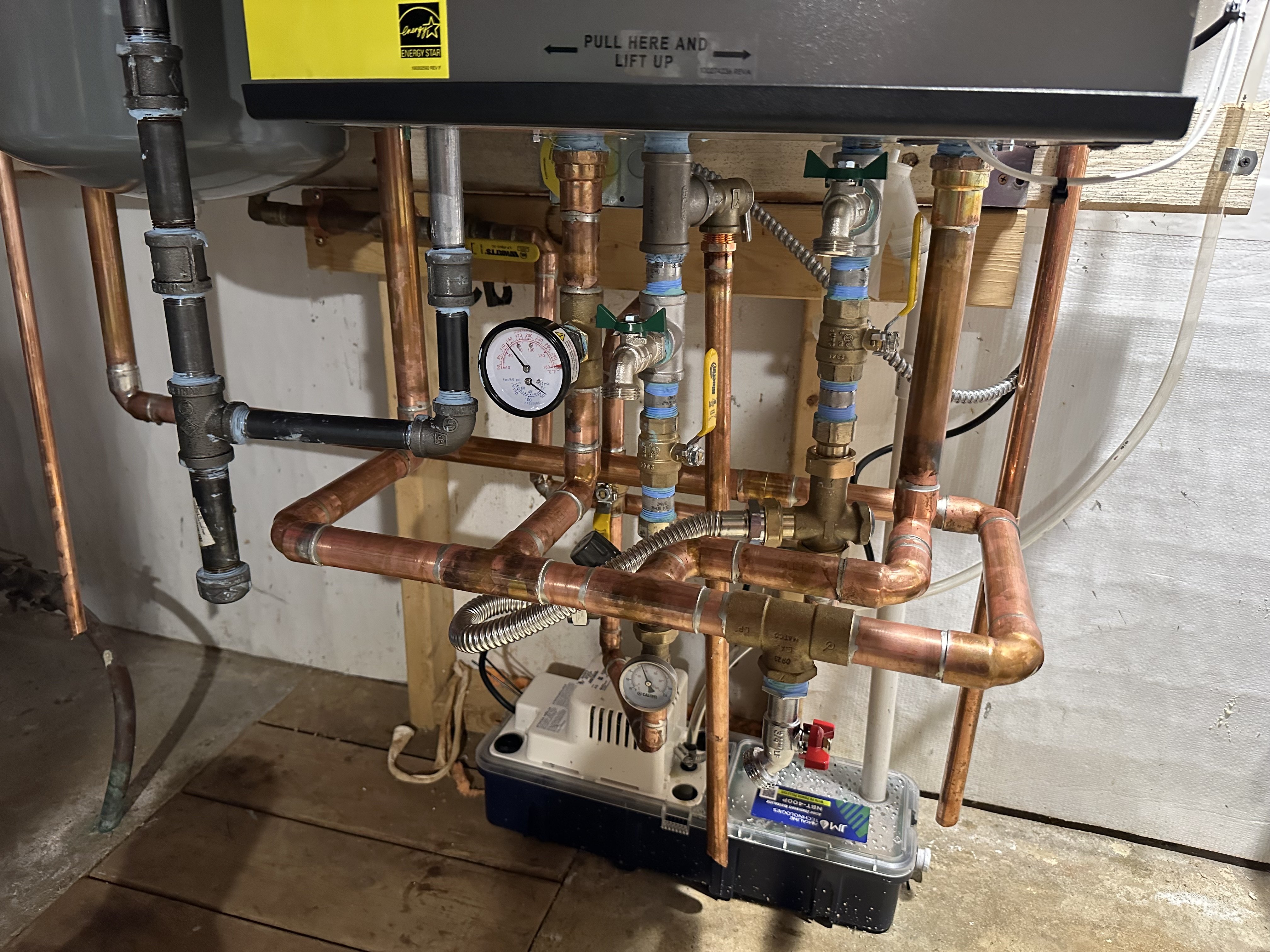

    I did get the installer to come back, put in service valves (I think they still omitted 1 but I am tired of pulling teeth), re-locate the ODR, and space the tees more closely together. I'm a complete layman and could not have convinced them to re-do any of this without your help. THANK YOU!

    P.S. It looks like they did install the proper isolation valve set for the DHW.

    Oh good, glad to hear you confirm the DHW isolation valve looks right.
