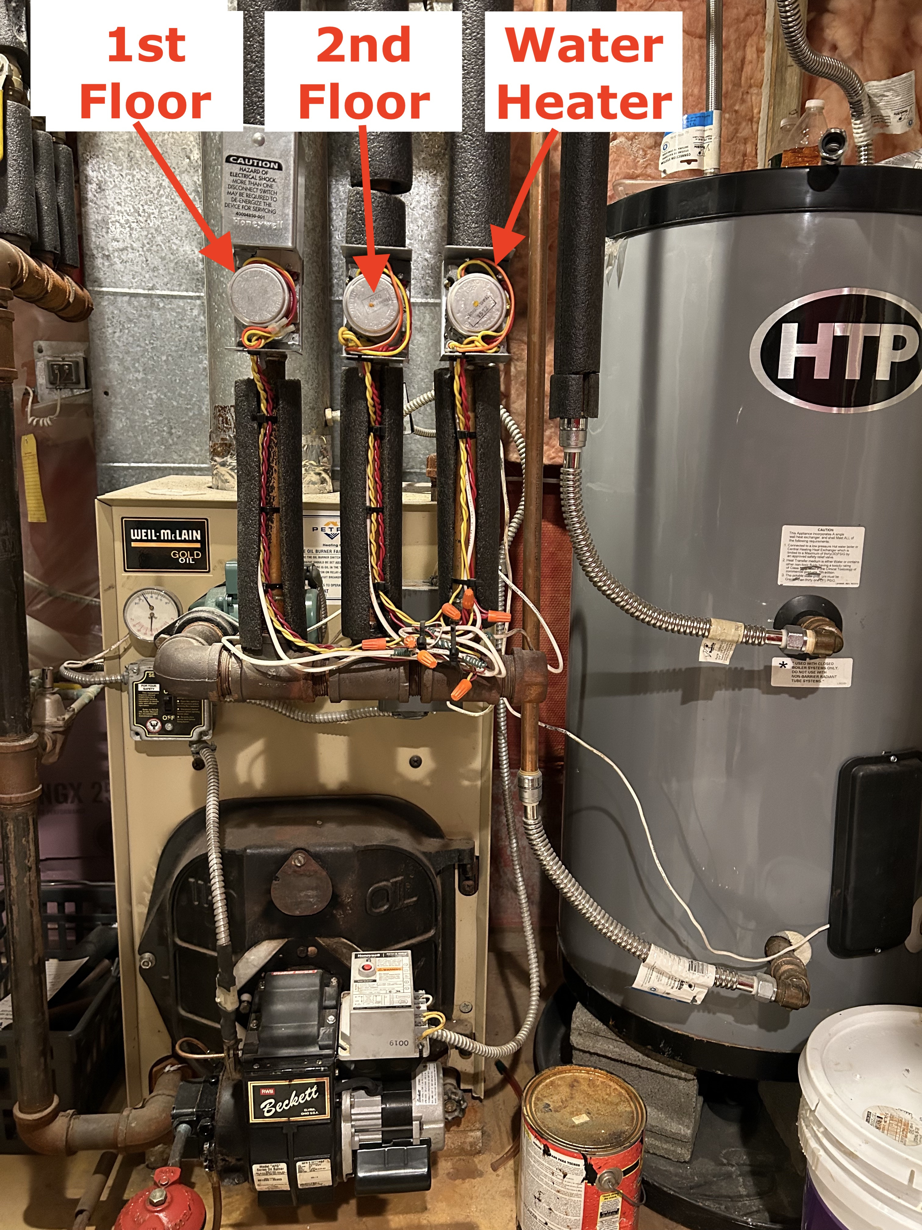

1st floor and hot water zones not working. (Boiler heats hot water and water is stored not sure what type you call that)
2nd floor zone is working.
Valves are open, no resistance on the levers, pipes are hot after the valve
Do these 2 zones share something in common?
pressure is 15. temp 180
see pic. cold is settling in please help. Cheers`

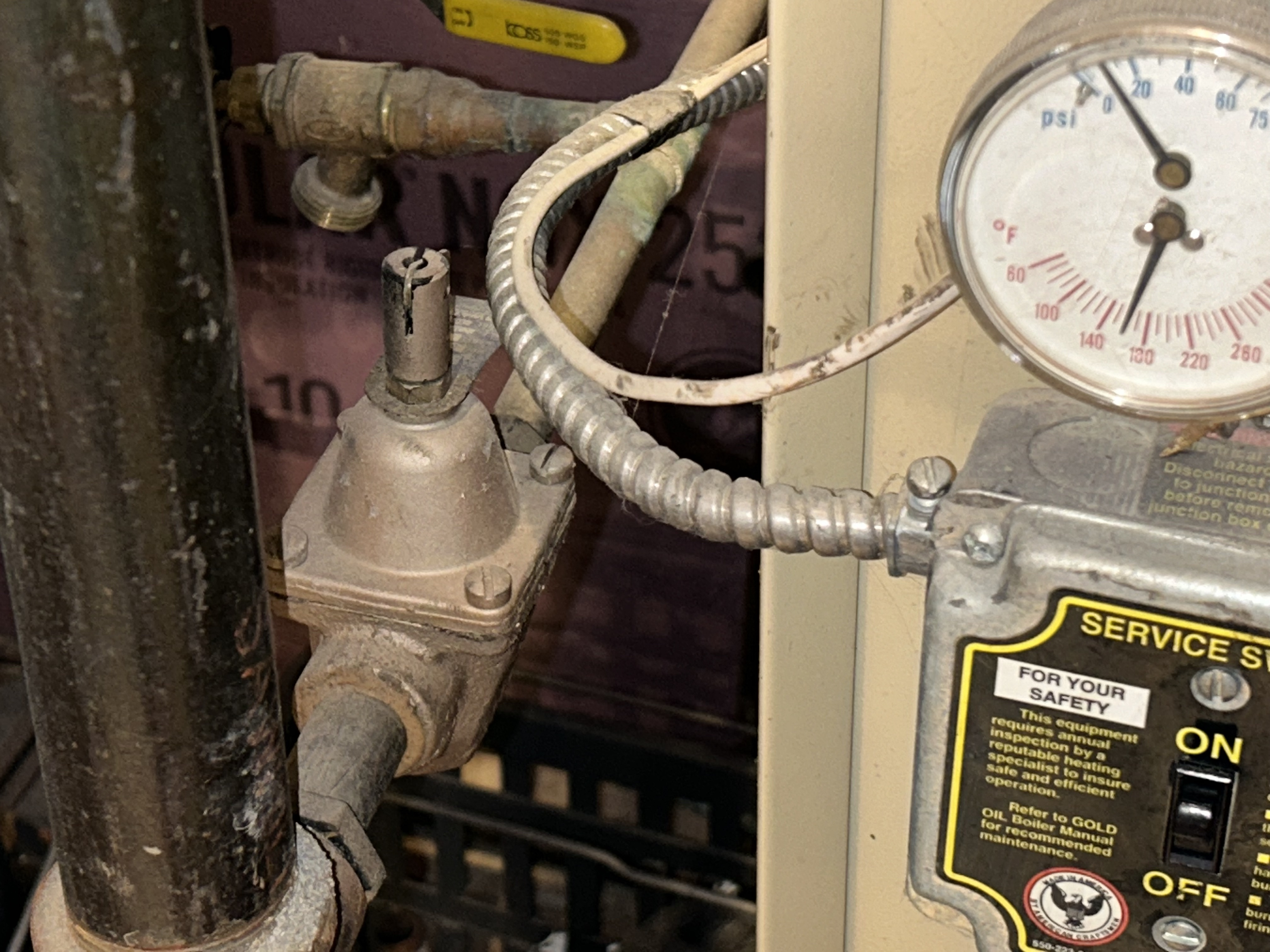

    Thank you very much for the reply. Is this the purge valve? Is there something the 2 non working zone would have in common?
    EdTheHeaterMan Member Posts: 12,492
    edited January 2025
    that valve in the picture is a pressure reducing valve use for automatically filling the boiler if the boiler pressure drops below the set point of that pressure reducing valve.

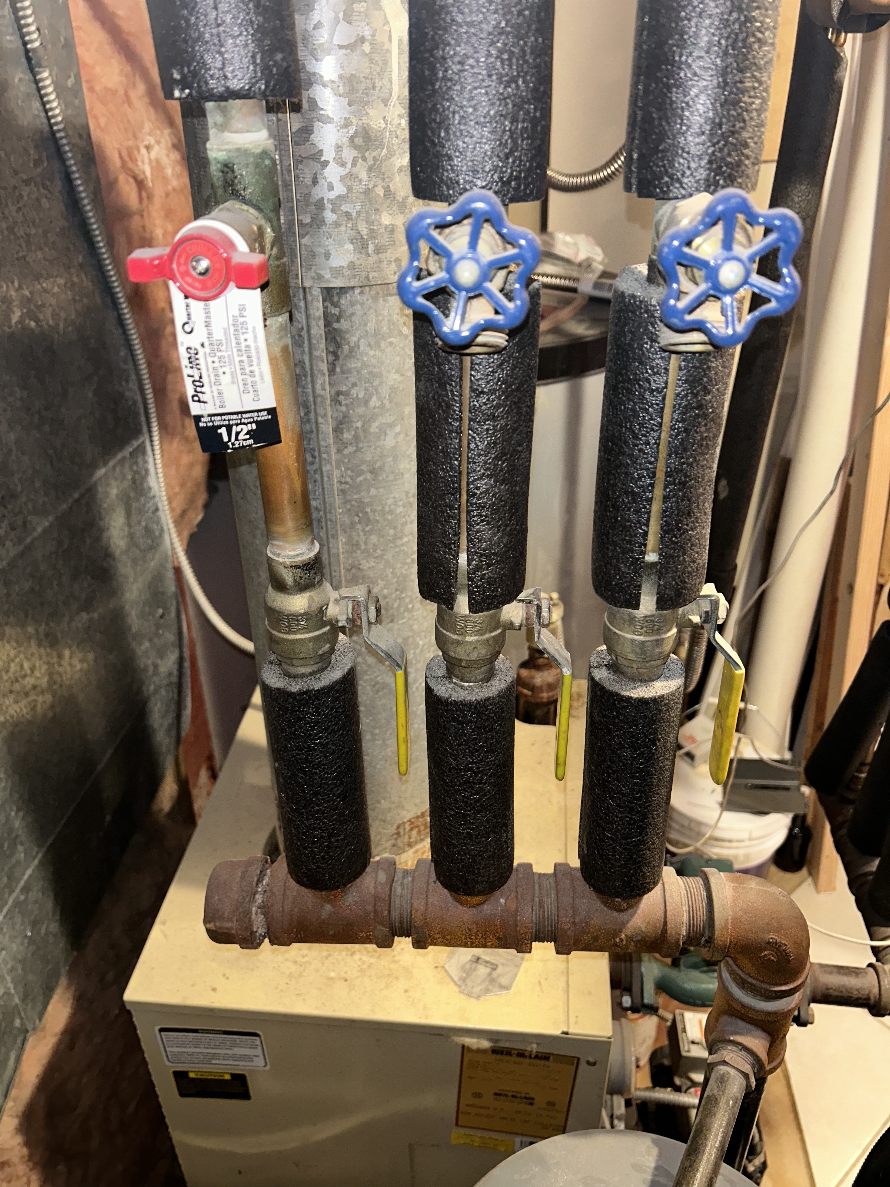

    To purge air from the system look for a purge station set up on the return pipes (upper left). there should be 3 of them.
    and follow the instructions in this video

    OK. I see the logic there. In order to purge air, I would be using these valves and faucets correct? The red handle one goes to the water heater/tank. the one on the far right goes to the first floor forced are handler. The middle one goes to 2nd floor air handler which is working

    Let's take a step back for a moment.
    Those zone valves have a little tab on the bottom. On the first floor valve, move the little tab all the way to the right and engage the detent that keeps the tab all the way over (otherwise it will spring back).
    Now see what happens to the first floor.

    hot_rod Member Posts: 27,806
    If the thermostat calls, the tab will not stay in the indent.
    Also, manually opening that valve with the lever in the indent, will not make the end switch. So the circulator may not run. Or the boiler fire.

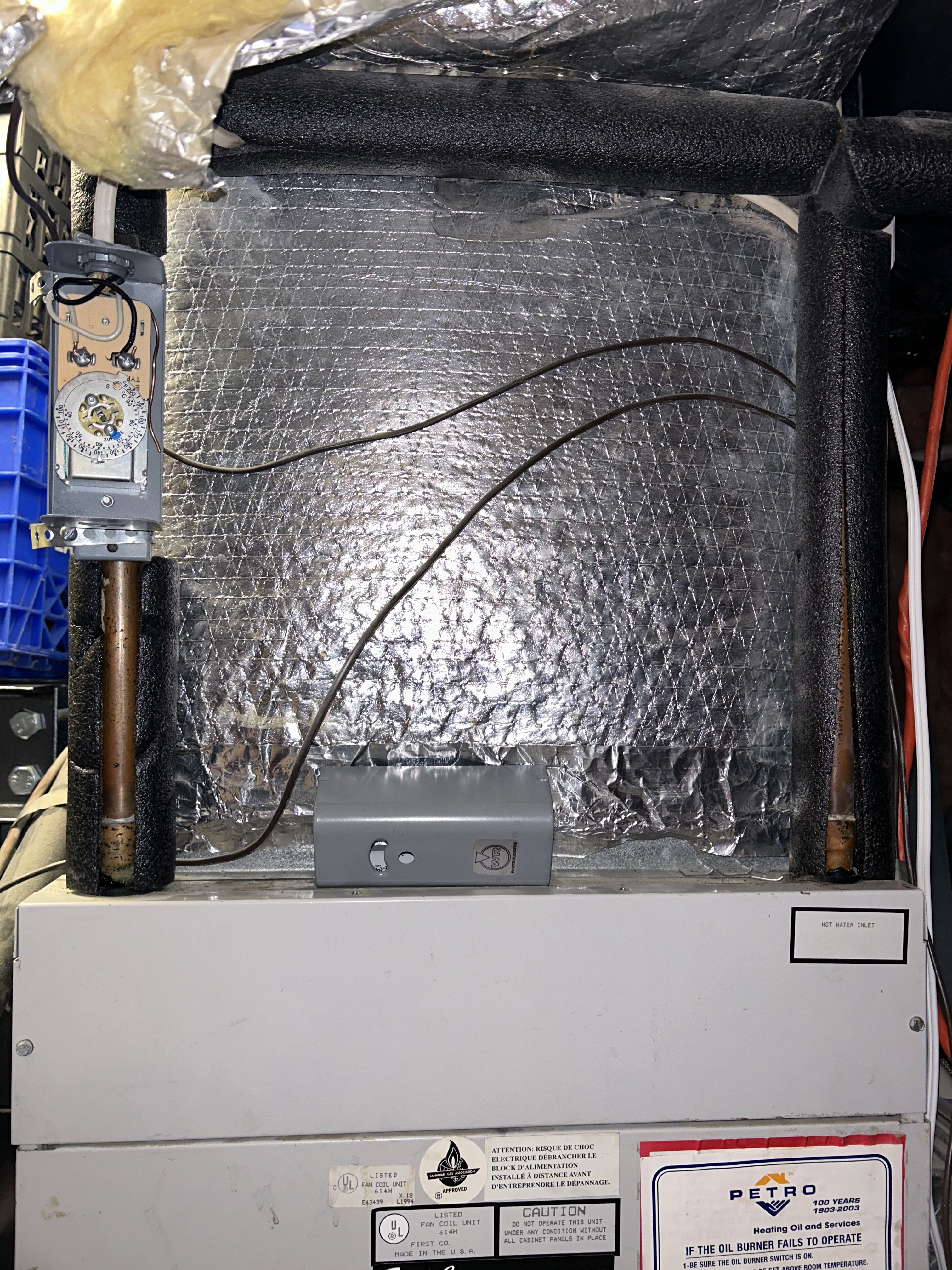

    It blows luke warm at best. Inlet pipe on right is too hot to touch, other pipe isnt hot at all. (see pic) Right now the air handler will come on for a minute or so, turn off for 10-15 and then start again. I switched fan to "ON" position for a moment to see if air hot or not…..not
    mattmia2 Member Posts: 17,416
    edited January 2025
    Does the pressure go up if you pull the fast fill lever on the pressure reducing valve? A little suspect of that gauge and a lot suspect of the prv keeping the system filled it you bleed or purge.
    The blower won't stay on because it is controlled by an aquastat on the outlet of the hydroair coil. When there is not airflow it gets hot enough to turn on the aquastat, then the blower turns on and cools it because there isn't enough flow through it, almost certainly because it is airbound. There is a small possibility that the circulator isn't working and there is enough gravity flow to heat the zone near the boiler.
