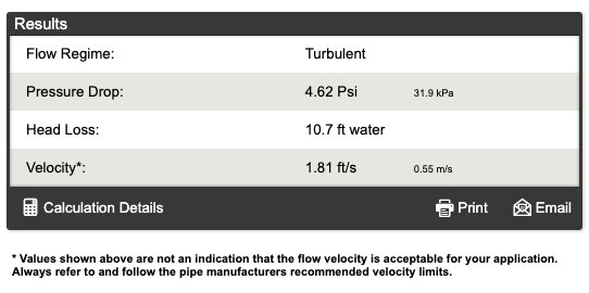

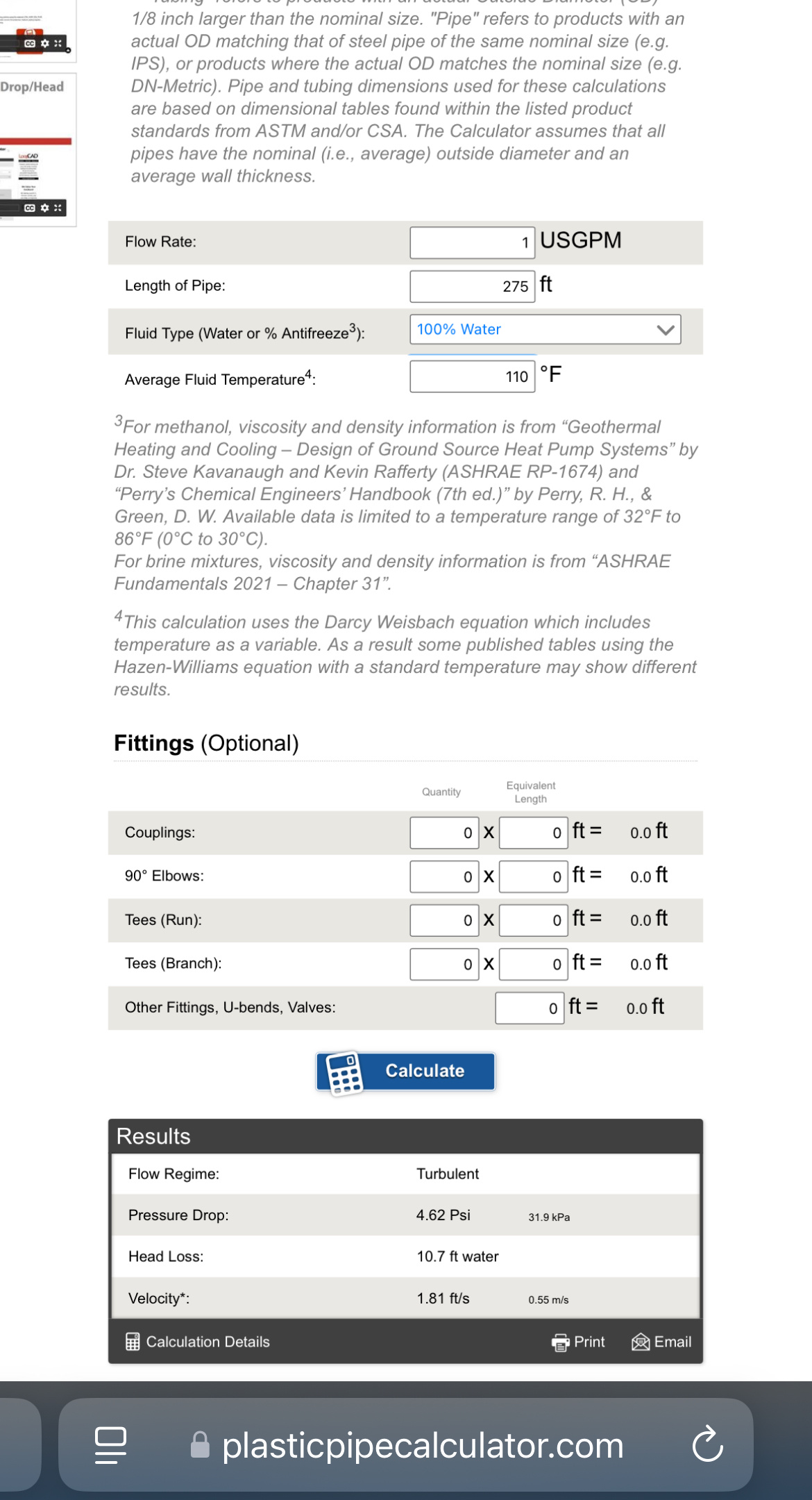

    If you have 275' loops of 1/2 pex tube here is the flow data at 1 gpm flow of 100° water

    A: you'll never get 1 GPM through a 275ft loop

    .65-.75 gpm per loop is realistic
    Here is what 1 gpm would look like in a 1/2” , 275’’ loop. Its possible with the right pump, but you should not need to go yo 1 gpm
    .65 gpm per loop with 1/2@ tube 12” on center give you about 26 btu/ ft
