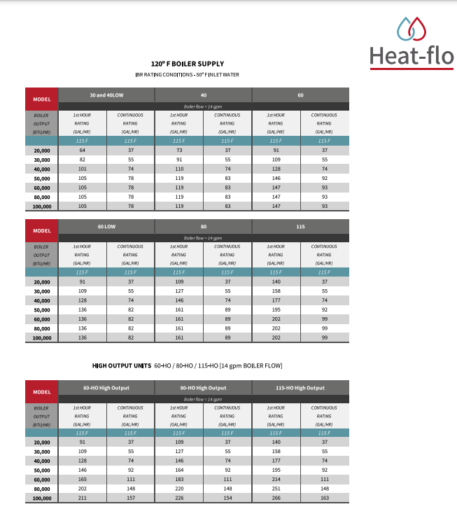

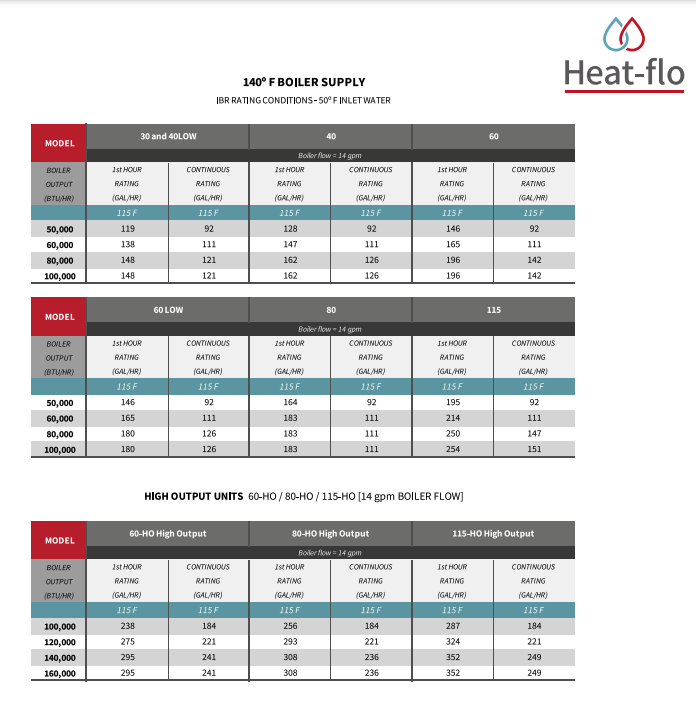

    hot_rod Member Posts: 28,076
    HeatFlo high performance, 100' of coil, tanks are shown down to 120 boiler supply temperature. Although 140 SWT should get the boiler condensing.
    If 180° frightens you :)

    That is incredible performance.
    The tank can perform just about the same with 150°F as it does with 180°F supply. It does fall off a bit at 140°F
