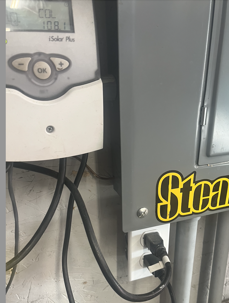

    Green light is on whenever it is powered up. It is not a "pump on" indicator. I just put a cord on mine and plug it into a receptacle. This allows easy service. Also I can connect a generator easily in a power outage. And the pump exercise function can be used over the summer if it is always powered.

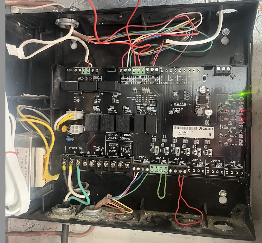

    This is 4 zone system. this is the wiring. Don't know if you can make it out. The directions for the wiring was simple I thought. I could have made a mistake.

    I was finally able to send the picture of the control. the phone numbers you sent earlier I will call if you can't give suggestions.
    hot_rod Posts: 28,831

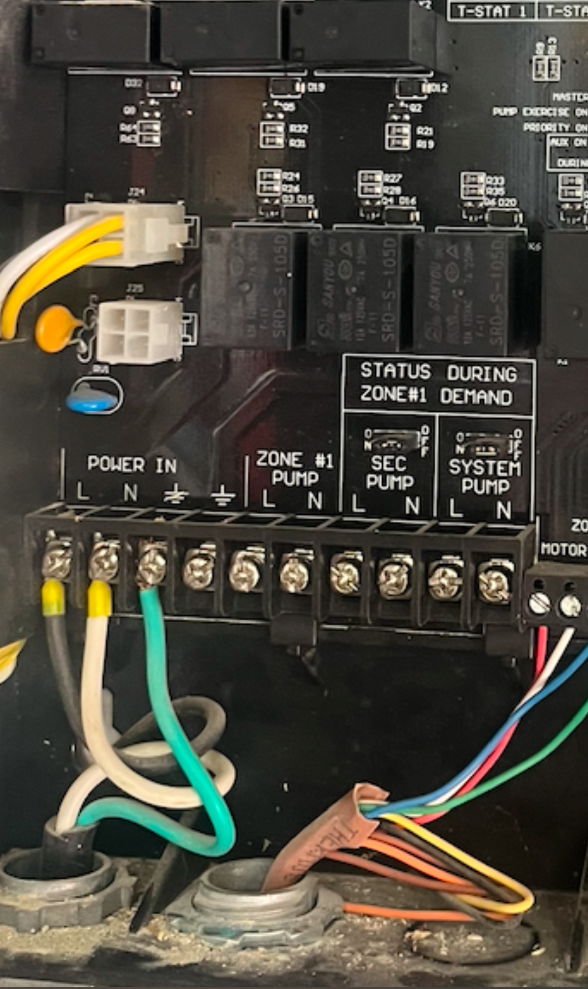

    gosh, the wiring looks fine. I can’t make out where you have the pins above the relays set?
    The boys in Milwaukee might have more current info. It looks like a Rev. 4 board, it should be current with upgrades.
  • cutter
    cutter Posts: 312
    The pins above the relays are set to on. I feel my mistake is the pump connections. The wood boiler pump that circulates the water until it gets hot enough to keep the controls powered up and the pump from shutting off and on is connected to system pump. The pump that supply's water to the zones is connected to zone #1 pump. That is the mistake, I think now it should be connected to the the secondary pump connections. I think then it would run whenever any zone called for heat. Does that make sense. or does it need a jumper connection from zone #1pump connection to secondary pump connection?
