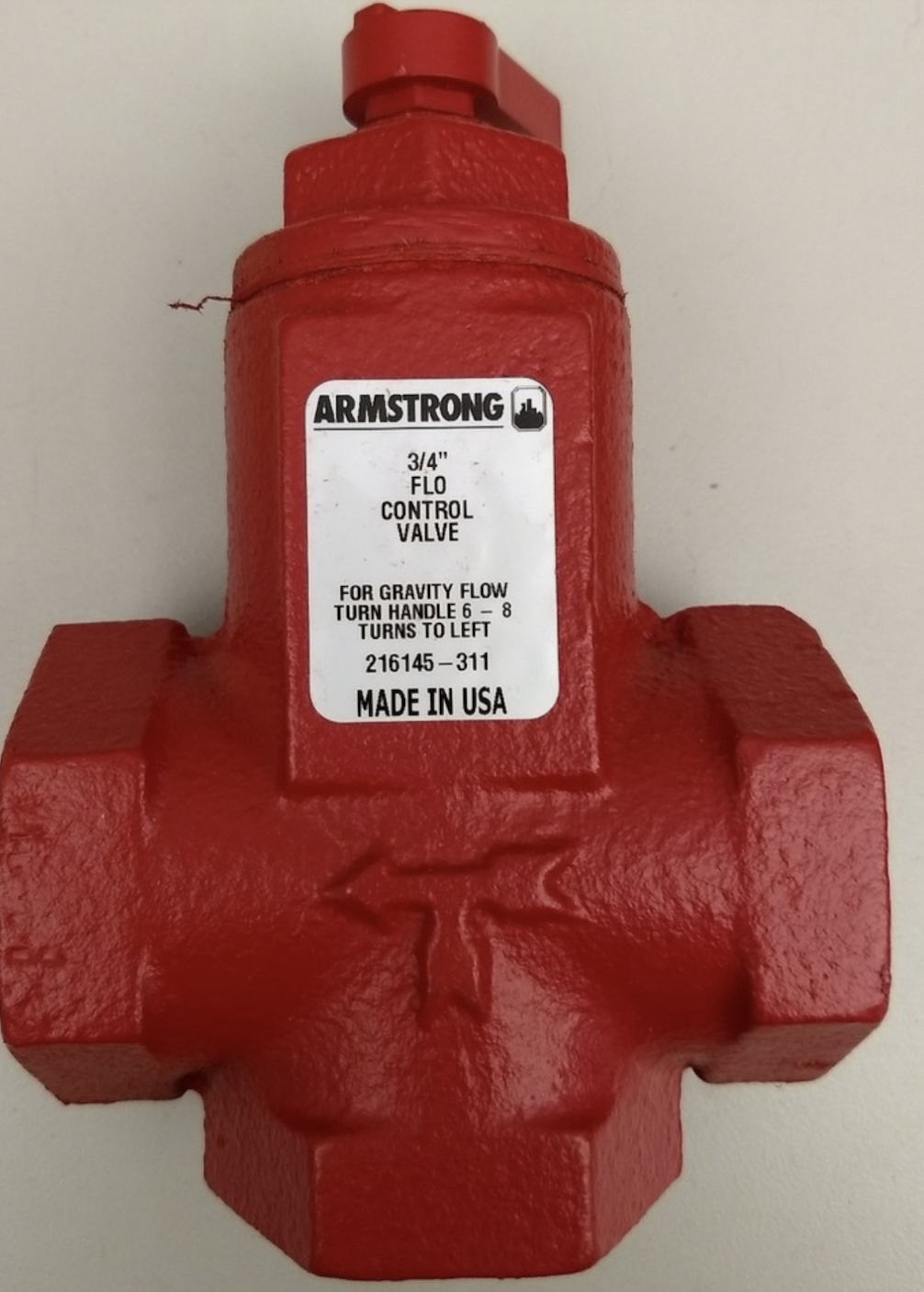

How does this flow control valve work in my monoflo system?
Hey guys, my 70 y/o monoflo system has what looks like a flow control device made by Armstrong.
Does anyone have a diagram of how this specific flow control device works?
Is this valve in an attic or crawl space?
It is a spring tensioned straight flow check valve.
Find the arrow in the casting and you will find the heated water flow direction.
The valves design allows the cartridge and valve seat to be removed in one piece and cleaned if needed. 😀

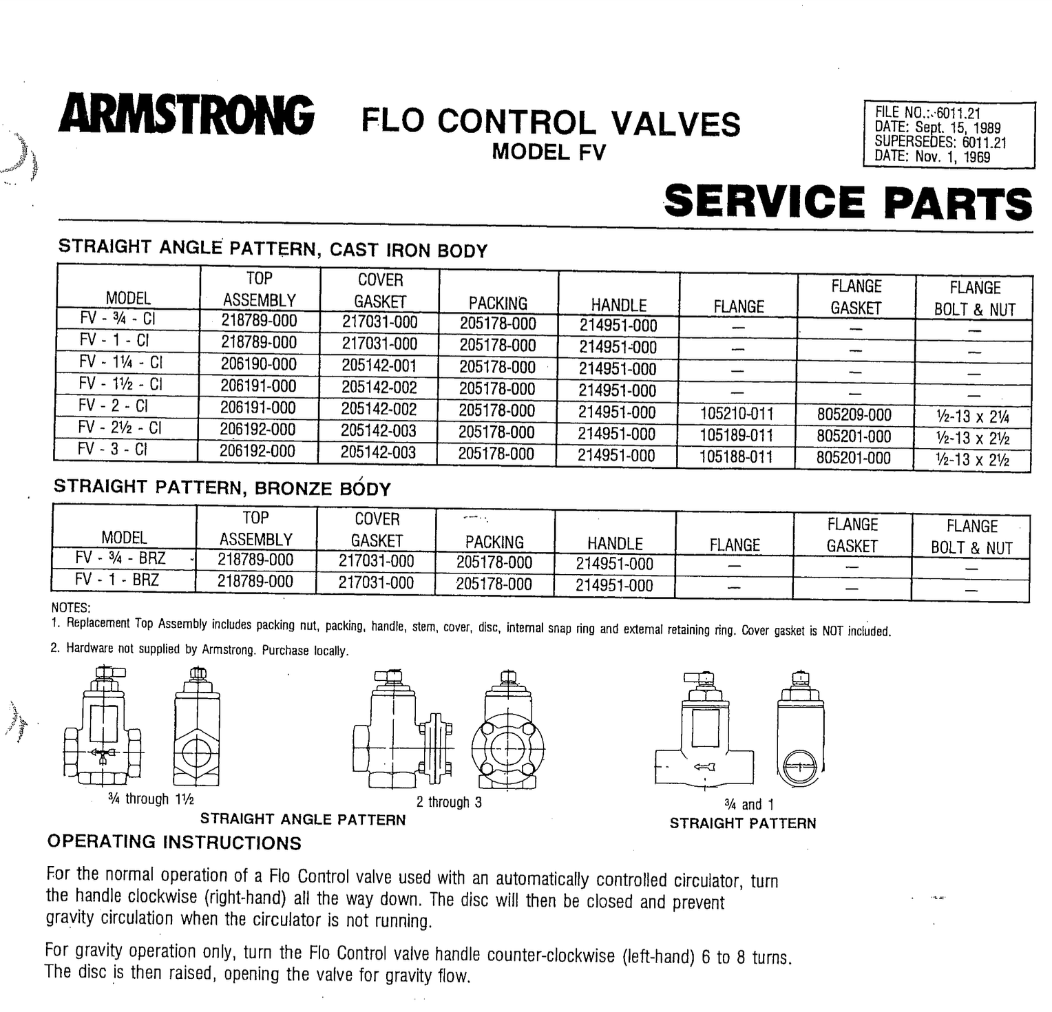

The screw on top should be turned clockwise in normal operation and turned counter clockwise for the open position

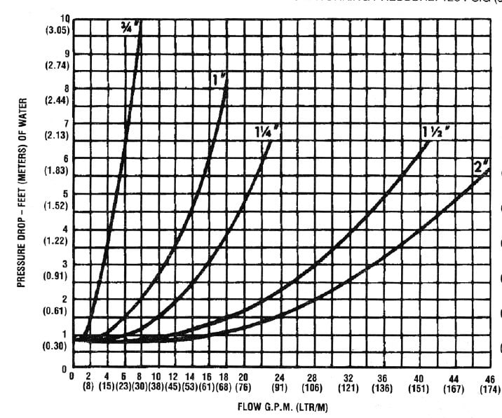

Below is what looks like a modern equivalent, and it looks like they are pretty restrictive.
If i don't need it maybe i should remove the internals to remove all of that unnecessary resistance.

There is no weight in this valve, it has a spring to maintain resistance to flow. With the valve closed and the handle turned all the way down there is resistance to flow directing to each heating loop.
If your that concerned with flow just open it fully by turning it counterclockwise to fully open it. You may well end up with very cold floors as the water will go where there is less resistance.
That is not how flow checks work. They are a weighted check valve. They only open when the pump runs and there is no spring. It is done by weight only.

Is there s number on it? if it is a 216145 model , I believe it does have a stainless spring inside
The B&G one shown above is a weighted plug type
Living the hydronic dream0 -
Good research Hot Rod! The two "red guys" do look similar on the outside.
No number unfortunately, kicking myself for not taking better pictures when the wall was open(this is between floors).
Armstrong 216145 is newer, no way to tell if design got changed.

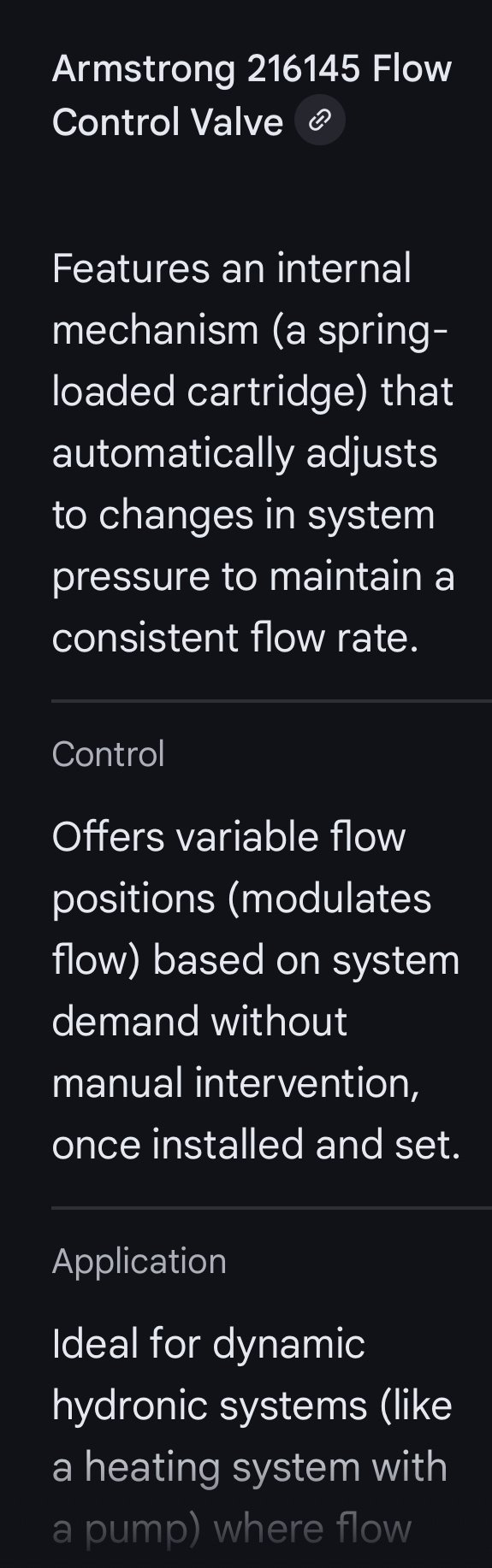

It's possible Armstrong built a weighted style like the B&G also, the FV series. I found a number of sources that claim the 216145 is a spring cartridge style? Only one way to know for sure.
The FV series dates back to 1969.
I see 216145 on E-bay and some wholesalers still, if you Google that part number..
In either case either type could bind or stick after years of service. Not much to the weighted style, I've never disassembled the spring/ cartridge type Armstrong.

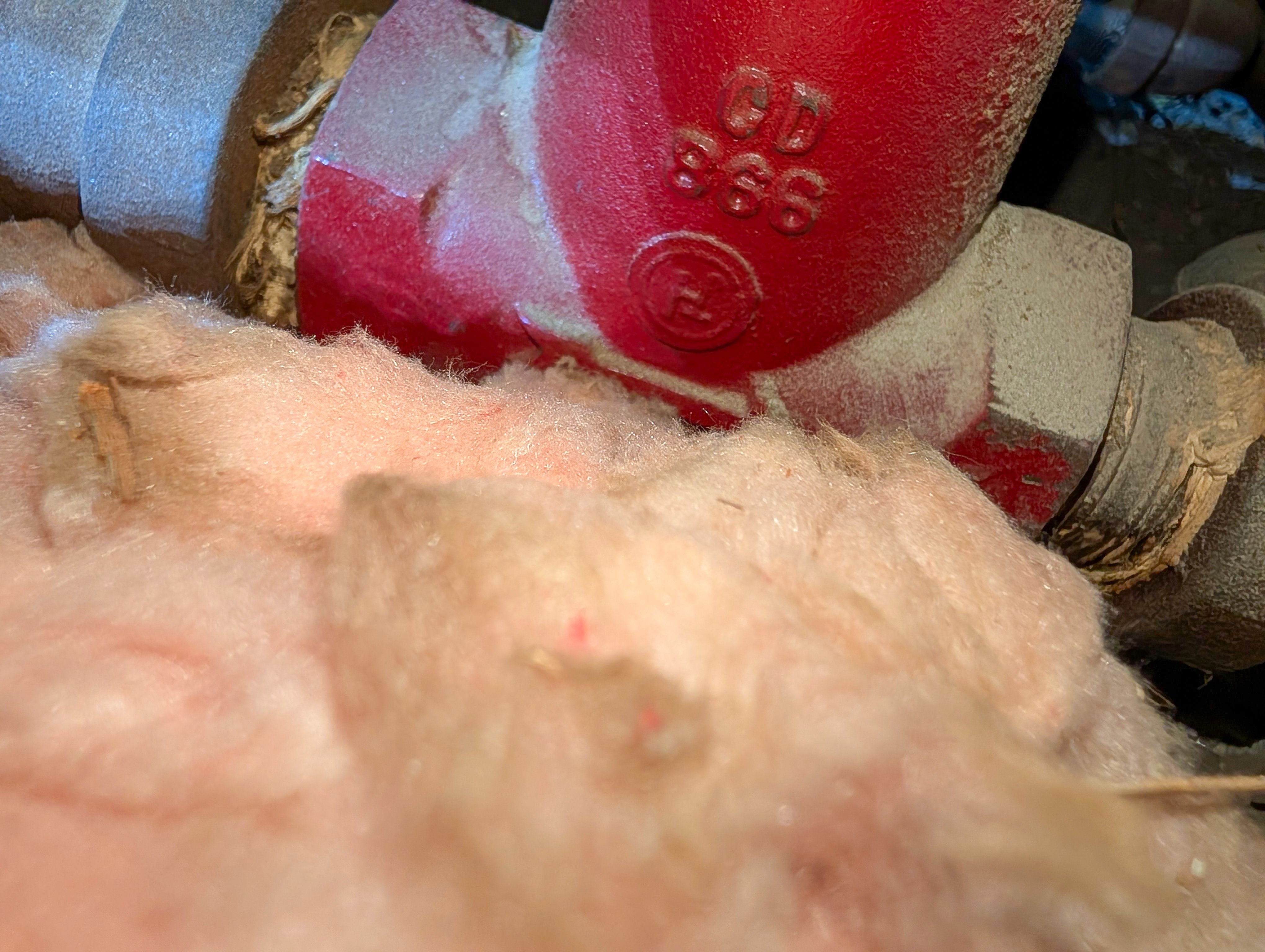

The label may be on the back side of the one you show?
The things i do for heating…
There is a bathroom fan there, i took it out to snap a picture of the back.
It says "CD 866" whatever that means. The building was built in 1958, it looks original.

That's not a typical Flo valve. Its 180° in and out. No bottom port.
Its location (in the ceiling between the first and second floors?), and its 2 pipes into 1 going in, and 1 pipe into 2 going out is something I've never seen before. It seems like a regulator more than a Flo valve. There must be something on this design somewhere. I don't want to bother the retired guy even though he's been up since 5 at least. I'm sure he knows.
