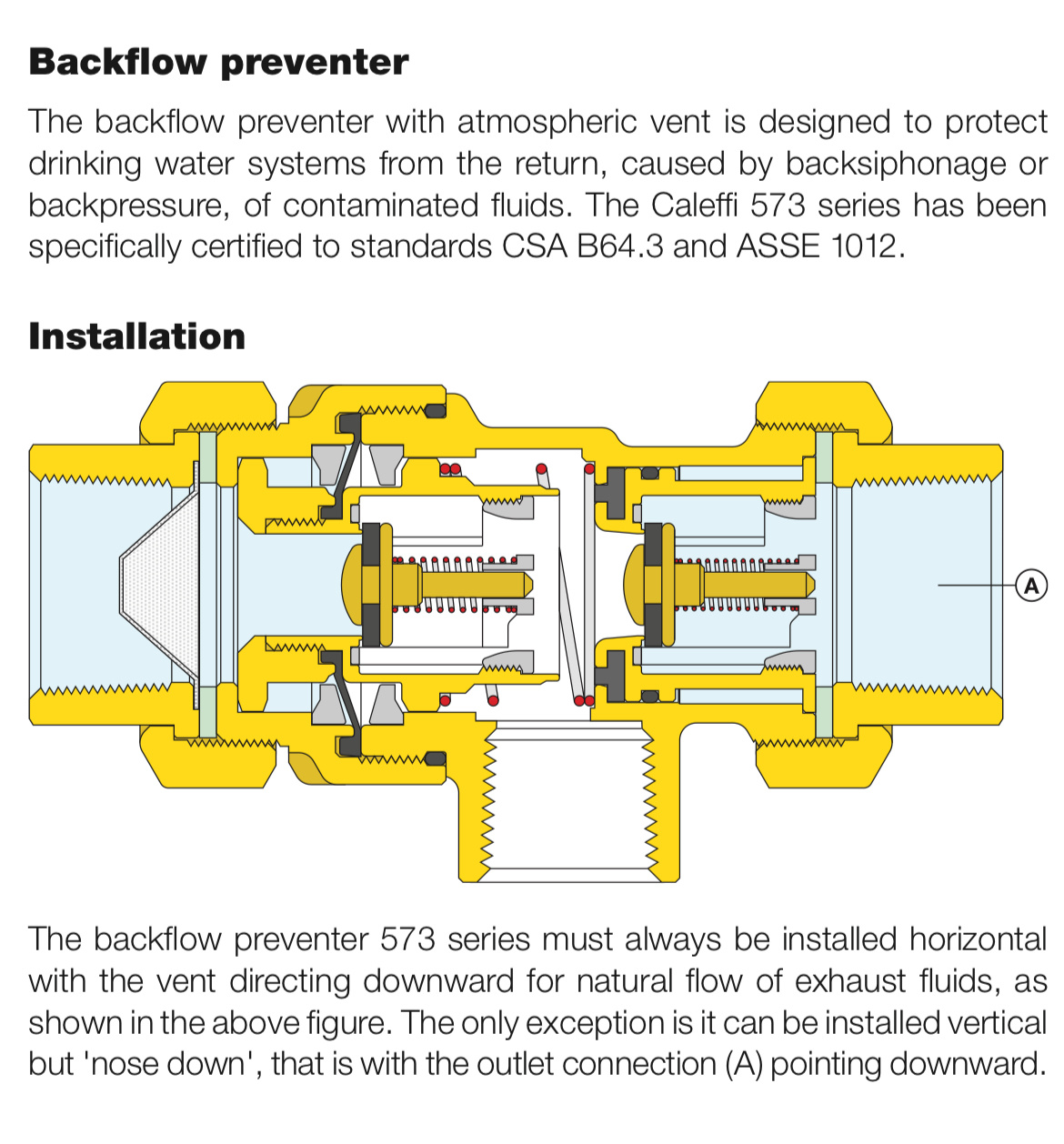

I installed this LF007M3-QT 3/4 to feed my new boiler. It is leaking a steady drip through the center port. Is it defective? Or have I done something to make it cry?
    hot_rod Posts: 28,848
    you have a piece of dirt solder, teflon , something stuck inside
    Water enters from the left side the pressure pushes an inner spool against a washer or o ring see the t shape cut away of an o ring? The end of the brass spool contacts that
    This closes off the bottom port , If water drips right away, something is lodged in that seal.
    They are fairly easy to disassemble and clean out
    Should be a strainer on the inlet? That generally catches most any problems?
    This is a Caleffi, but they are all similar inside
  • I bet you're correct about the solder. Thanks @hot_rod

  • Thanks, @Joe Mattiello. @hot_rod was correct. I got it solved. Much appreciated.
