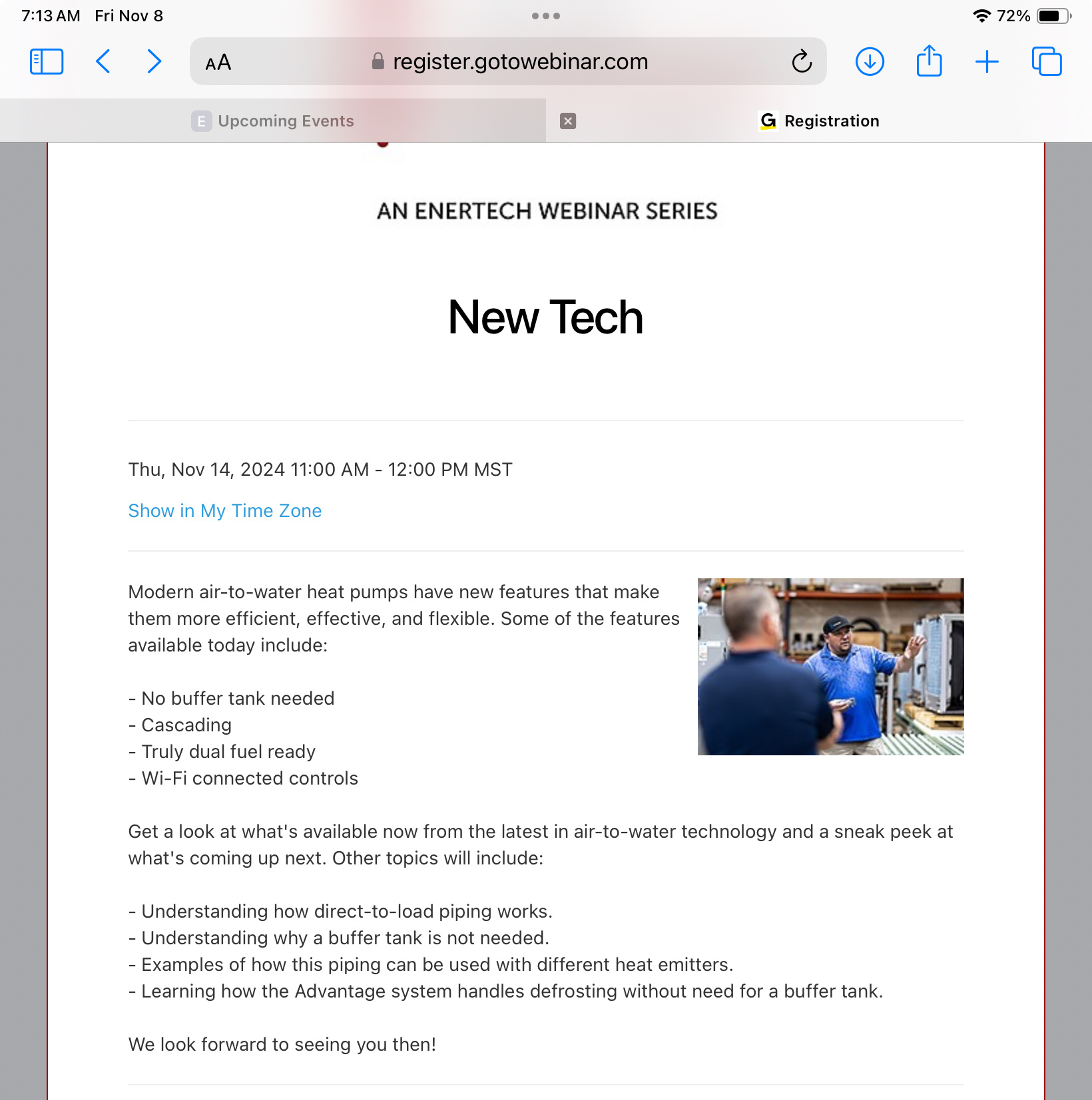

    PC7060
    hot_rod Posts: 28,864
    I’m interested in hearing how Entertech runs without a buffer. Ive heard claims of connecting to just a towel bar load?! Defrost pulls from the connected indirect. Unless you don’t have an indirect?
    Running a resistance element to defrost seems counter productive.
    Register for this seminar at the link.
