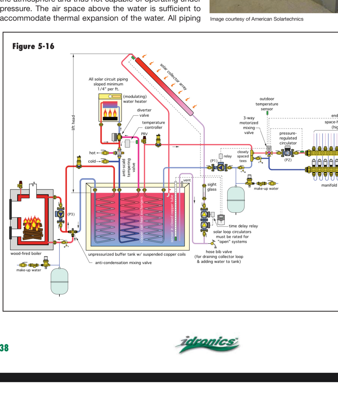

    so I’m just finished my open drain back solar heater and in commissioning found that my Grindr’s 15-58 doesn’t seem to prime, I do have the check valve installed so as not to lose prime once initially started the pump is about 22” above the water line and the top of the pane is about 8ft above the pump. Tank is 4ft deeps 14’ long 2ft wide. Suction on the far side from the pump and heated water dumps in next to the pump. I have air vents and vacuum breakers at the top. My half inch tubes run a pitched horizontal with 1” reverse return supply/return. The 15-58 say 19ft heads 10’ should be a problem, maybe not enough flow? 17 1.3” copper at 32ft long?

    Where is your drainback tank? You want that above the pump intake so there is always some water and pressure there when the pump needs to start up.

  • Hi, Been thinking about this, installing a check valve won't work, so as @Kaos essentially said, the inlet to the pump needs to be flooded. Is there a port lower down on the tank you can tie into… or can you drill and add a wall fitting? If not, taking the piping down over the side of the tank to the pump so it is under water level could work. That arrangement would need to be primed.

    hot_rod Posts: 28,769
    you don’t want any check valves in a drainback.
    The water level needs to be above the pump when it is drained back
    Ive never used a vacuum breaker on the many drainback I have built. The water will drain down when the pump stops.
    you don’t necessarily need a drainback tank if the piping and coils can hold all l the collector drainback water. At least below the freezing level
    This is how you typically get the pump below the water level in a coil in tank system, to give it some suction pressure some
    pressure
