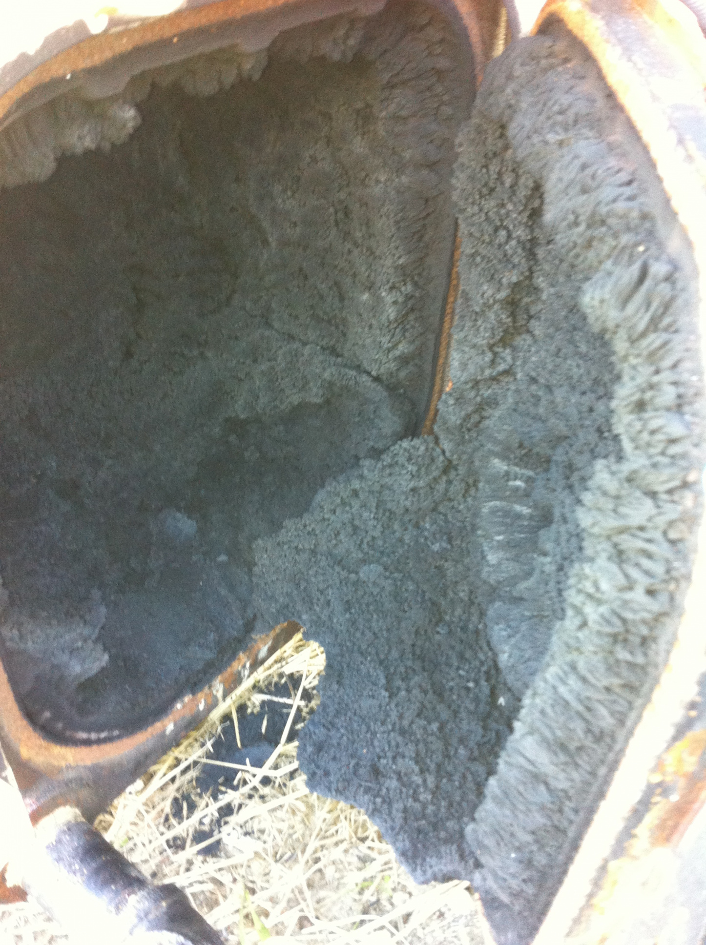

This, is a dirty Weil Mclain! I actually took the entire boiler outside and power washed it . Boiler was being moved, so it was easy enough to do. As you can see, it was still running. I wonder what its efficiency was? Rick

That blanket was cut waaaaay too long. It should stop right after the curves before it goes completely vertical.
Is the Beckett with the L1 head and a .85 45° B?
And of course the oil co was "servicing" it, right?
With regard to @HVACNUT 's question, if that's an L1 head and someone puts an 80° nozzle in it, you'll get soot like that.
That boiler had a partially blocked nozzle. I don't know how it kept running without tripping the cad cell, but it obviously ran quite a while. This was in its own room, and there was soot on everything from about 3 feet up. The floor was also pretty wet with oil, so had to remove the boiler and rebuild the room. That place was a mess

are you sure the cad cell works….
They used an 80° nozzle with an L1 head? Can't see the head from the pic.
Depends on which primary and the ohms reading. With all that soot a tighter fire in front of the air tube probably keeps the ohms low enough not to lockout the burner. Some of the newer primaries may not lock out to 5500 ohms or more.
