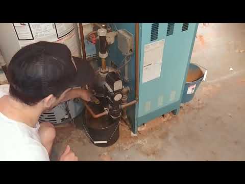

Hi my boiler control model 47-2 seems to work fine. But the water level appears to be very low (about 1") even after weekly release. The refill process just stops at the 1" mark. Please see picture. Should I worry? Is there something simple I can do e.g. may the float is bumping up against something? Many thanks in advance!
Sam

    There is a differential between water feed on and water feed off. You may have caught it just before feed on . The line on the side of the casting should be level to 1/3 of the glass / feed off...
    Flush the blow down valve on the LWCO every two weeks ...

    You understand that the 47-2 is a minimum water level safety control and not an operating water level control?
    It's designed to maintain the lowest safe water level.
    You are expected to fill the boiler manually to the normal operating level.

    BigEd_4 -- I do flush the blowdown valve religiously. Whenever I do, the level drops to zero and then immediately fills back up -- but only to 1.0" -1.2" Hence my conclusion that water flow in is fine but something is preventing "normal" fill which should be 3" or so?
    Long Beach Ed -- Yes, I realize the 47-2 is a low water *control*, but I did not know I need to manually fill to operating level. Any suggestions on how? I dont see any valves to open or keep open. I did watch this at the 4:51 mark should I try? https://www.youtube.com/watch?v=ZyRpiKf2p58

    Yes of course. Here they are -- the only water inlet and outlet are marked by arrows I don see *any* other ingress or egress (except the yellow handle on the 47-20
    I did get a 1/4" increase using the hack at 4:51 in this video
    https://youtube.com/watch?v=ZyRpiKf2p58

    So that is one way of doing it. Otherwise you could add water with a garden hose connected to the faucet pointed to by the red arrow.
    Otherwise, for a permanent setup, plumb a bypass with a good quality valve between entry and exit of the 47-20. Good quality valve because even a little a leak would cause an overflow of the boiler.
