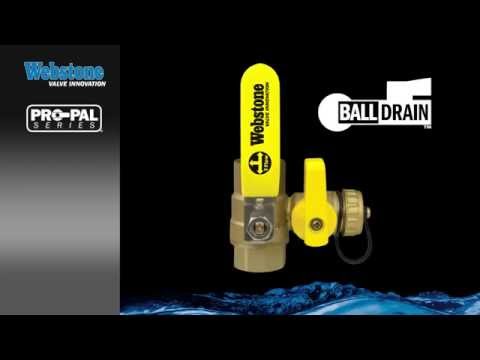

I have a bunch of Webstone H-50613 ball valves with boiler drains.
I understand the main ball valve part of it (opens and closed flow between the two ports of the valve).
My confusion starts with the boiler drain port. There is a valve on the boiler drain port (so that's clear).
What I don't understand is the interaction between the two valves. That is, if the main ball valve is closed and the boiler drain valve is open, what is the origin of the liquid flowing out from the drain port? Does the fluid come from one or both of the main ports (if only one, which one)?
Likewise, if the main ball valve is open and the boiler drain valve is open, what is the source of the liquid?

Some valve can drain in either position so say you wanted to purge only one side of the valve this would enable you to do so with out have another tee and drain valve on the other side . I can see that in some setting it could be confusing trying to figure out which side is being drained . When I use these types of valves I set it up that the handle will drain the side which I know will need to be either drained or flushed from and in changing the handle position it will drain the opposite piping. Hope this helps .

look inside the valve and turn the handle to see what is happening in different positions. now look at the picture on the handle to see the flow directions. it should all make sense. you can also remove the handle and turn the ball so it will purge from the opposite direction. that is why there is a sticker included with the valve.1
I use these valves often for expansion tank isolation. In the event that the tank fails, one can close the main handle and isolate the tank from the system. Then a hose can be hooked to the drain to relieve most if not all of the pressure in the tank to minimize spillage. I've used them for other applications as well, but I've always got a handful of them on the truck. Great idea on Webstone's part, IMO.1

I see the subject has been very well covered by my fellow readers. if you're looking at a valve that is already installed.. I believe webstone has always stamped a T or an L ( Depending on the valve) at the top of the ball valve stem to indicate which way the holes are facing in the ball.0
