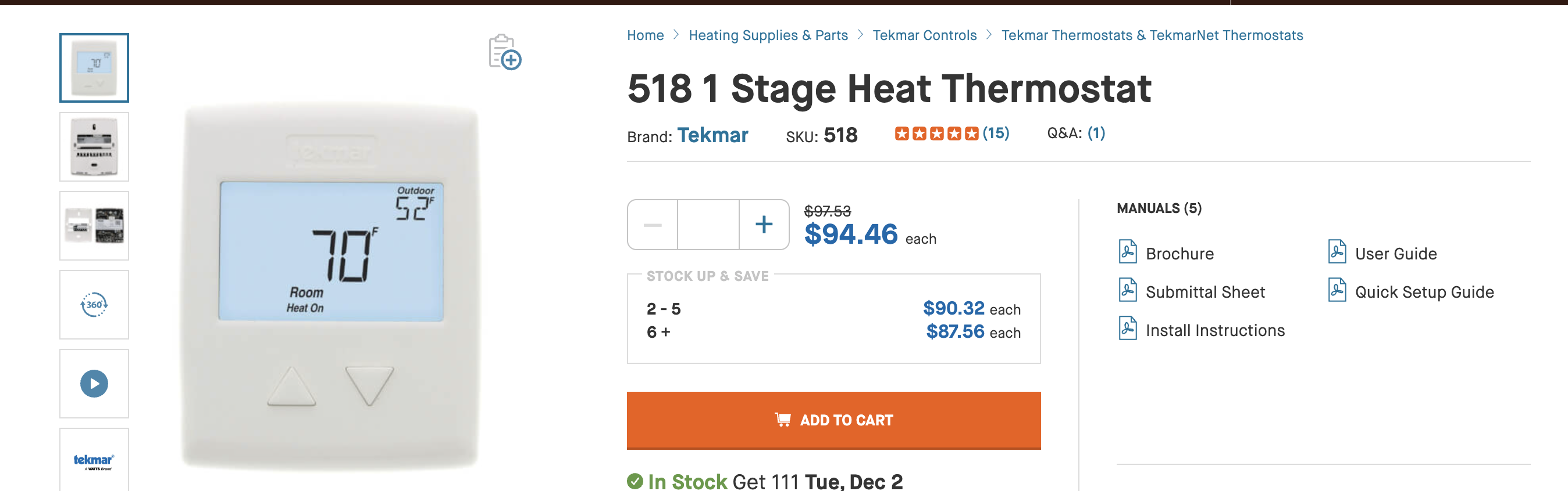

    hot_rod Posts: 28,705
    If you have rooms with high solar gains, this was very common with homes in Colorado with large south facing glass, then floor sensors may be a nice option for another level of control.
    I've been in those large glass walled homes with AC running in 1/2 of the house, heat in the north side!
    This was my go to basic air/slab stat, it is sold under various radiant brands. No programming or setback schedules to tempt homeowners. Just let radiant systems run at a comfortable temperature.
    Another option is all the stats are mounted by the boiler with just sensors in the rooms. If you don't want to see wall stats throughout the home.
    Ideally you get the system adjusted to a comfort level where you don't need to look at the temperature on the t-stat to know you are comfortable :)
